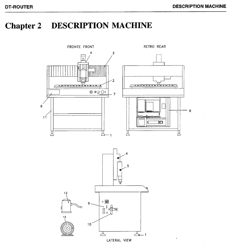

I recently purchased this old machine. It in really good condition and was well maintained. Yet it came with no user manual or anything. I have installed the 10.04 ubuntu with EMC2 pack on with purpose to operate this machine. However i found myself unable to make it work, especially that the CNC router can be only connected with COM1 port.
Does anyone familiar with this router or a way to operate it via COM1 port with EMC2 ? Am i asking too much? Or is it a lost battle i am getting in?

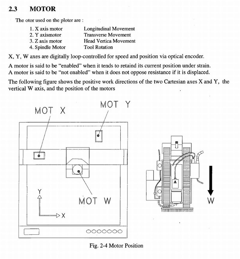

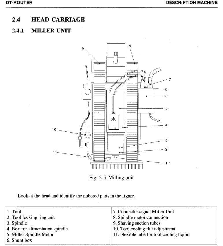

Replied by BigJohnT on topic Re:Help needed! SEI DT router 650.
You would need the original control program to run that machine through the serial port. It sounds like a "smart" controller ie a controller that handles the motion calculations. This type of controller requires usually a proprietary program to control it.
EMC only works with dumb drives ie drives that take step and direction or velocity/torque with position feedback as the motion calculations are done in EMC.
Does the machine have DC servos? Do you have a photo of the machine and drives?
John

22 Feb 2011 19:12 - 22 Feb 2011 19:16 #7384
by Borideleon
Replied by Borideleon on topic Re:Help needed! SEI DT router 650.
Last edit: 22 Feb 2011 19:16 by Borideleon.
- Borideleon
- Posts: 20
22 Feb 2011 19:18 - 22 Feb 2011 19:21 #7385
by Borideleon
Last edit: 22 Feb 2011 19:21 by Borideleon.
