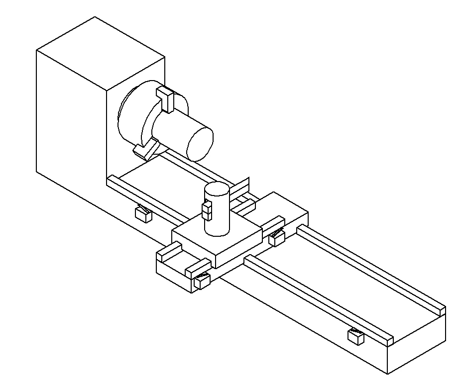

Looking good... I can't tell but it looks like your limit switch is mounted so that in case of over travel it might be damaged.
In this photo of an over simplified lathe set up you can see that the carriage can travel to the limits without damaging the switch.
John

Yes they are positioned where if an overtravel ocurred then the switch could / would be damaged. I figured that 1) the hard limit would prevent the over-travel, and 2) the Soft limits would prevent the travel reaching the limit switch. and with these two conditions in place that the possiblity of crashing into my limit switches would be extreamly slim.... I can look into re-mounting as you showed in your example, as it would be a better way of doing the same funtion...
Regards,
Will
27 Jul 2011 20:14 #11931 by BigJohnT
Replied by BigJohnT on topic Re:My cnc minilathe
I just mentioned it as all the few machines I've seen are set up so the limit switch will stop the machine traveling at a rapid rate before it reaches the hard stop, which sometimes means going over the switch some as it slows to a stop. If your talking a stepper machine with little power and the hard limit stops it before damage is done to the switch your risk is lower.
