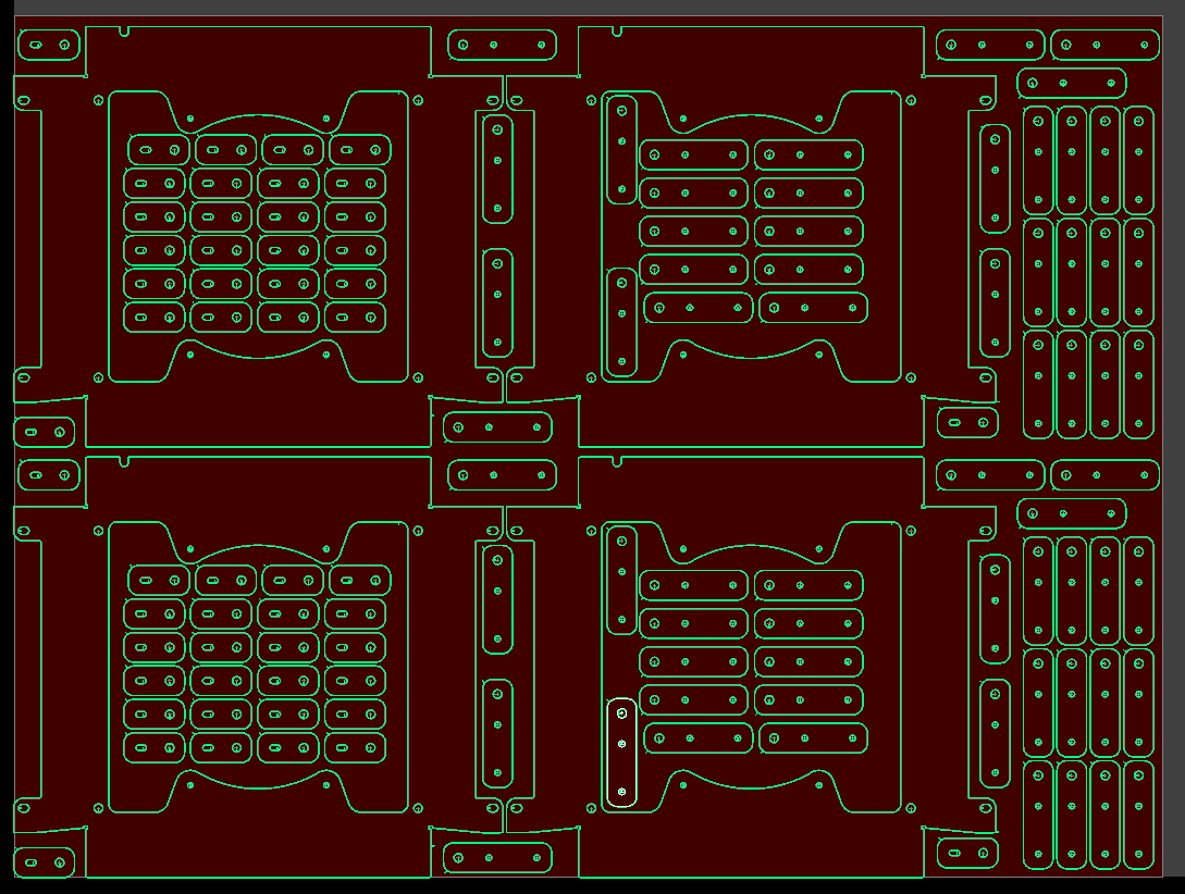

I'm nearing the end of my first CNC router build. During this time I've been playing around with Fussin360 (hobby license).
My router is 4x4ft. and my need is to process 4x8ft. What 360 is missing is a tile feature.
Does anyone know how to tile in Fussion360? Or is there a better freeware or inexpensive package that works nicely with LinuxCNC?

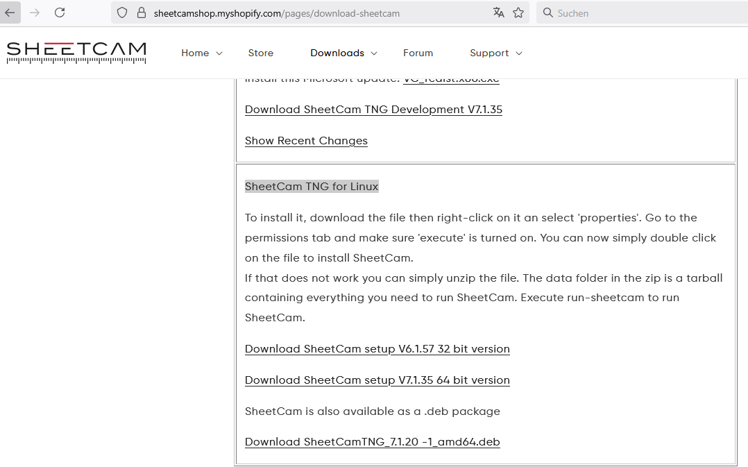

- fernandosf
- Posts: 69
- Thank you received: 17
10 Jul 2025 16:16 - 10 Jul 2025 16:17 #331668
by fernandosf
Replied by fernandosf on topic Free CAM with Tile Feature
That is an amazing list! Just wondering, have you updated it recently ?
I had a version of Sheetcam that could run on Linux without limitations (free version) but I have lost it and could not find it for download anywhere. Any clues on this ?
