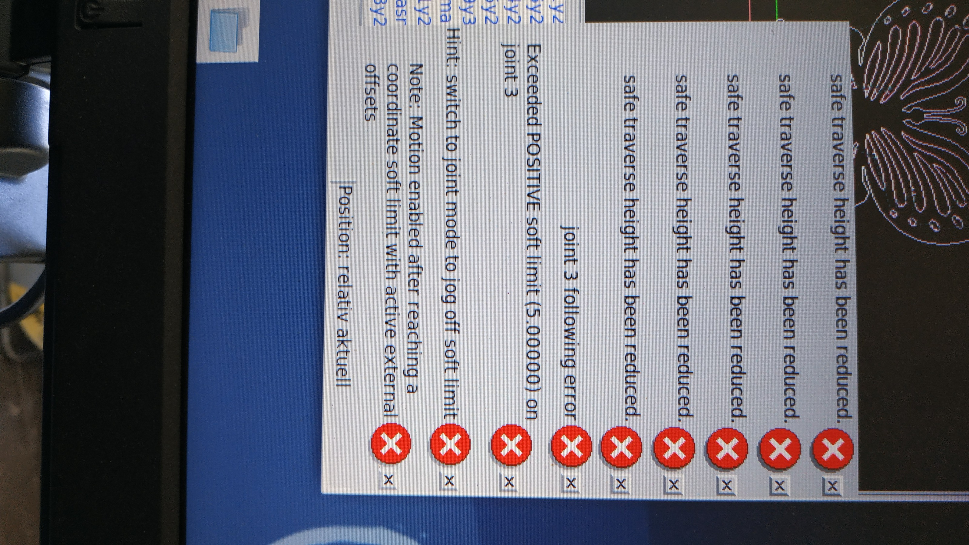

ok thank you. in the meantime i bought sheetcam.
i load a dxf into it and make teh gcode. I used the postprocessor
LinuxCNC PlasmaC Ver. 0.2 that comes with sheetcam.
It starts well in linuxcnc the cutting process stoped after a few time with this errors.
sea picture attached.
Whats the problem?
at the moment every path the toarch makes a touch off. can i reduce this only at the start of the whole project only one time?
Whats the problem?

hmm, i think i know the problem. Maybe the metall bend more and more.
so that the z axis move avery time a bit higher.
