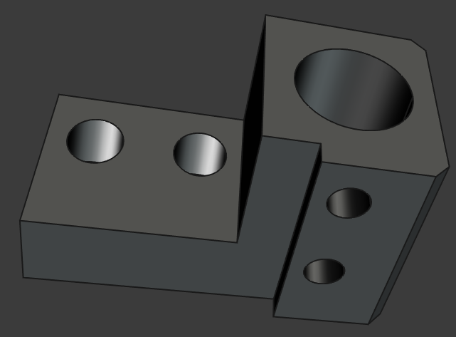

Love FreeCAD, apart from one little annoying issue.
Used the CAM for making the brackets and nubbins for the Franken Myford CNC conversion. It's my Goto for anything I need to 3D print, even used to help my son with some prototyping ideas when he was doing the additive manufacturing module at Uni.
