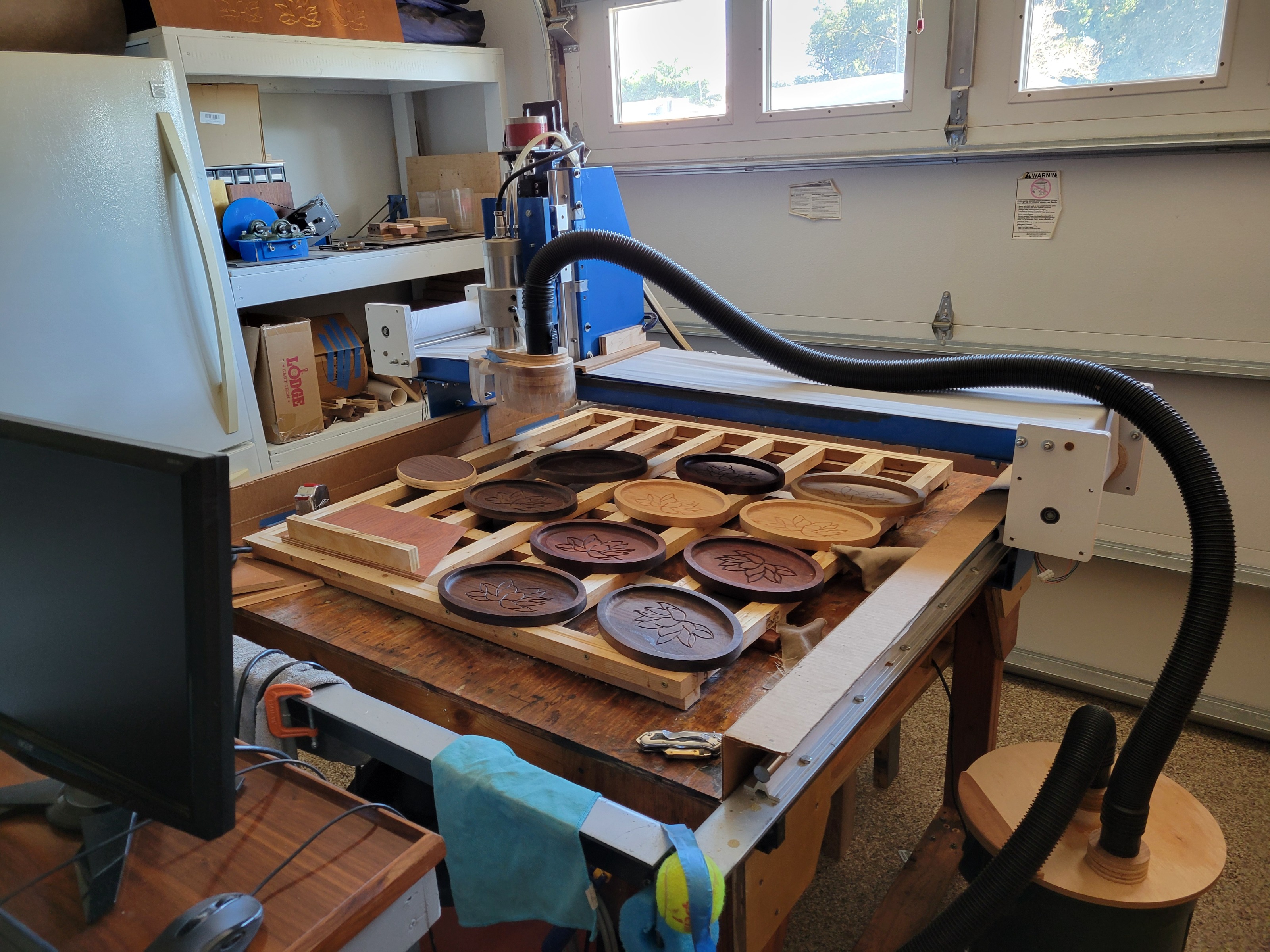

Interesting conversion synching to an analog signal have never done that. Very nice build. I've attached a picture of my monster build 4' x 4' 6 inch Z.
