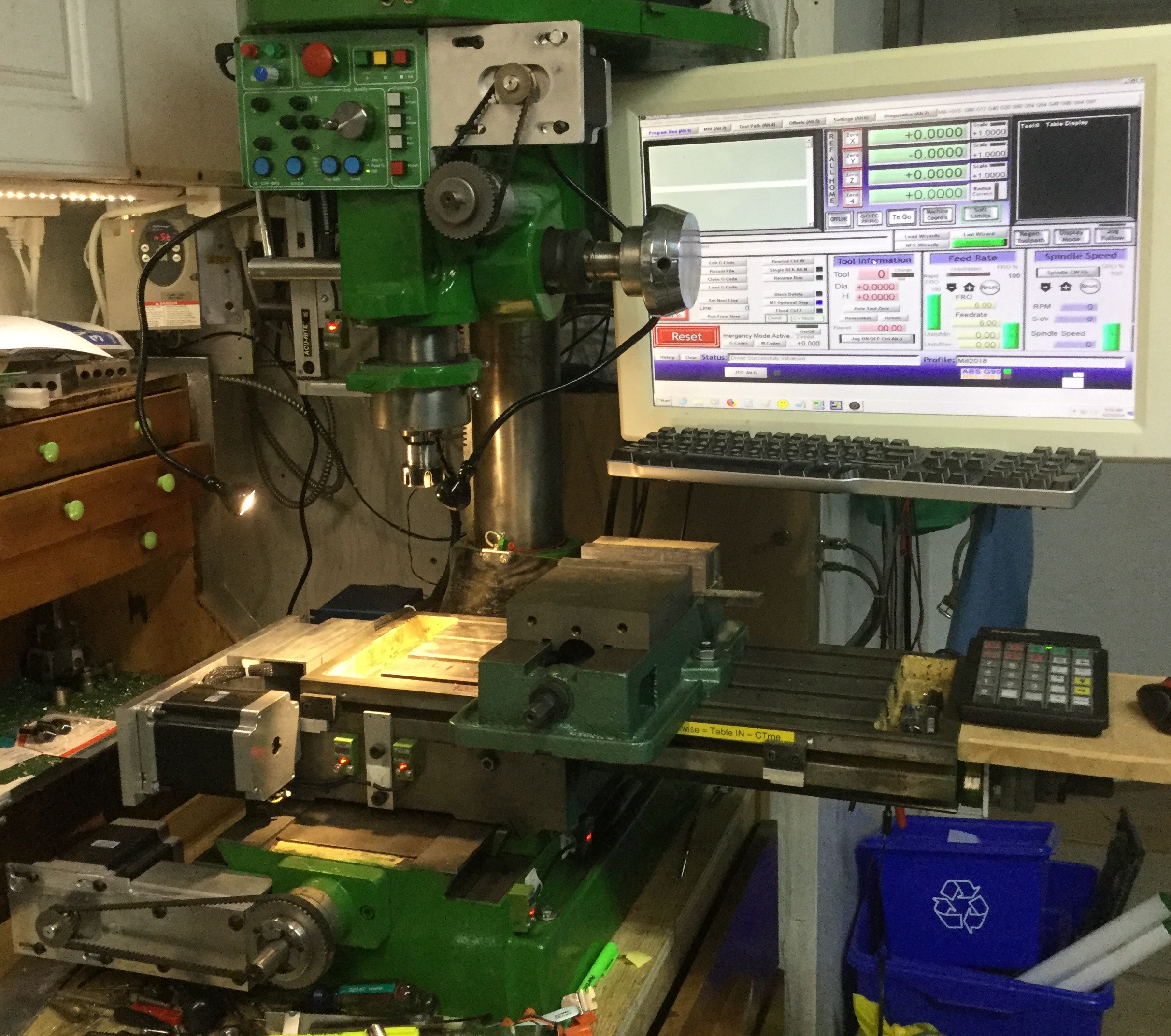

Hi,First post, I have zero experience with LinuxCNC, I came hear to get educated.I previously did a CNC conversion of an old round column mill using steppers and Mach3 (about 10 years ago). I'm an electrical engineer by training so hopefully that will help.I have a new 8x30 knee mill and I want to try LinuxCNC this time I have near zero direct experience with Linux. To be clear this is for hobby use so I would like to use low cost components wherever I can get away with it, I won't be making NASA type stuff just hobby stuff so if the machine approaches 0.001" repeatability I will be very happy. I'm swapping in ballscrews at this time.System as I envision:
Hopefully someone can answer my preliminary questions:
1) For a CPU board, what is powerfull enough? I have a RPi, not sure if that is even close to powerfull enough. I also have more of a PC type SBC EPIA Nano-ITX not sure if it can run Linux? Suggestions for a suitable CPU board please?
2) I can randomly start reading posts, however if there is a starting from zero tutorial somewhere, please provide a link and hopefully I can come back less clueless with more focused questions?
3) What version of Linux should I be loading on the CPU board? is it free?
4) Suggestions for required break out board, someone suggested Mesa 7196S, not sure if there is better or cheaper. I'm all ears?Image of my old custom control panel that I made for my RC mill quite some time ago.Thanks in advance

Download the ISO from the download page, write it to a USB stick, see what boots from it and run some latency tests without the base thread. That is how you decide what PC to use since you have several.
As for Mesa, i have no affiliation with them, but having used a lot (probably over 80?100?), i gladly advise to go for it, they are extremely reliable and have the best support on planet earth!
7i96S should do fine, and it can be extended/expanded a lot at any point in time if you need it to.
As for reading posts, get the ISO, boot from USB and test, everything works from a Live boot (without installing it) so you can get a feel for it and have a look at different GUI's included with LinuxCNC.
