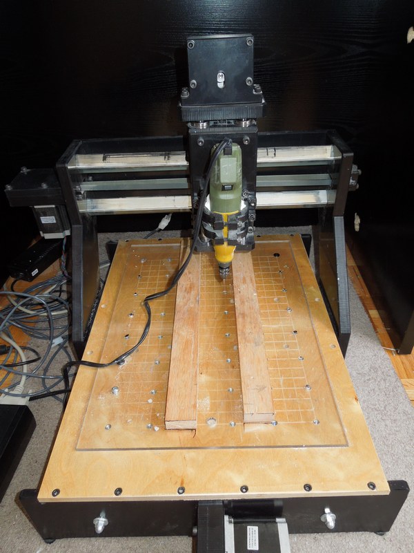

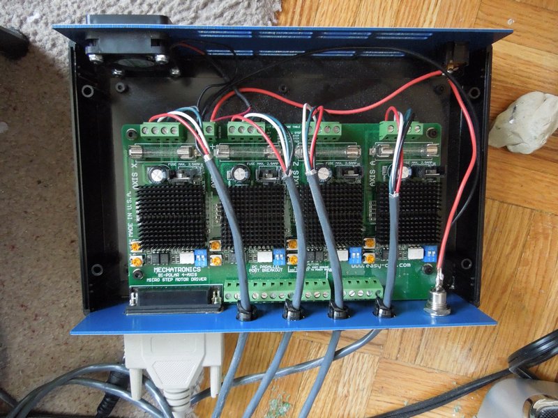

27 Jun 2013 00:22 #36097
by Nenad
Replied by Nenad on topic turning a 3-axis machine into a 5-axis
Here are the pictures of my machine. The current box I am using actually supports 4 axes but I don't use the 4th one. The controller board is made by www.easy-cnc.com
and it works great. I purchased it with the Zenbot cnc that I have (zenbotcnc.com). It also works great.
We'll see what the maker of the board says. They currently have no 5 axis boards on their website.
This is the 4th and 5th axis that I am adding:
www.wtotoy.com/4th-and-5th-axis-cnc-rota...ining-router-en.html
The hardest material that I carve is wood, so I don't think there would be any problems with the additional axes in terms of strenght and durability.

I see. What I meant was "I only know how to use the wizard". Will try to figure out the ini files. Ideally the same maker who made my current boards should send me the upgraded version. I just posted the pictures.
