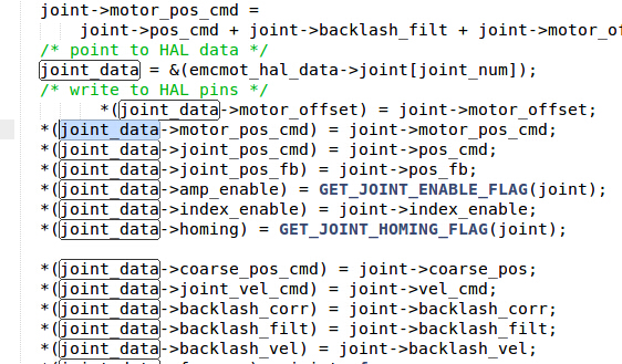

I tried send the data - joint_data by sockets
joint_data was used in control.c
it seemed that joint_data couldn't be used directly by
include "motion.h"
include "mot_priv.h"
how could I get it and use it in sockets.c??
thank you all!!!

Hi
joint_data is of a typedef struct hal_joint_t, which is local to the emcmotController.
It is purely local to that process, if you look at the objects produced by compilation, there is not even a control.o, it is already assimilated into another object.
Most of the data you want is available in HAL pins www.linuxcnc.org/docs/devel/html/man/man9/axis.9.html for example
Again it is a case of partial information can only illicit partial response.
If you share what it is you want to do, rather than asking how the method you have chosen can be made to work, without any overview of any of the other factors, you will get a better response and the answer may not be the one you thought of.
This is an open-source project, nothing you take from it can be claimed as copyright , so there is no need to be secretive about your own code, whilst happily taking whatever you want from the sources.
regards

I just don't know how to describe my question rather than other reasons;
what I want to do is just want to send the position and velocity of joints to windows by sockets(DCP/IP); I need this data in windows
but I don't know how to send the HAL pin data to windows by sockets; HAL pin data how could be used as a varioble parameters in .cc file? I have no idea....
so I decided to send the data form source code, and it's failed.
If someone have any idea get the datas by HAL, I think that's best;
sorry I have so many stupid question, I just couldn't handle all this file.

You can do that with a userspace HAL component. A userspace component can create pins which you can connect in HAL to the corresponding axis.N pins, and has access to all (?) userspace stuff such as the socket API. I wrote my first HAL-component last week, and I found it pretty simple even for a not-so-experienced programmer like myself.
See the 'comp' documentation for some more information.
So basically you write a component:
component datatowindows;
option userspace;
pin in float xaxis_pos;
pin in float xaxis_vel;
void userinit(argc,argv) {
ParseOptions (argc, argv);
SetupTCPLink();
void user_mainloop(void) {
while(1) {
FOR_ALL_INSTS() {
AsssemblePacket (&ourpacket, xaxis_pos, xaxis_vel, ...);
TransmitOverSocket (&ourpacket);
Then, in HAL;
loadusr -W datatowindows --destination=mywindowsmachine.lan:12345
net xpos axis.0.joint-pos-cmd => datatowindows.0.xaxis-pos
net ypos axis.1.joint-pos-cmd => datatowindows.0.yaxis-pos

09 Jul 2014 19:16 #48579 by ArcEye
Replied by ArcEye on topic how to get the data from control.c
I must use the position and velocity of joints in c file;
so , any methods could help me get the data?
the data in HAL, I still could use it in C file?
I see DaBit has given you some ideas.
A component IS a C file, it is just written within a macro for ease of use, this is expanded to give the HAL aware code required, without the user needing to specifically write it.
You just need to create the pins to receive the data you want and connect them in a hal file to the pins which carry the data within linuxcnc.
Just as DaBit showed you net signalname yourcomponent.yourpinname <= axis.N.whateverpinyouarewanting
Then your component can disseminate this info however you want.
As he says this needs to be userpace if you are going to be using sockets, serial ports etc etc with the existing code methods available.
There is a proper way to get pin values programmatically, but this relies upon getting and releasing the rtapi_mutex, which limits it to realtime components and is not something you want to be doing repeatedly.
regards
