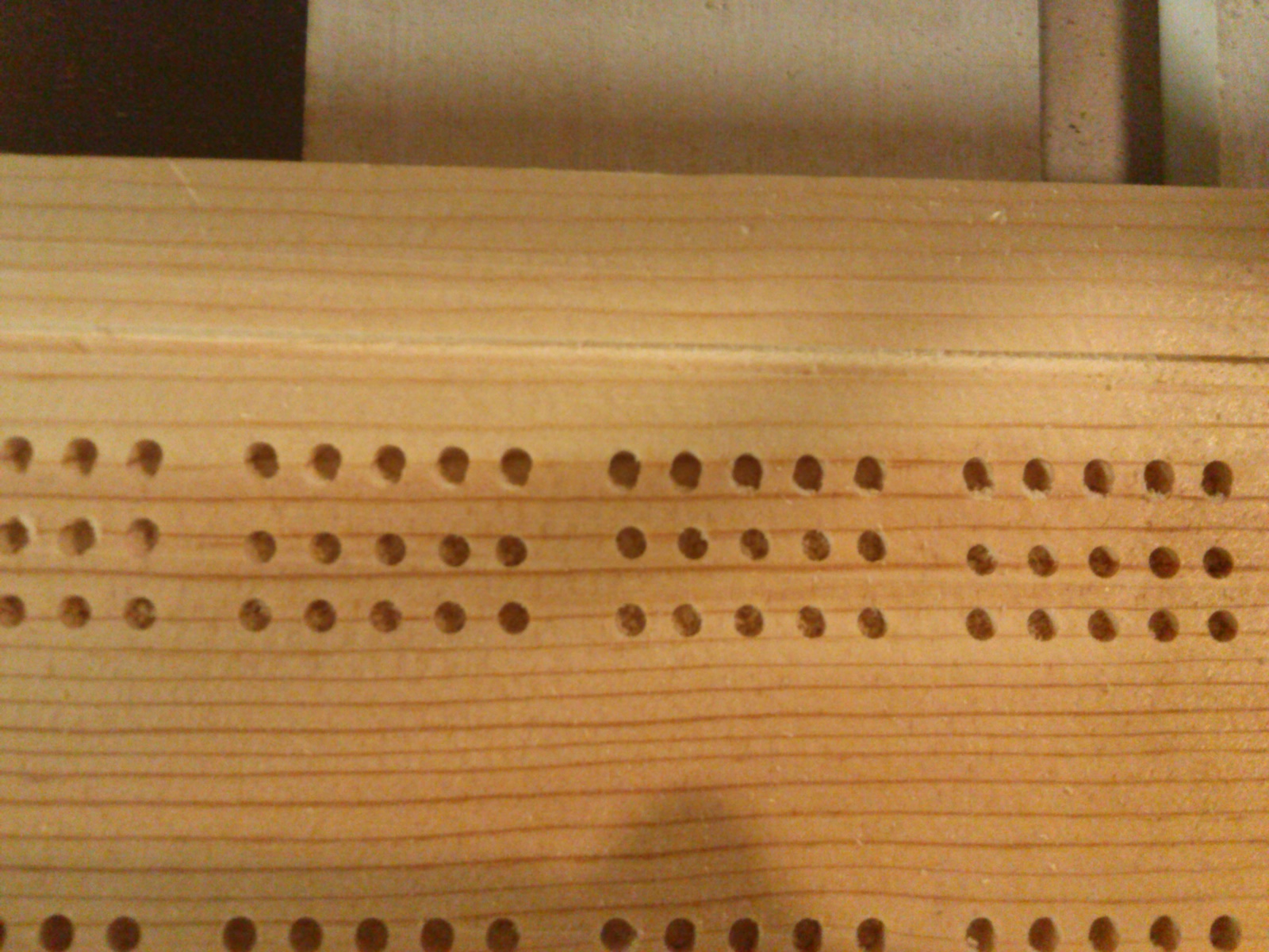

I was drilling a test for a 3 person cribbage board when suddenly, the middle track does not keep an even path.
In the image below the Y axis travels Left to Right and X axis travels Top to Bottom.
I checked the GCode and the X Axis numbers are identical along the path, yet as you can see they are not lining up. It is my thought that the machine isn't stopping at the right spot.
Sound legit? (I'm asking for validation before I start to mess with the Acceleration and stuff in the Config file)
Thanx~!

I would also check for mechanical play (backlash) eg couplings and lead screw nut.

The holes look to not be very round either, it might well be a mechanical problem.
Grab the spindle and try to shake it, see what moves.

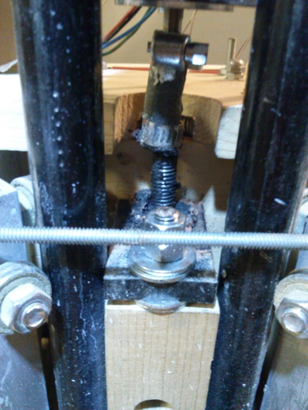

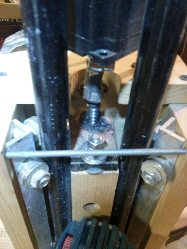

I don't take very good photos with my cell phone but here they are....
The top of this photo has the stepper-motor. As you can see its shaft is clamped with a hose, which is on a threaded rod which goes through a T-nut that I have screwed into a plastic brace. The brace extends to the router chassis, which I have locked into place with 4 washers and two nuts on a threaded rod that is drilled into the wooden spacer between the two pipes.
This photo is a closer view (with solution)
I noticed as the Z motor turns, the threaded rod is slightly off-set causing the plastic bridge to slightly 'jiggle' in a circular motion. Originally I had the wooden spacer, one washer, plastic bridge, washer two nuts - and I snugged them down tightly. What I did was add one washer to each side of the plastic, and when I snugged the nuts back down, I did it so the plastic bridge had barely enough play to move on its own without effecting the chassis the router was attached to.
Initial testing shows that it seems to work well; no spiral descent and ascent from the router. Next up = I will re-load that cribbage board program and see how it looks...
Thanx~!
