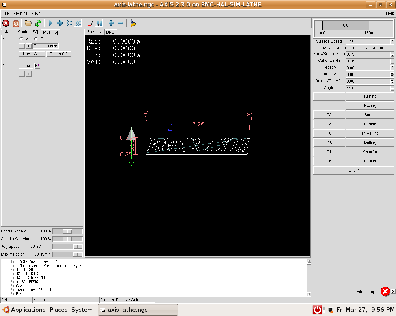

I have added the lathe macro to my config. It will run tool change, but when the 0call commands give me "file not open". I am using v2.3.0 & have read that many updates were made to MDI 0-call in v2.5 . Any help would be appreciated.

I have run this config on my mill computer using 10.04 live cd & will 0 –call. When I try the 10.04 cd on the lathe computer, it starts with errors (have read other forum issue that could be resolved) but also noticed it had terrible latency. That’s when I aborted this upgrade & was asking the forum this question.
This is a project to add macro as time permits & have rebooted multiple times & always has the same error.
I also found issuing the O<turning>call in the MDI tab results in the same error . I am able to issue other MDI command ( G0 X1.0 , T1/M6) successfully (v2.3).
I have verified the PROGRAM_PREFIX is point to the correct directory, am assuming the errors is its not seeing the .ngc files in the directory?
I was wondering if it is a “space” or some other simple problem in one of the config files. I mention this because I spent many hours trying to get the calibration widow to show. I discovered the extra space in the hal file of loadrt hal_parport cfg="0x378 X " vs. hal_parport cfg="0x378 X" space between (X) and the end ( “ ) would prevent the calibration window from opening up.
I have attached the relative config files & screen shot of error.
I have not had time to look at all the files, but just checked the ini file to see what your program prefix was.
PROGRAM_PREFIX = /media/disk/Documents and Settings/CNC/My Documents/CNC_Lathe/Lathe_Post_Process
Yughh!!!!!
You need a proper linux path, which it appears you previously had in the commented out line above.
No windoze space separated directory names.
Plus of course the path is dependent upon the remote disk in /media being mounted
Not sure why all your M code files, subs and .ngc files would be in a dir called /Lathe_Post_Process, but that is where it would look, if it could get that far down the path

That was something I was trying. I have removed that line & un-comented the line you noted, but still get same error.
I tried to add SUBROUTINE_PATH = /home/reed/emc2/nc_files to ini file and still get same error.
