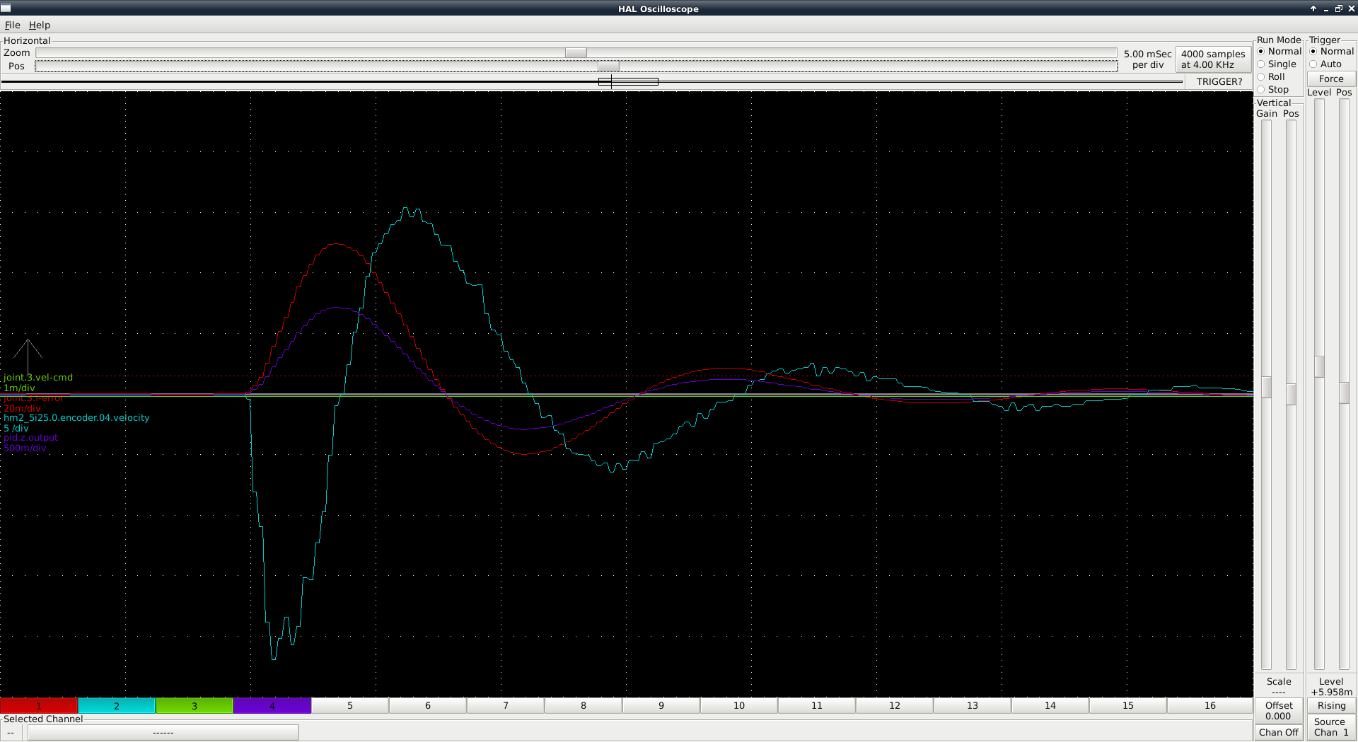

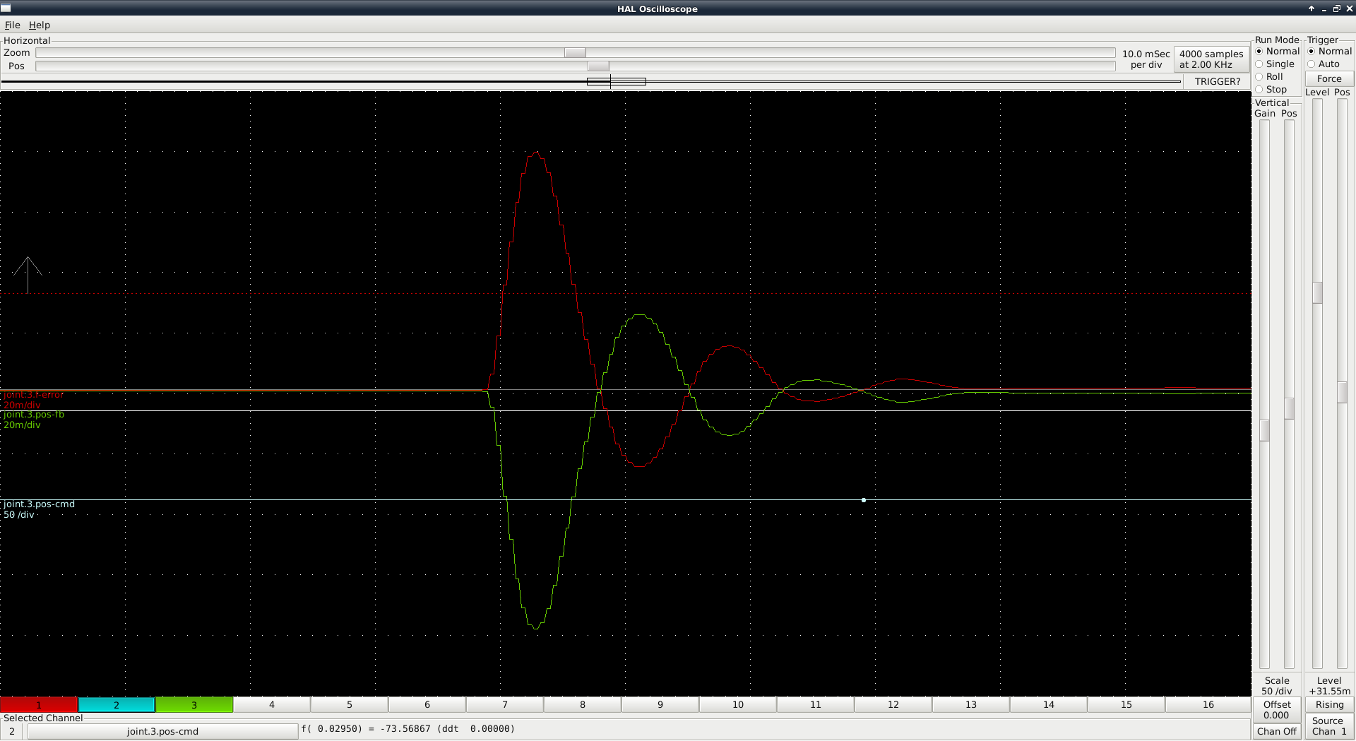

Here is what I'm seeing in halscope. You can see the sharp front edge on the encoder velocity spike but a much more damped f-error curve, which is why I initially looked at this as the encoder inputs on the 7i77 picking up on some kind of a brief noise burst. I've gone over just about everything I can think of at this point and can't seem to drag this gremlin out into the light. I'm no tuning guru, so by no means am I ruling out the possibility of having made an error in PID tuning somewhere.
07 Jan 2018 14:27 #104110 by PCW
Can you re-number your axis in hal so Z is moved to another encoder/ analog out?
That would check if this is specific to a 7I77 channel or external hardware
Encoder noise seems unlikely to cause such a repeatable glitch and should be possible to eliminate
with encoder input filtering
07 Jan 2018 14:48 #104113 by dpersuhn
I can move it over in place of the B axis temporarily to see if there is something funky going on with that channel on the 7i77. I'll let you know what shakes out of that test.
07 Jan 2018 20:55 #104134 by dpersuhn
OK, so I have bad news and I have bad news... There is definitely something wrong with the 7i77. I moved the Z axis to encoder 5; and still saw the issue. I then moved the analog out over to 5 and the drive didn't enable. A quick check with the meter showed that the enable component (I'm assuming a FET) isn't activating to enable the drive. That's a problem, but its gets even more strange. I then decided to move the drive to analog 3 because my A axis is on it and hooked up, so I know that output works, right? Not so fast. I plugged in, changed the hal, looked like testing could commence. I jogged around a bit in joint mode to make sure things were all good and they appeared to be so until I hit the home axis button and Z started happily wandering in the wrong direction. Yep, you read that correctly. It jogs in the right orientation and with no changes to the ini file, it goes backwards when homing and plugged into encoder 5 and analog 0. I never noticed a problem with the A axis using encoder3 and analog0, but then I don't have homing to a sensor and index pulse set up yet on that axis. Before I go down the path of declaring the 7i77 as dead hardware, I'm wondering if there isn't something squirrely going on with software or firmware here.

07 Jan 2018 21:04 - 07 Jan 2018 21:06 #104135 by PCW
This is expected ( Axis 5 is normally used for spindle control so has a independent enable (axis 0..4 have a common enable ) )
The homing in the wrong direction error Is much more likely a hal or setup error than software of firmware

07 Jan 2018 21:38 #104136 by dpersuhn
OK, so hm2_5i25.0.7i77.0.1.spinena. Got it. I moved everything over to 5 and we'll see if I get the spike.
As for homing, I generally would agree with you, but here's the catch. I'm not touching the INI file at all and the only thing I'm changing int the HAL are the encoder and analog numbers, Z jogs and homes fine on encoder4/analog4 as well as encoder5/analog5 now that i tied in spinena. I'm going to set up halscope and let it sit for a while to see if I get the same spiking.
08 Jan 2018 04:26 #104145 by dpersuhn
Well, good new and bad news. The good news is that moving the Z axis to encoder5 and analog 5 seems to have resolved the problem. The bad news is that it means the 7i77 looks like it needs to be replaced.
08 Jan 2018 05:24 #104149 by dpersuhn
At the risk of being told this is impossible, here is what I decided to try, figuring it couldn't hurt if I was staring at having to replace the 7i77 anyway. I grabbed a copy of the 7i77 firmware and reflashed the card. However impossible this may seem, the reflash corrected the homing reversal i saw before when using analog0. I plugged the Z axis back into encoder 4 and analog 4 and will leave it sit idle overnight with halscope running to check if the axis spikes again. Best case, maybe the sserial firmware on the card was somehow corrupted?
08 Jan 2018 09:41 - 08 Jan 2018 09:46 #104153 by dpersuhn
No such luck. As of this morning, I have a triggered halscope with the dreaded spike.
