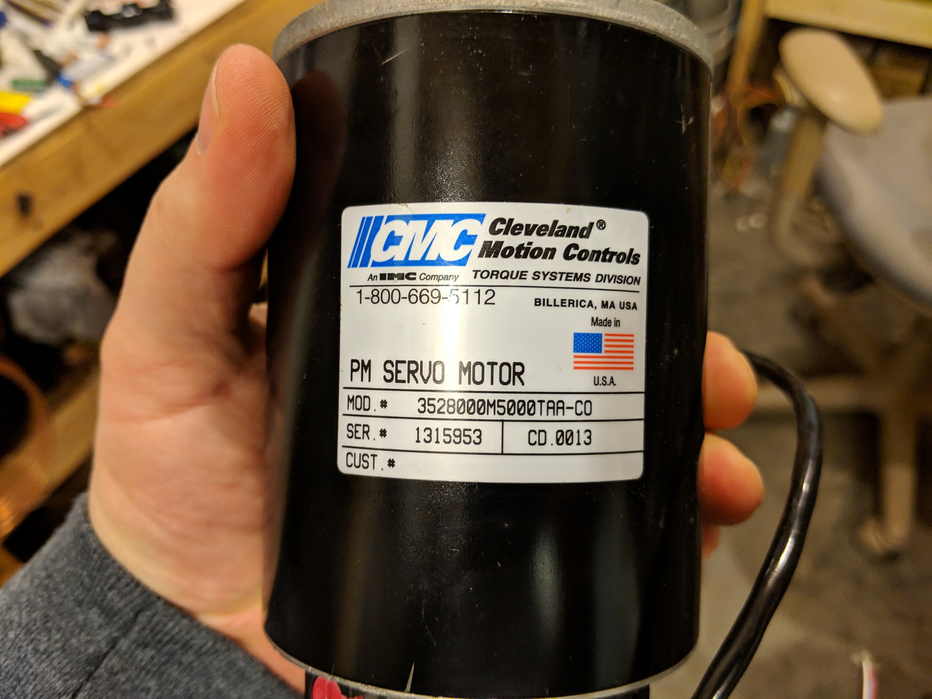

20 Jan 2019 00:42 #124462
by hatch789
Replied by hatch789 on topic Add Z-Axis to my machine
Guys here's the servo motor that I have in my possession. It appears to be new (old stock) and never used. It has an encoder on the back. I'm trying to find the literature for this one but can only get close, not exact. There is info on 3528 series servos but none with the M5 encoder which mine appears to have.
I'm also struggling to try to figure out how to wire this puppy. I have done some searches but it's not information that appears to be readily available. Hopefully they are standard and easy enough to figure out.

Can anyone help me with my wiring of this servo motor? My wires are colored:
Black
Orange
Green
Red
Blue
White
Black/White
Black/Red
Unshielded (Grounding wire?)
Black
Orange
Green
Red
Blue
White
Black/White
Black/Red
- Thank you received: 4652
21 Jan 2019 13:37 #124530
Replied by andypugh on topic Add Z-Axis to my machine
Is that just the encoder wires, or does it include the power wires?
Do you know if this is a DC motor or a 3-phase brushless?

21 Jan 2019 13:49 #124534
by hatch789
Those are just the encoder wires. I will find out how they are setup ...I'm determined to do it. I also have another servo motor with an encoder and I know the pairs of that one.
My bigger burning question is how do I go about setting my 7i42TA to read the encoder input? Do I need a new .BIT file or is the solution more simple than that?

- Todd Zuercher
- Posts: 4782
- Thank you received: 1472
21 Jan 2019 13:57 #124538
Replied by Todd Zuercher on topic Add Z-Axis to my machine
Sometimes the best solution is to pop the cover off of the encoder, and have a look to see if you can ID the manufacturer and model# of the encoder itself. Then try to look up what the pin out is for it from there. I've had to do that with a few used servos I've bought from ebay. I even found that I could add index to one just by adding a pair of wires.
- hatch789
- Posts: 143
21 Jan 2019 14:21 #124542
by hatch789
I know I could use a resolver and I will if it comes to that I guess, but I'd like to explore how difficult it is to use what I have on hand. I currently have 2 servo motors with encoders. Popping the cover off is just what I was going to do and look at the labeling so thank you Todd. The servo on this big one is driven by 4 connections for brushes. One is red, one black each of these has a opening in the external threads. Then 2 more black fully enclosed external thread slots on the opposite side. SO I guess 4 brushes but not sure why only one is red? I'll figure that out later.
The other servo motor I have is ready to go literally wired up and ready. -Just not sure if it's powerful enough for my knee. That's why I want to keep the encoder that's on it because I cannot replace that one.
Andy do you want my SVRM6_48.BIT file that I use for my 7i49 card or do you want a different bit file? I am not aware of any .BIT file for my 7i42TA card but maybe there is one? Also I have been asking for a while now if my SVRM6_48 files are old since I think either you or PCW made them for me back in 2011 when we were first messing with my resolvers. Do they look correct to you?
