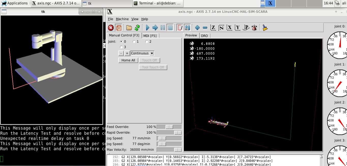

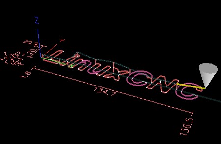

Hello everyone. I had a problem using virtual SCARA animation. I'd like someone to give me advice or some information.
My goal is to use SCARA to draw the same model as the trajectory。
target
The final "tk"
What I got was different from what I wanted.。
QUESTIONS:At first the tool was too far from the trajectory.
I want to know how to adjust the position of the trajectory.
I want to know how to adjust the position of the virtual SCARA3d animation
target
The final "tk"

29 Aug 2019 14:30 #143559
by pl7i92
Replied by pl7i92 on topic SCARA-3D virtual animation
you shoudt update to the 2.9 master there is a better way to get vismach to work
and there is a complete new scara traj

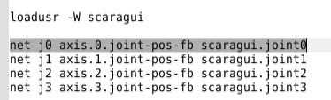

Thanks . I have one more question. I use "net" to connect the motor to the axis of 3D animation. Do you know where there are tutorials? I feel like I'm linked, but I can't be sure.
Do you understand the meaning of this sentence, "net j0 axis.0.joint-pos-fb scaragui.joint0"?
In my opinion, "axis.0.joint-pos-fb = > J0 = > scaragui.joint0". Do you think that's right?
I didn't find such a description in the LinuxCNC documentation, all the links with "= >, < ="
look the picture
scara_sim_4.hal file
Part of the message is hidden for the guests. Please log in or register to see it.
look the picture

30 Aug 2019 03:25 #143630
by phillc54
Replied by phillc54 on topic SCARA-3D virtual animation
This section describes it very well.Do you understand the meaning of this sentence, "net j0 axis.0.joint-pos-fb scaragui.joint0"?

30 Aug 2019 05:36 #143632
by cheng
Replied by cheng on topic SCARA-3D virtual animation
Thank you. I've already read this file.
- Thank you received: 4652
02 Sep 2019 20:19 #143933
<optional arrow> is the bit you seem to be missing.
Replied by andypugh on topic SCARA-3D virtual animation
03 Sep 2019 13:40 #144070
Nothing to read.
The arrows are optional.

04 Sep 2019 00:55 #144101
by cheng
Hello everyone.
Until now, I haven't figured out how to use the 3D virtual module to draw the correct pattern.
I have learned about "world coordinates", "tool coordinates" and "basic coordinates" these days. I guess I need to modify the world coordinates and the basic coordinates. Who can give me some advice, please?
by cheng
