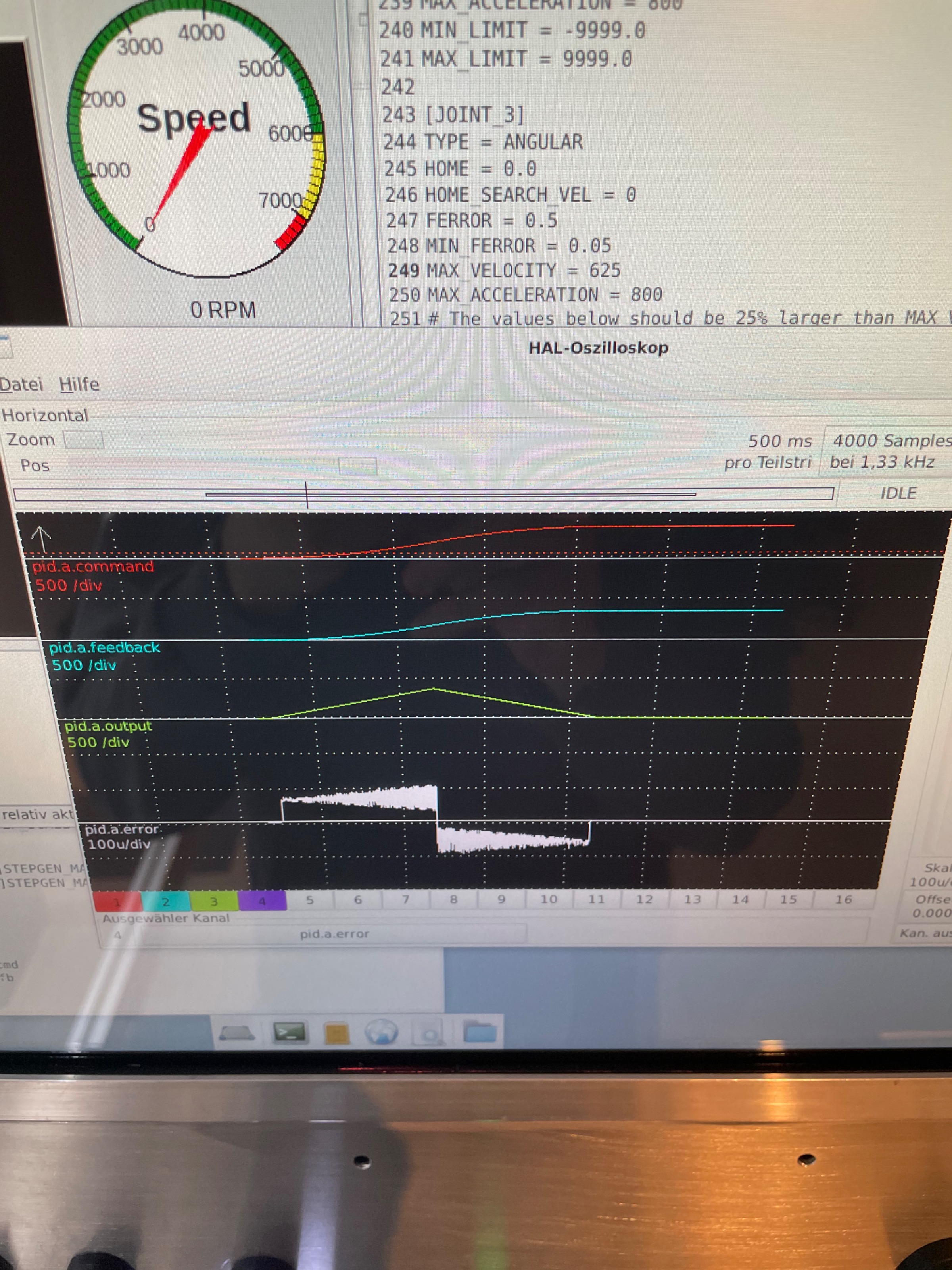

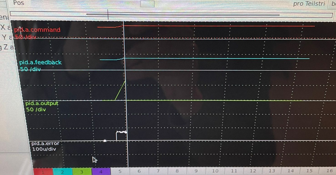

Just tried setting the maxerror to 100 and got the same error.
The first professional screenshot shows the behavior at 50kHz, the second at 100kHz. As if the Stepgen or PID suddenly stops at a certain frequency.

A screenshot is smaller and much more legible than a photo

You're right, of course. I couldn't have done any better at that moment.

I would widen the following error limits to see what's happening
(and scale the following error so that the limit (0.5) is on screen)
It might be that you are dropping packets (timing out) which
can cause a following error of velocity/servo_thread_period

I have increased the following error and now it works. The MESA card must have made too many steps between two queries and thus triggered a following error. A bit confusing, as I would have expected the error message "Following Error" and not "Position Error".
Anyway, thanks a lot.

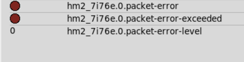

- Daniel_D_Punkt
- Posts: 18
05 Mar 2023 13:32 #265913
by Daniel_D_Punkt
Replied by Daniel_D_Punkt on topic MESA 7i76e Stepgen Frequency
Packet-error-total? Can not find it. Only this pins see image attached.
