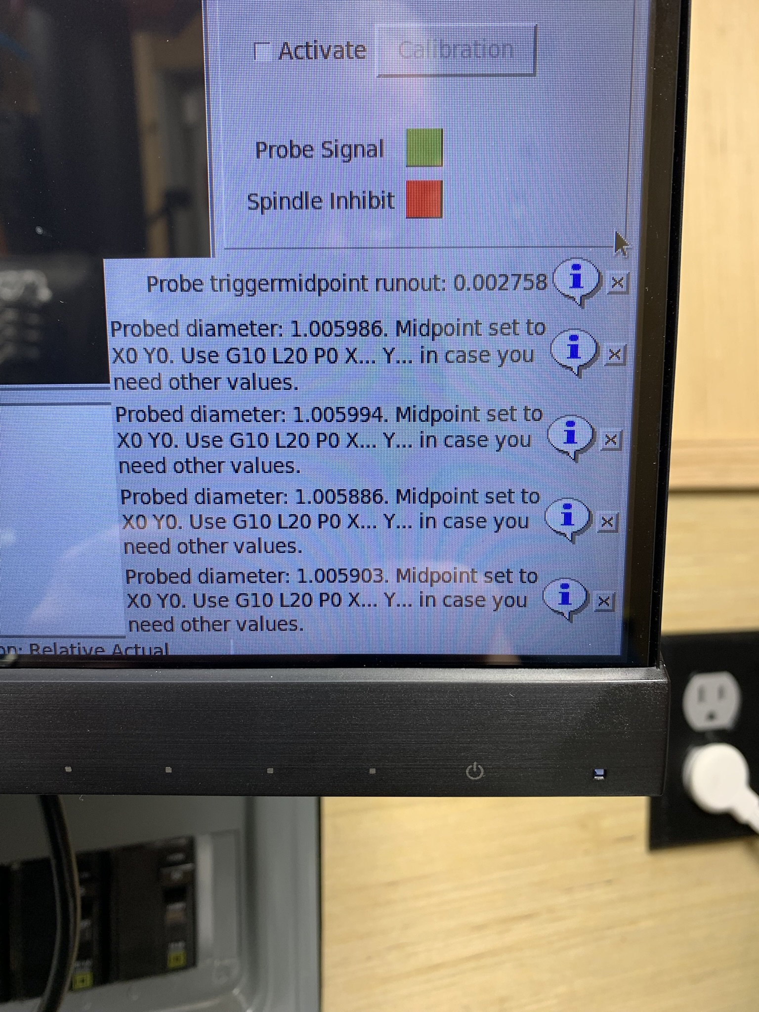

I had trouble installing Verser's v2.9 probing screen for the Axis GUI. Eventually I decided to try EasyProbe. Easy enough, except that the pocket probing function has a constant that only works for metric. But if you change ff_distance from 5 mm to 0.2, it appears that everything works.

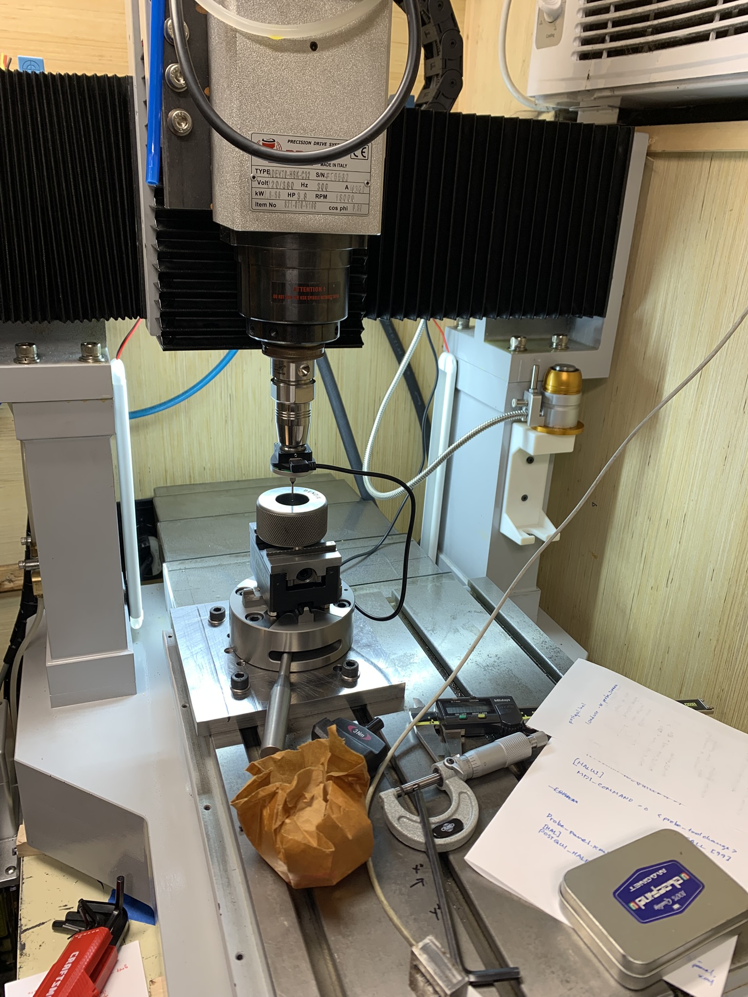

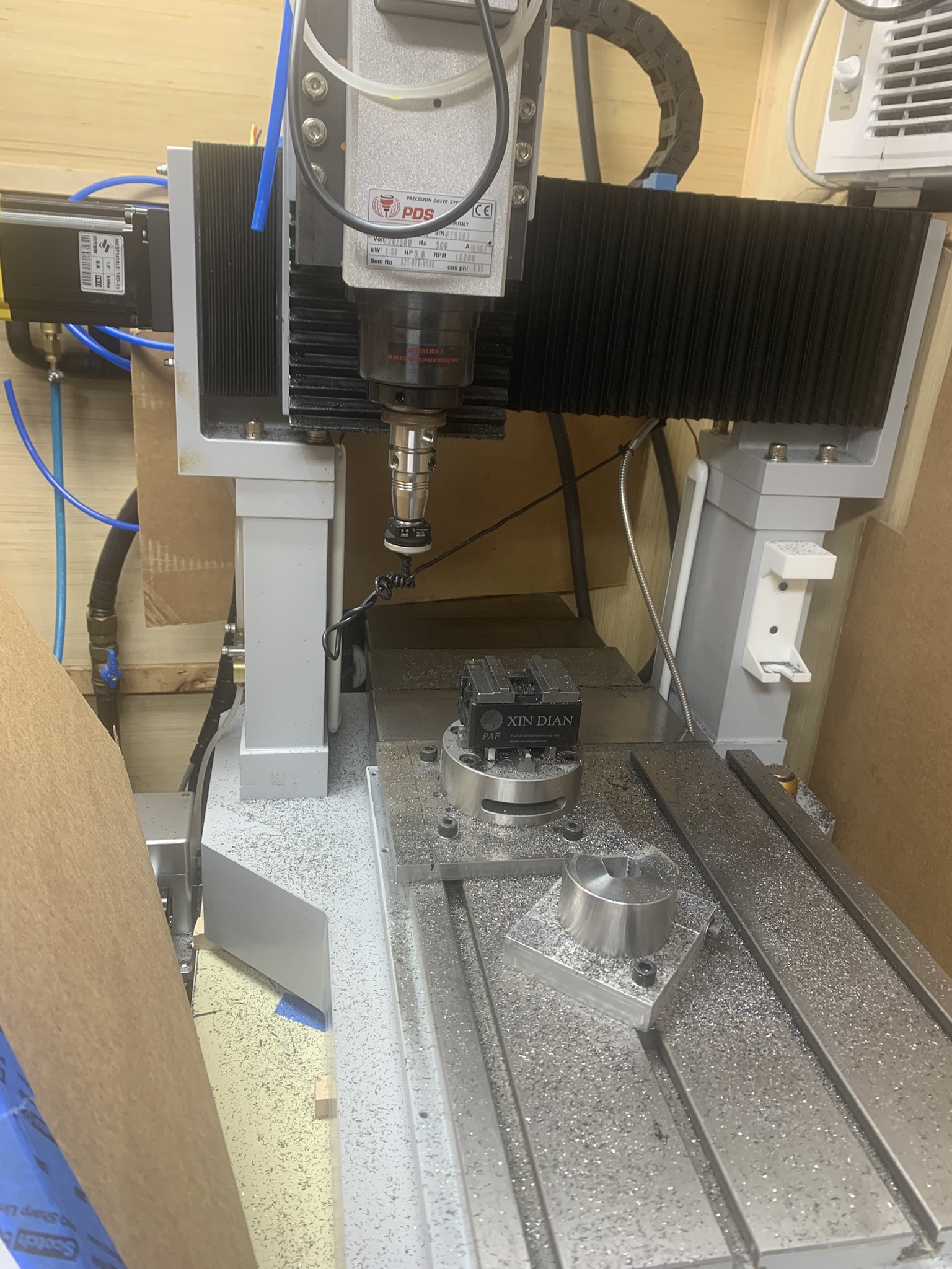

EasyProbe allows you to calibrate the probe tip, which avoids the complication of using an indicator to get the probe tip colinear with the axis of the spindle. The drawback is you must measure with the probe oriented as it was during calibration. Here's my calibration setup

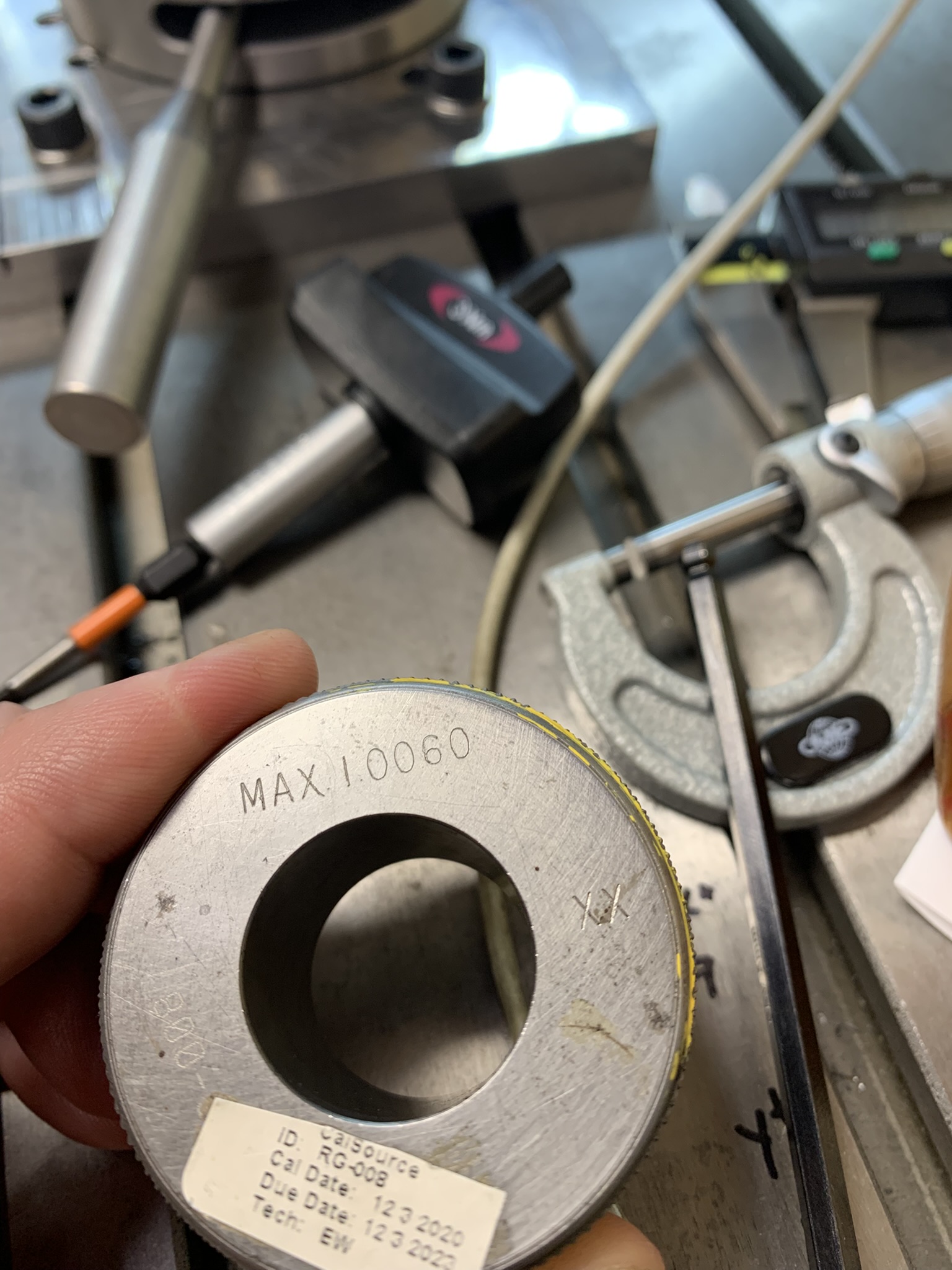

The ring gage is 1.0060 inches
After calibration, the I probed the pocket a few times. The measured diameters varied from the standard by
While working with EasyProbe, I encountered manual tool changing for the first time, with rapids set to 200 IPM. I had also set TOOL_CHANGE_QUILL_UP, which almost smashed the probe into the table. I had set up the axes using the right hand rule, with +Y moving away from the operator. This requires that +Z is up. I turned off the quill-up setting but had several close calls because M6 rapids the spindle to the tool change location, not caring about the Z position. So I've got to reverse the Y axis so I can take advantage of the quill-up setting.
- 0.000,014 inches
- 0.000,006
- 0.000,114
- 0.000,097

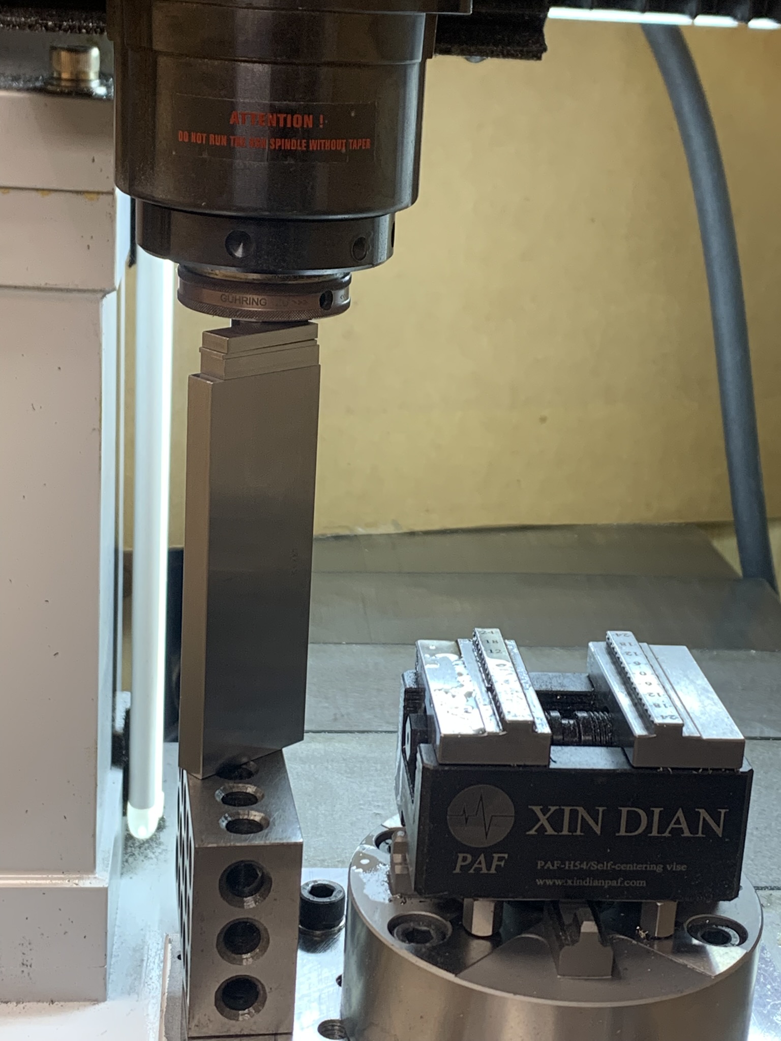

Getting the gage length of the probe isn't as easy as normal tooling. It's a dual-contact spindle nose, so normally you can measure the length of tools on the surface plate. But with the added variable of Z travel in the probe, you can't measure directly. I ended up touching off on the 1-2-3 block and doing the guess-and-check on a gage-block stack to find the length. A big gage block, adjustable parallels, and a micrometer would have been less dramatic but I didn't think of that until later.

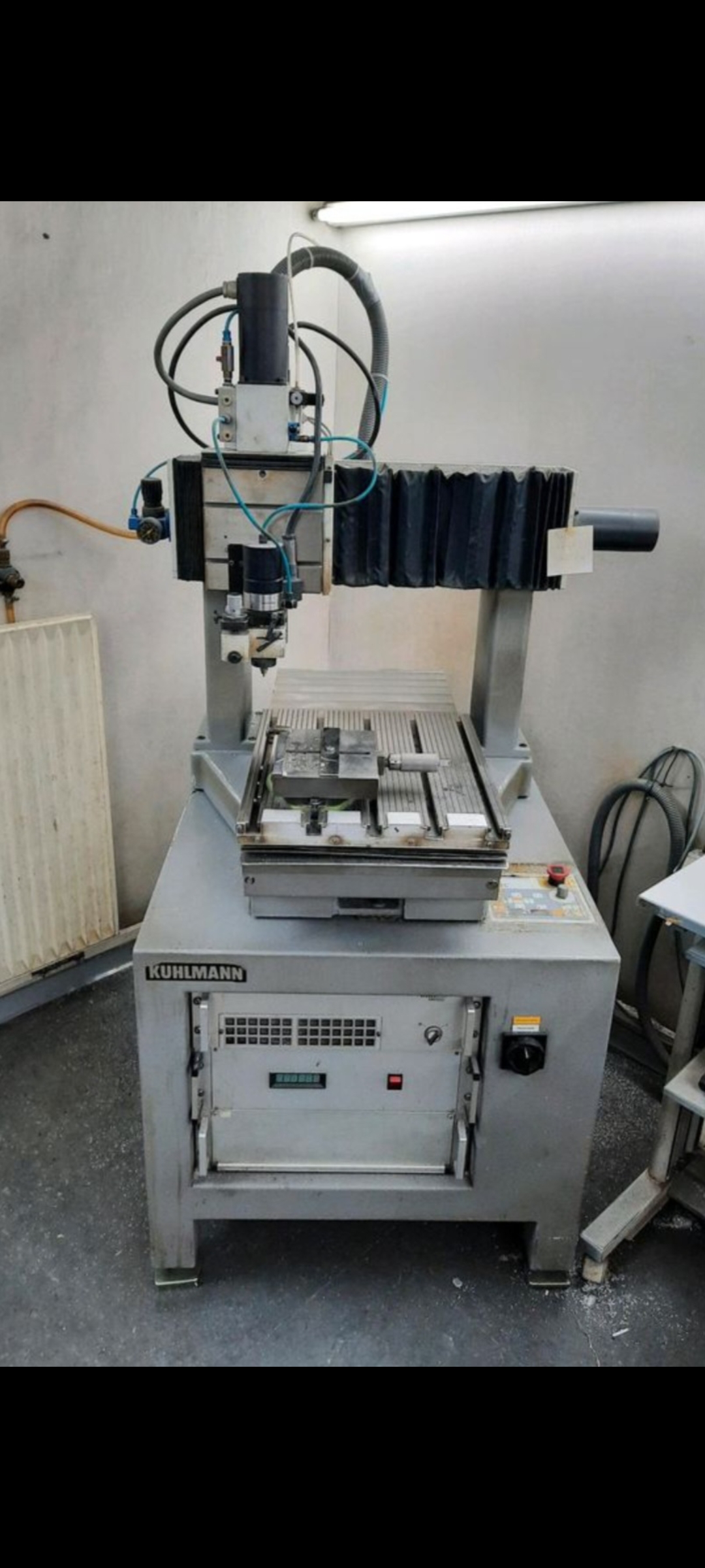

One of the safest way to have the probe and the tool touch sensor on the same hight would be to install a rigid piece of metal and facing it with an meassured tool. After that calibration of the probe with this new face.
Btw. Cool machine. Do you have somewhere more info about it? Right now I retrofitting a Kuhlmann P20. Looks quite similar.

It's from LY CNC, which you can find on Alibaba. This is the 3040 model. I watched Stephan Gotteswinter's video about his new micro mill, and was inspired to do something similar. It was going to be difficult to get the same epoxy-granite frame he started with, here in the states. This cast-iron frame was a similar design, so I decided to try it out. There was a fair amount of waiting involved but the machine seems fairly sound.
With the spindle half-way down, I'm getting 0.000,5 in (13 microns) deflection with 20 lbf (88 N) pressing against the spindle nose. I think those are similar numbers to Gotteswinter's thumb test.
I got out the master square to check the perpendicularity of the X and Y axes. They're very square--within a few tenths (0.000,1 inch = 3 microns) over 10 inches (250 mm). The YZ plane leans back about 0.002" over the 7 inch travel of Z. In the XZ plane, there's 0.003" deviation over the same distance. I might eventually try to correct that but the parts I'm making are fairly small, so maybe it won't be a problem.

I dont have a thread for my current project. It was a fast decision thing, because the price was low. Looks smaller on the picture than in real life. Weights 500kg (machine + table). Dont have the fancy pc table

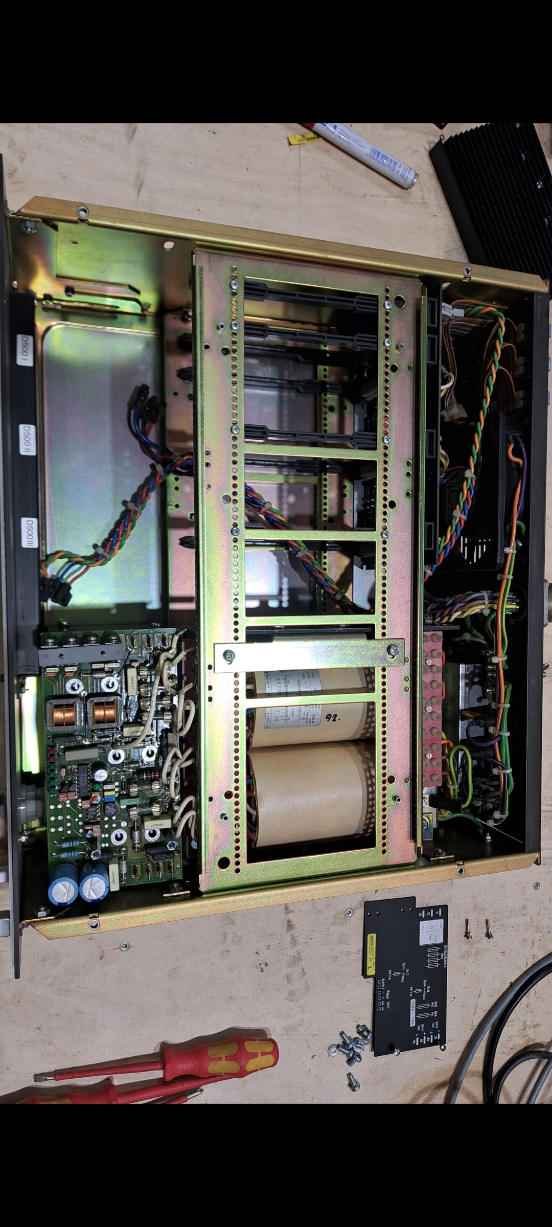

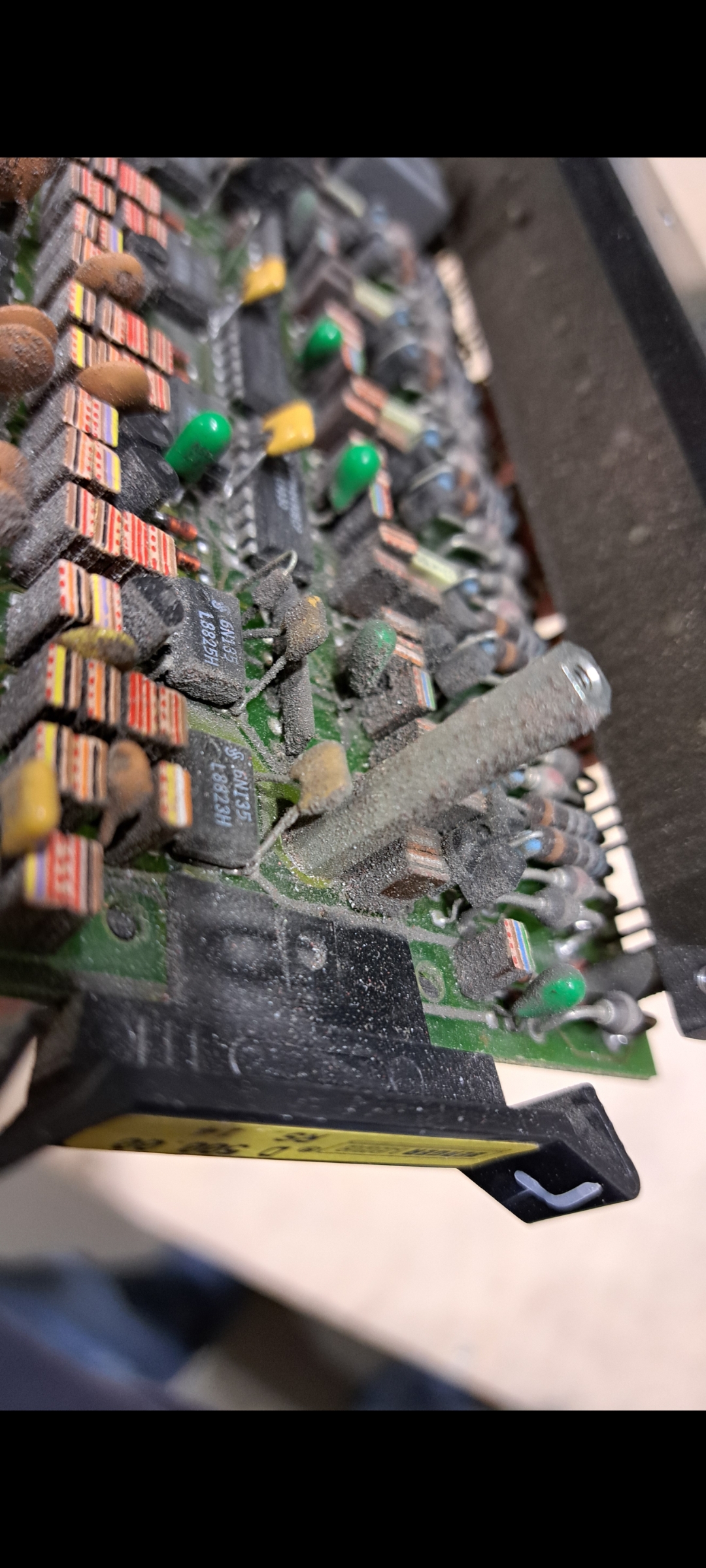

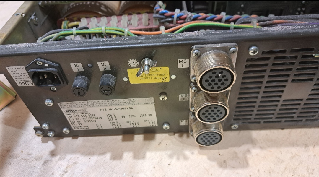

Old Berger Lahr 5 phase steppers. Drives invented 1987. Machine is build in 1992. I want to safe the old drives, because I like to maintain such old hardware. I already ordered some caps for replacement (known as fault reasons).
Machine is all cast iron! But with supported round rails instead of linear rails. But I will keep them. It will be sufficient for al lot of my work. Travel is 400x400x100. Machine is only 900x800xhight (didnt meassured it yet).

Theese berger lahr drives are known for having faults because of the old caps. So I already have new ones at hand. Tantals for example will be changed to multilayer ceramics, but that is another story.
Yes, suprisingly theese machines were sold as engraving machines. Really beefy engraving lol.
But of cause I will install a spindle with more power. Nothing fancy for this project. Just a er25 4kW spindle and an old vacoon vfd laying around.

As I said this is another story. I am familiar with this kind of stuff. No timing caps, no analogue circuits etc are involved. Just voltage stabilisation functions in this cases. And I just dont want to have tantals on the board as long as I dont have to.
Ah and of course. No charging cap and so on. So low esr isnt a problem here too.
