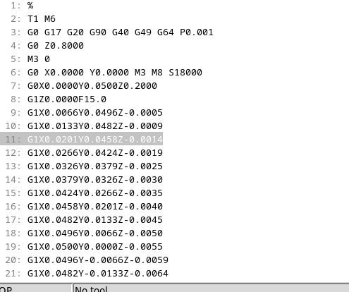

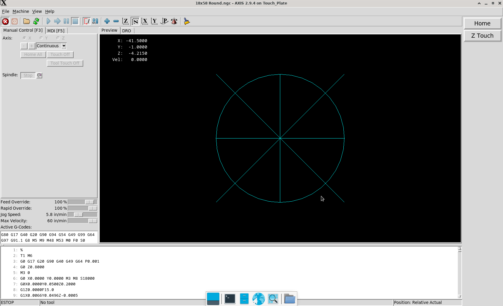

Upgraded to deb12 and machine set up great. However when I load a work file I get a weird pattern.  The file is one that I've used many times.

10 Nov 2025 21:39 #338162 by davmer42
Replied by davmer42 on topic issues with cnc 2.9
Here is the full gcode. This runs fine in my simulator, and also ran fine in vs 2.8.
11 Nov 2025 07:22 #338179 by Aciera
Replied by Aciera on topic issues with cnc 2.9
seems that you have a typo, try 'M3 S0' as your 'M3 0' is probably interpreted as a program end 'M30':

12 Nov 2025 21:48 #338286 by davmer42
actually I found out it was caused by a tool being called that doesn't exist, so it cancelled the file load
