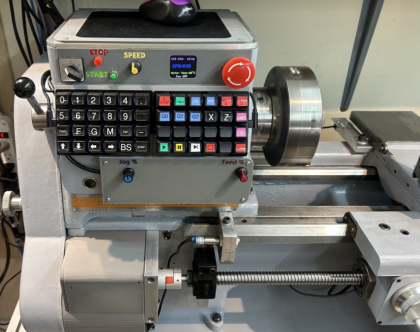

I'm near complete converting another manual lathe (Standard Modern this time) to LinuxCNC.
These programmable keypads are convenient for commonly used key entries to Axis/MDI. From LinuxCNCs perspective they are just another keyboard.
I have a few spare keys and I would like to use one to activate a Mesa output. I can program the key to any key or even key sequence.
Is there a way to make this happen in HAL?

Try using the sendkeys component
linuxcnc.org/docs/html/man/man1/sendkeys.1.html
