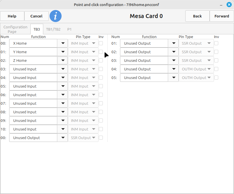

Hi...I have a mechanical home switch wired as seen from others but does not seem to be functioning...I am not sure I have hal right for x home switch...I have pin # 2 from mesa 7196s going to nc on switch...Input common to 24v ground on power supply and switch common to 24v power supply v+...I am not very good with electric so any help would be greatly appreciated..

Hi...I used pin that is labeled iN2....and put in Hal as GPIO 002....when I tried to test in Halshow nothing happened....i checked wiring seems ok....I did not know if i am missing something in Hal...I only put info in the x axis section...
# ---# external input signals...under this part it is blank..
setup home / limit switch signals---
net x-home-sw <= hm2_7i96s.0.gpio.002.in_not
net x-home-sw <= joint.0.home-sw-in
Thanks for reply!!

Does the yellow LED near IN2 operate as expected?

I forgot about that.....no

if I go to V- instead of power supply ground IN2 lights...is that ok? or does it indicate a different problem?

So all is working now....thanks again for your help...I am not sure what INM pins are...would I need another board?

If you use a recent pncconf it will use the INM pins rather than the GPIO pins
The INM pins have the advantage that they are debounced. Standard 7I96S
firmware has INM on all isolated I/O pins (the GPIO pins work but the built-in
debounce is often an advantage)

Got it..Thanks...Have not been using the pncconf ...I am using 9 axis and I was afraid it would overwrite ...

You can always use pncconf/MesaCT to create a sample configuration
to copy/paste from, if you don't want to possibly corrupt your hand edited file.
