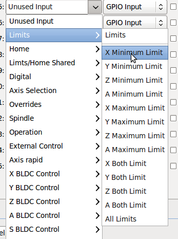

Hi Chris,
I'm trying to figure out how you did the combo boxes in pncconf. When I opened the pncconf.glade file with glade I got an error about missing gnome so I added that via the package manager. Now when I open pncconf.glade I can only see the splash screen and the dialog screens.
I've studied the fill_combobox_models method but don't quite get the whole picture. If you can point me somewhere to look I'd appreciate it.
John
John

I was hoping to do something similar to this
But if it is overly complicated I don't want to take up a lot of your time.
By one level do you mean a normal combo box? I have mastered this much so far with combo boxes.
John
John

By two level I meant a dropdown list inside a drop down list AKA treeview.
simple combo boxes oly have a single list of choices.
I never could find a tutorial for a treeview combobox so pieced it together from related stuff.
Here are some sample files I used to figure out how to have a treeview in combo boxes.
There are also two other files to show a treeview not in a combobox and a fairly plain combobox.
Run these from a terminal - most have debug output.
Hope that helps. I can show you a link to help with figuring out tree iters if you need it.
Chris M

Chris,
Thanks for the examples the treecombobox.py is the one I was looking for.
John
John

The last piece of the puzzle fell into place this morning and I have a better understanding of the combobox treestore.
Thanks for the examples they helped a ton.
John
John
