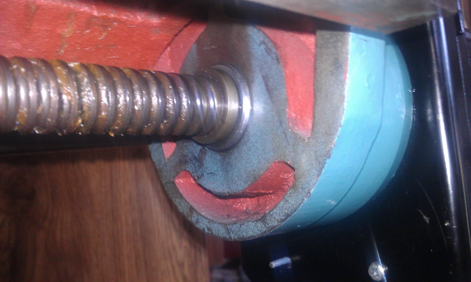

In the help section of PNCconf there is a reference to "backlash", and "compensation". It says there is a section in the manual, I haven't searched hard for it, but didn't find anything in a quick look?
After redoing the X axis, trying to reduce the torque required to move it. I now have about .010" of backlash. Also after doing the "test/tune" on my Y axis I have about the same amount of backlash.
I think I should try to reduce it mechanically. .010" for a machine with ballscrews is terrible. Not much better than my manual mill with leadscrews.

Here is a picture of the back of the end plate with the ball screw up against the washer I installed.
In the instructions it says that the retainer ring on the ball screw should contact the bearing. There is no way for the retainer ring to fit through the hole in the end plate. Instead it was binding against the end plate. I thought I would install the washer to act as a shoulder for it to ride on.

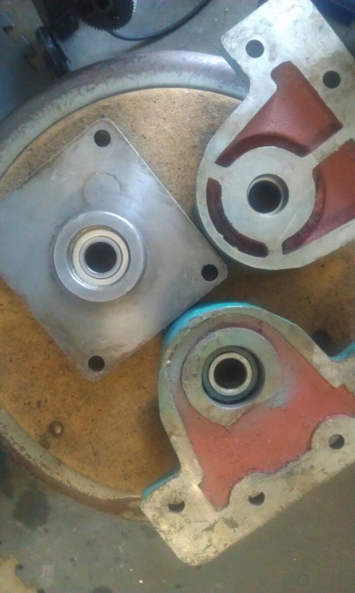

Last night while trying to fall asleep, I was trying figure out how to machine a larger hole in the end plate. I started wondering why the end plate on the Y axis had a large through hole, and the end plate on the X axis had such a small through hole in comparison. It finally dawned on me that one of the previous owners had switched the end plates on the X axis. So this AM I pulled both X axis end plates, along with the Y end plate. Sure enough the other end plate had a larger through hole.
Here is a picture for comparison.

When I pulled the end plate on the Y axis I noticed that there was a gap between the outer race of the bearing and the shoulder that it should rest on in the pocket. Somehow the last time I assembled it I must have pushed the bearing back off of the shoulder. I reseated the bearing, measured the depth to the bearing from the front of the cap and reassembled it. I checked the depth after assembly and it was the same, so hopefully I've cured the backlash in the Y axis.
The backlash in the X axis was because the beveled spring washer was not tight against the retainer nut. It had actually started to wear the back of the nut, where it contacted the spring washer. Everything is tight now so hopefully I've cured the backlash in the X axis also.
