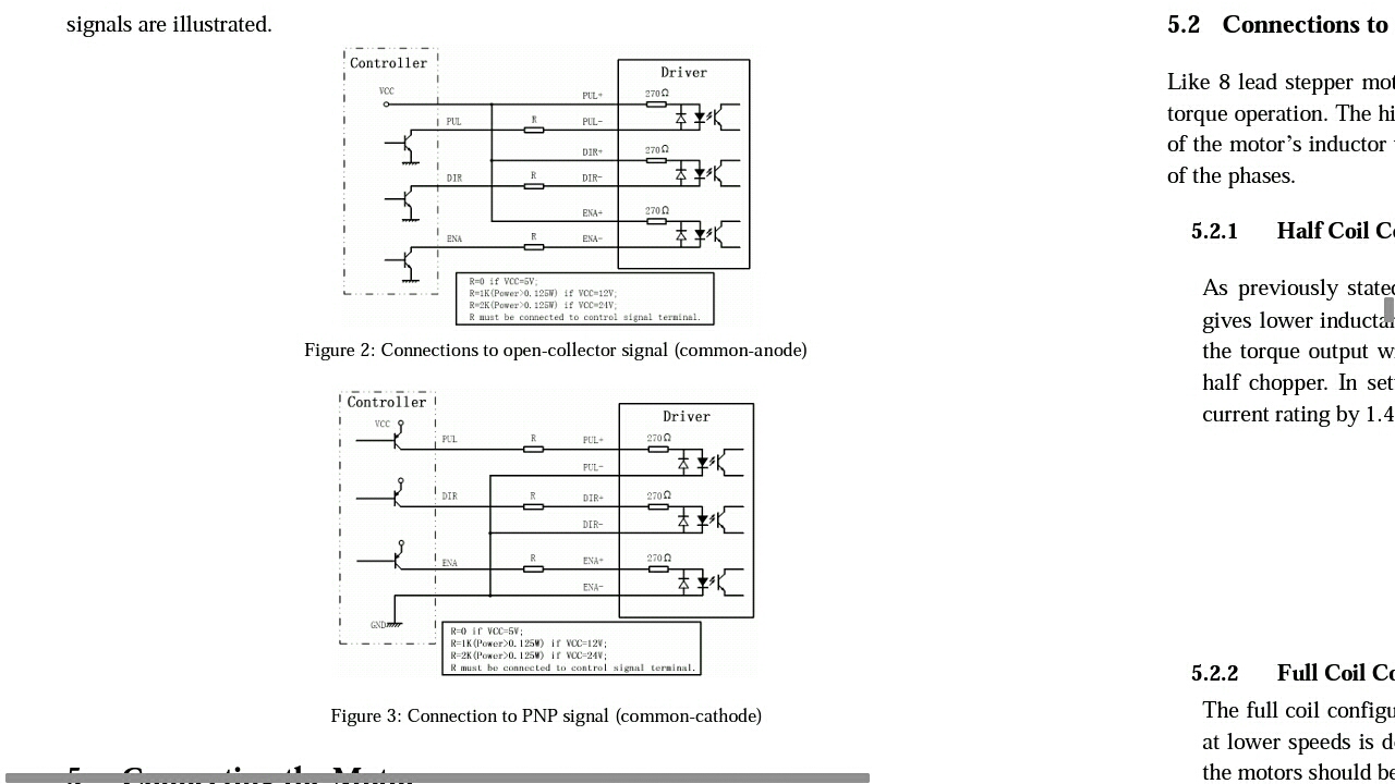

31 Mar 2014 09:00 #45443 by PCW
Replied by PCW on topic First time setup - 5i25/7i76
Ok here's where I am at. Been trying to research as best as I can but I have a wicked headache. I didn't realize the 7i76 needs a separate power supply for the field I/O. Could this be what is causing my motors not to work? I still want to power the 5v logic with the card but I have 24v I can hookup for that.
No. the step/dir outputs only require 5V (from the 5I25 or pins 21,22 of TB3 )
Field I/O power is only required when you need to use the field inputs and outputs
Also what are the 5vp and gnd on every axis on the 7i76? Does each one of these need power from somewhere to correspond with that axis?
Drives with single ended step/dir inputs need a common GND or +5V common pin routed to each drive
5VP on these pins comes from the 5I25 or TB3 source (P means its protected against shorts)
If you cannot get your drives to step (and you have a step/dir hal file that loads and runs with linuxcnc)
I would check step motor wiring and step timing.
What kind of drives to you have and do they really have differential inputs?
(I ask because I have seen people ground the7I76 -outputs or tie the 7I76 +outputs high)

31 Mar 2014 09:27 #45445 by jonesturf
Replied by jonesturf on topic First time setup - 5i25/7i76
I have Leadshine DM1182's. It says in the manual they support differential inputs as well as single ended inputs. The wiring is ok. Double checked that before. The drives have an auto config and when I do that I hear them move for a second. The 7i76 appears to be working because I can see the voltage drop on a volt meter when I do a test run in config.
The drives also have an enable +/- for turning the drive on and off and a fault +/- for outputting fault signals. Attached is from a different version of the manual I downloaded (don't know why they have 2). I think it shows what you are talking about saying it accepts these type of single ended inputs. Maybe I will try one of them tomorrow.
