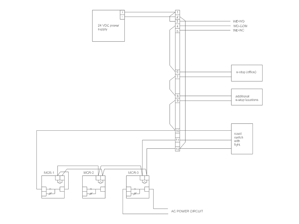

- Posts: 18808
- Thank you received: 5193
03 Nov 2014 09:50 - 03 Nov 2014 10:09 #52707
Replied by PCW on topic 5i25/7i77 xyz servo build
There are typically at least 2 levels of safety in a LinuxCNC servo system
One is E-Stop or Emergency stop. This removes power from the spindle and the servo drives
This is typically implemented completely in hardware (relays, switches, contactors etc).
A lower level of safety is provided by LinuxCNC's following error monitoring. If the servos actual position
(as reported by the encoders) differs by a large enough amount from the commanded position,
LinuxCNC will shut down and disable the servo drives. This is what the drive enables on the servo drives are used for.
Note that unfortunately your drives do not have drive enable inputs but rather drive disable inputs
To use these you will probably have to use a normally closed relay to connect the disable inputs to ground
when not specifically enabled by LinuxCNC

- cmtunnel
- Posts: 145
05 Nov 2014 01:14 - 05 Nov 2014 08:43 #52777
by cmtunnel
Replied by cmtunnel on topic 5i25/7i77 xyz servo build
Does anyone have a schematic or some info. I can use to do the above? I think at this point that this is the only thing keeping me from being able to power up the machine.
Ok I called amc and i think i understand. Going to post a drawing tonight of the current wiring and hopefully that will make it more clear.
Files attached of my existing system. Any help on re-wiring is greatly appreciated. Thanks.
