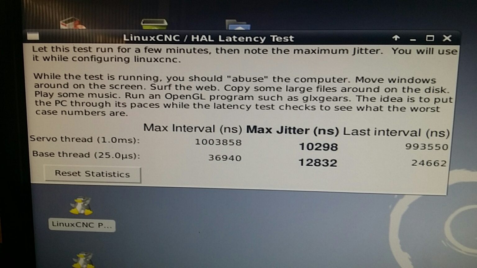

04 Nov 2014 01:31 #52732
by chrimabelini
Replied by chrimabelini on topic Stepper not working
Thank you for your fast response, after disabling the suggested points, I ran the latency test (see attachement), the results were not to bad.
Then I startet AXIS and immedeatly after the window popped up I got get an error "unexpected realtime delay".
I started AXIs again, then I could move the x-Axis with Manual control, but without a working steppermotor.
Best regards
Markus
Best regards
Markus
- Posts: 18857
- Thank you received: 5208
04 Nov 2014 01:54 #52733
Replied by PCW on topic Stepper not working
If you can move the axis without a joint following error that means that LInuxCNC is communicating with the
5I25 stepgens correctly
If your drives dont step I would try adding some margins to the step times
(drive specifications are _minimum_ times, that is just on the edge of not working)
As far as the real time delays goes, maybe something here will help:
wiki.linuxcnc.org/cgi-bin/wiki.pl?Troubl...ck_dmesg_for_details
Though a lot of those suggestions are not appropriate for newer motherboards
It may be that your motherboard is just not suited for realtime use
