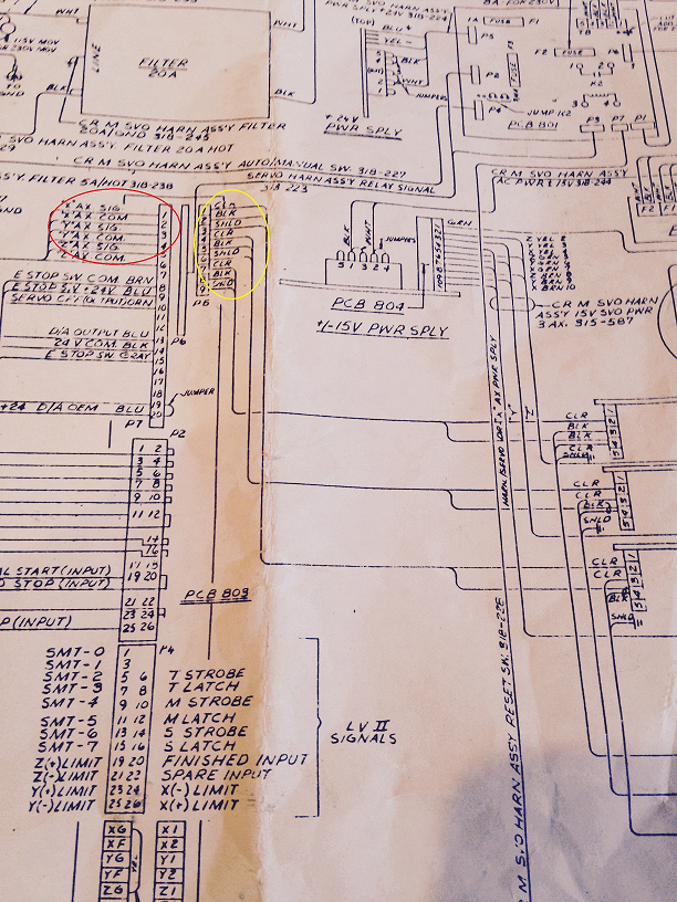

Anilam CrusaderM to Linuxcnc Mesa 7i77 + 5i25 was created by punking
My 3 axis mill was working fine except my communication board in the controller stopped working and I no longer could drip feed large amounts of code. I know everything with the amps + servos + tachometers + glass slides are all operating ,as I can still plug everything in and hand enter code into the controller and it operates fine.
I tuned the amps per the manual with a oscilloscope and have that portion of the machine seemingly tip-top shape.
I have Ubuntu running on a capable machine. I have linuxcnc 2.6 installed and all working. I have a Mesa 5i25 board feeding a 7i77 board - all seems fine. I have the Demo version of Linuxcnc working.
last weekend I connected the 3 axia encoders to the 7i77 and ran 12volts for field power. the encoders on my machine are single ended not differential( I jumpered the 7i77 accordingly for the 3 axis for single ended)
I was able to calibrate each axis beautifully with a plunge indicator and adjusted the resolution in pcconf so they work perfect.
Question
my problem is wiring the output in TB5
I don't know what to do.
in the photo the connections circled in red come from anilam cpu (sig, common)
so to mimak the old controller I just wired the
7i77 GND to Common in the red circle
7i77 AOUT0 to Sig in the red circle
* I don't know what to do with ENA0- and ENA0+
The info below is how the amplifiers themselves are wired:
pins on the amplifiers listed below are fed off of the wires circled in yellow
Pin 2,3,4
of Connector J-1
on Page 6 of westamp manual
these three are the only pins wired
pin2 = sig
pin3 = tach
pin4 = common
Manual for my westamp amplifier:
www.ormec.com/LinkClick.aspx?fileticket=...3d&tabid=168&mid=757
right now if I start up the mill and have Linux cnc idling all the axis drift in the negative direction.
any help would be greatly appreciated

Its a bit awkward because the Westamp drives are normally enabled and you have to ground
a pin on the drive to _disable_ the drive.
One option is to tie each inhibit input (J1 pin 8) to common (J1 pin 9)
with a 1K resistor. This will have the effect of disabling all axis by pulling pin 8 down to ground.
Then connect the ENA+ pins on the 7I77 to the drives J1 pins 10 (+15V)
and the ENA- pins to the drives inhibit input (J1 pin 8 ).
This will pullup the inhibit lines and enable the drives when analog enable is true in the hal file

OK i have the ENA- on pin 8 with resister jumping pins 8 & 9 on amplifiers and ENA+ on pin 10 .
I can now energize the mill with the original reset button and the servos dont wander.
i have not completed the open loop test on any axis.
I noticed in PnCConf that i could set number of encoders to 3 but number of PWM generators was greyed out. shouldn't that be where i indicate how many amplifiers im running?
if i try to run the current setup in LinuxCnC i get the following error:
