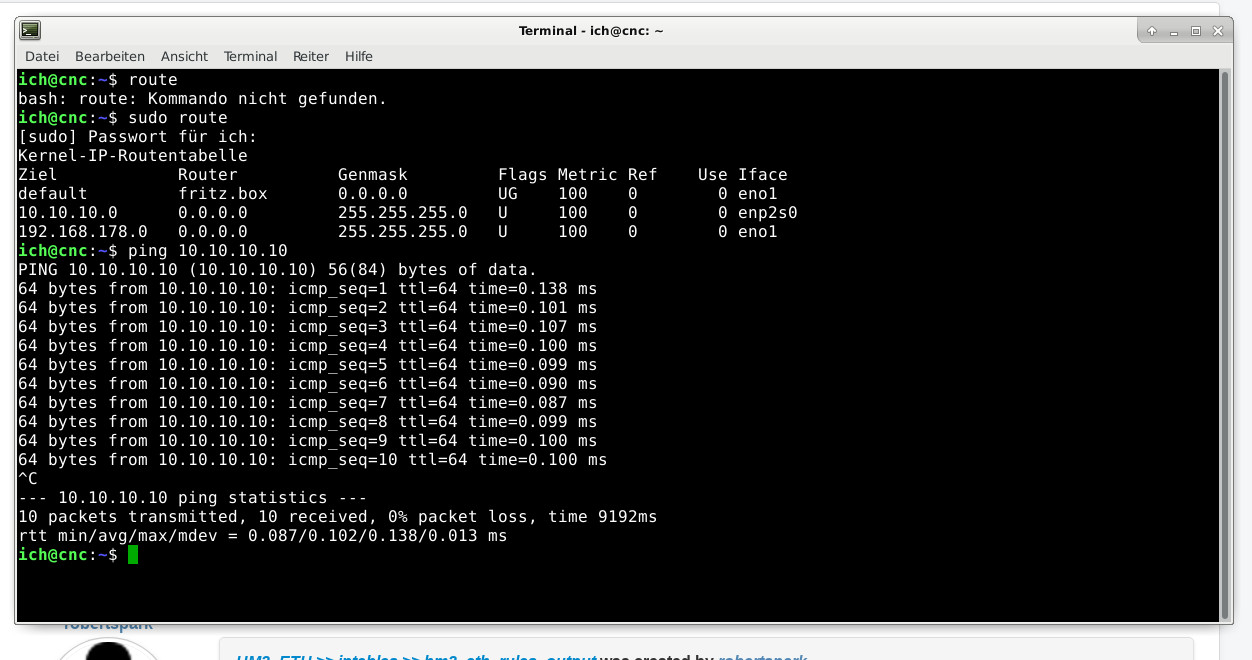

route:
note: I am going to use 2x mesa cards (only 1 is actually networed at present (both have the same issue with the error which I thought was latency) I am intending to use the cards on the same machine with different ini+hal files not at the same time
7i76e + 7i93H
wifi is via a pcie card (ive tried with the card removed and a usb wifi dongle and mo impovement).
just rerunning the latency now, will post shortly
Kernel IP routing table
Destination Gateway Genmask Flags Metric Ref Use Iface
default nowtvhub.Home 0.0.0.0 UG 600 0 0 wlp4s0
10.10.10.0 0.0.0.0 255.255.255.0 U 0 0 0 enp2s0
172.16.0.0 0.0.0.0 255.255.255.0 U 0 0 0 enp3s0
192.168.0.0 0.0.0.0 255.255.255.0 U 600 0 0 wlp4s0note: I am going to use 2x mesa cards (only 1 is actually networed at present (both have the same issue with the error which I thought was latency) I am intending to use the cards on the same machine with different ini+hal files not at the same time

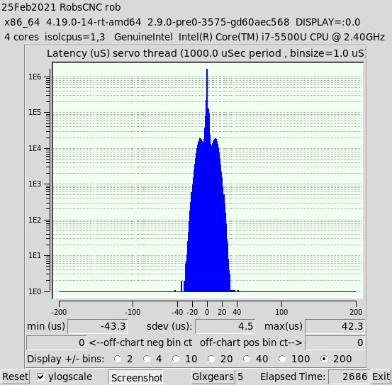

5x glxgears using :
latency-histogram --nobase --sbinsize 1000 --showPlease Log in or Create an account to join the conversation.

Replied by tommylight on topic HM2_ETH >> iptables >> hm2−eth−rules−output
Everything looks fine there, the netmask for the 10.n.n.n should be 255.0.0.0 but i am sure it works like it is.
Latency is OK, no excursions out of the visible window.

running "ping" with Mesa hardware over a short length of network cable (1 to 3 feet / 300mm to 1m)
what sort of times should you be looking at?
I am getting 1.02mS ..... seems a bit long / slow.... but it would be nice to have an idea of what numbers I should be expecting.
( ok.... I am using cat5 outdoor cable over a short length 1 ft / 300mm with 2 X self crimped push through rj45 connectors.... the cable is actually a crossover cable and the ethernet ports use auto MDI-X.....)
I am awaiting a pair of better quality proprietary patch cables to try.....

27 Feb 2021 05:28 #200280
by chris@cnc
Replied by chris@cnc on topic HM2_ETH >> iptables >> hm2−eth−rules−output
The following user(s) said Thank You: robertspark

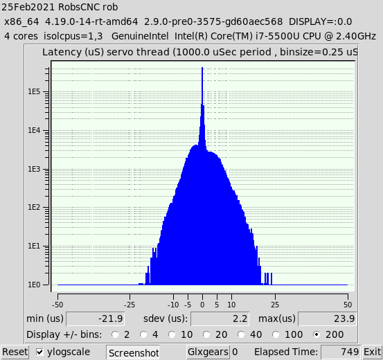

I have been through the bios 10's of time changing settings and retrying. At the moment for linuxcnc the best linuxcnc latency I have is with hyperthreading turned ON, c-states off, EIST / Speedstep off, virtualization off etc, anything ACPI / saving / throttling off, soundcard off etc.
I then used isolcpus=1,3 within grub and I get stable +/- 20 jitter with just running 5x glxgears and surfing the net (not that I intend to do that when machining...., and it rises to +/-50 jitter with youtube running and 5x glxgears
