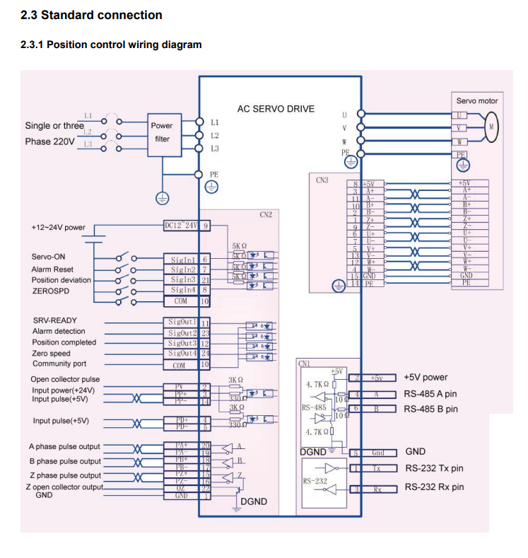

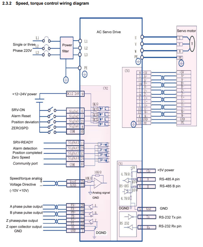

23 Sep 2024 16:41 - 23 Sep 2024 16:46 #310659
by PhilipME
Replied by PhilipME on topic intending to use a servo motor as a spindle with mesa 7i96s
I am glad I finaly got the manual in the attachment
I dont see analog input to the controler
Last edit: 23 Sep 2024 16:46 by PhilipME.
- Posts: 18109
- Thank you received: 5329
23 Sep 2024 17:04 #310661
Replied by PCW on topic intending to use a servo motor as a spindle with mesa 7i96s
The analog input is VREF and AGND (pin 25 and 13)
The following user(s) said Thank You: PhilipME

23 Sep 2024 17:12 #310662
by PhilipME
I will make a wire diagram and post a new thread within 2 to 3 weeks (time permits) before powering.
Many thanks
Philip
