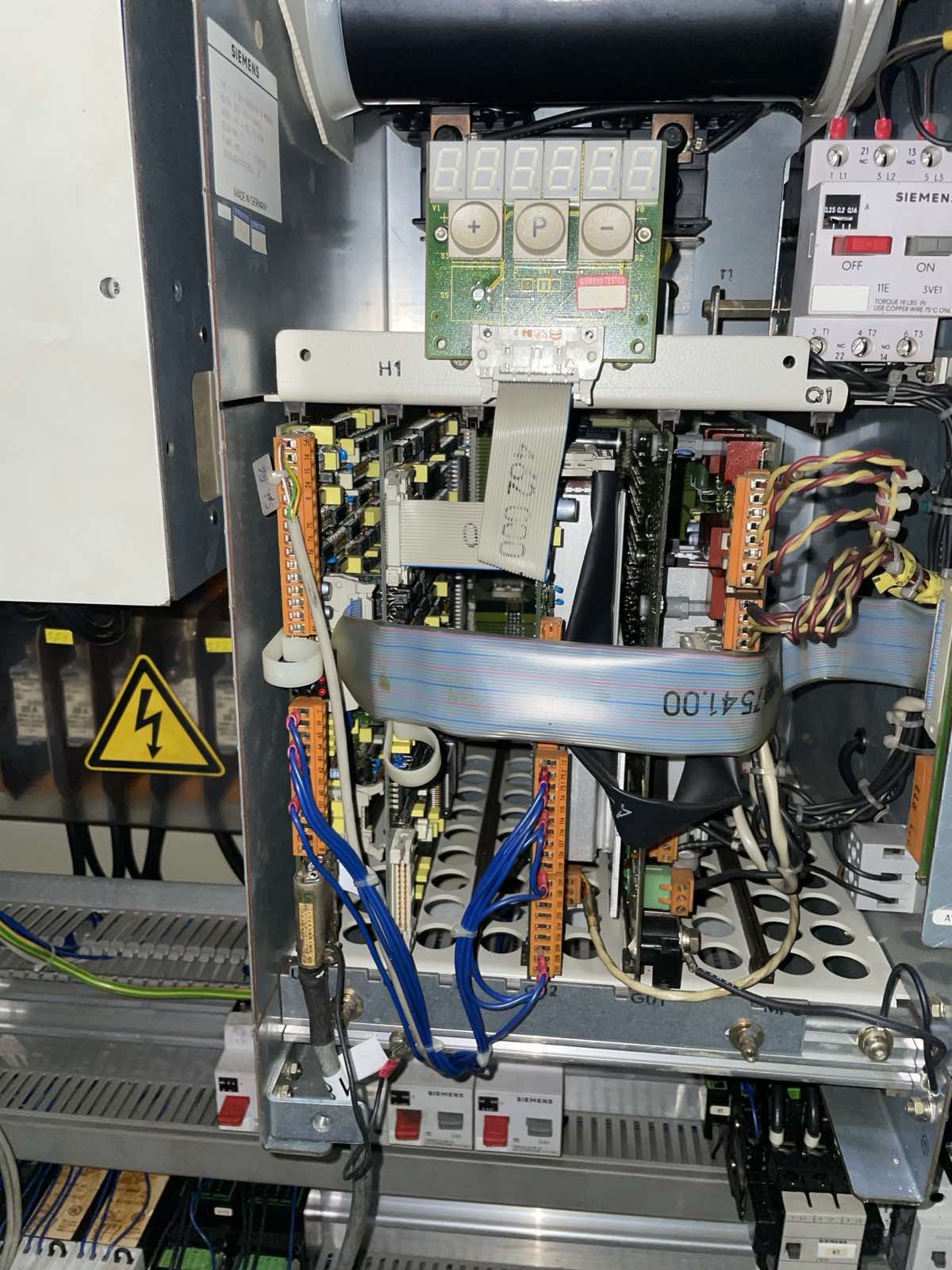

24 Sep 2024 04:54 #310685
by AirRacer
Replied by AirRacer on topic intending to use a servo motor as a spindle with mesa 7i96s
You can wire the 0-10V MESA output through a DPDT relay to the servo controller and wire the REV signal to energize the relay and change the polarity of the 0-10V to the servo controller to reverse the direction.-
