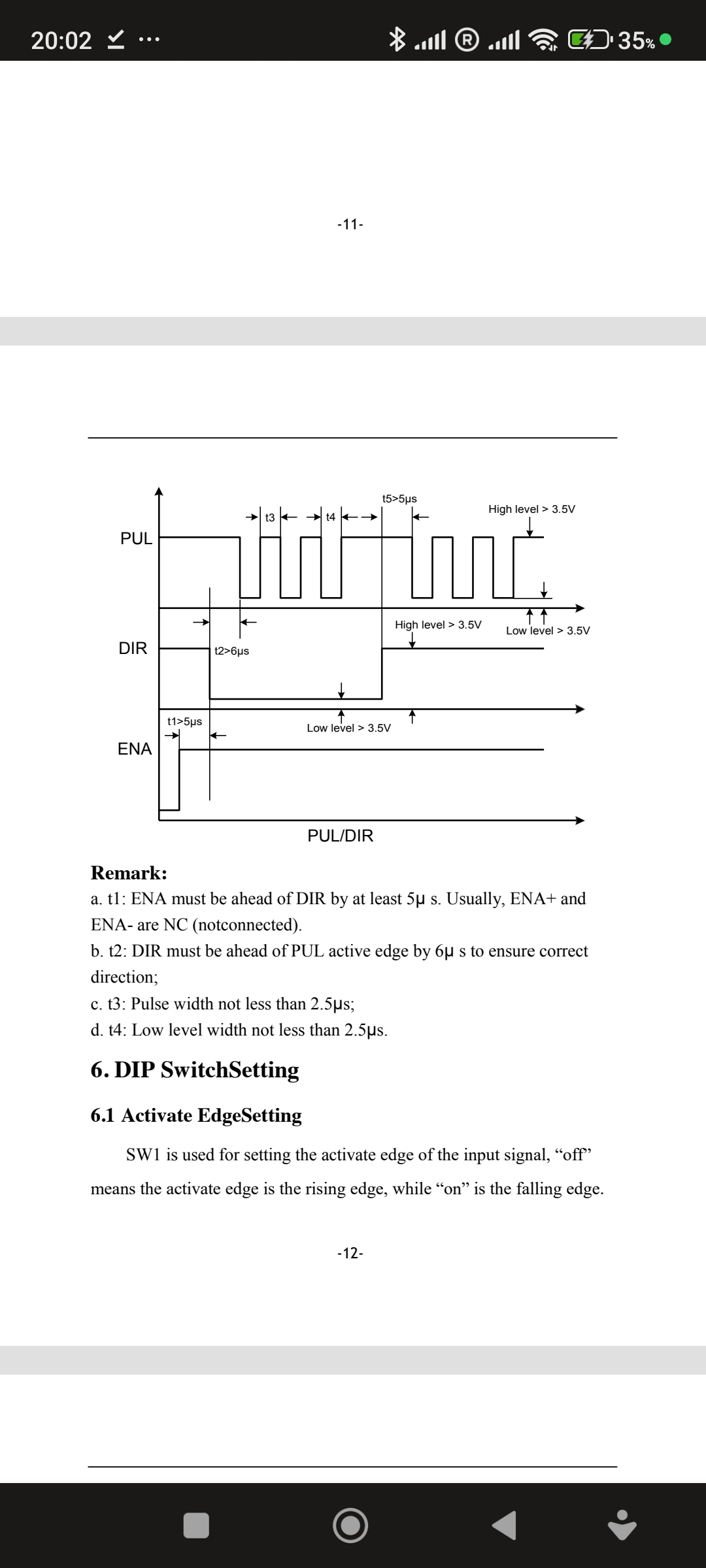

18 Oct 2024 13:15 #312504
by flexbex
Hbs86 stepper timing was created by flexbex

Replied by PCW on topic Hbs86 stepper timing
I would probably leave some margin since those are minimum timings:
Step time 5000 ns
Space time 5000 ns
Dir Setup 10000 ns
Dir hold 10000 ns
Note that the step time and step space
will limit the maximum step rate so you can reduce
these values if needed, but in general it's better to have
more margin.
The direction setup and hold times have no significant
effect on performance so there's no real reason to
not set them to quite large values for any drive.
Step time 5000 ns
Space time 5000 ns
Dir Setup 10000 ns
Dir hold 10000 ns
more margin.
