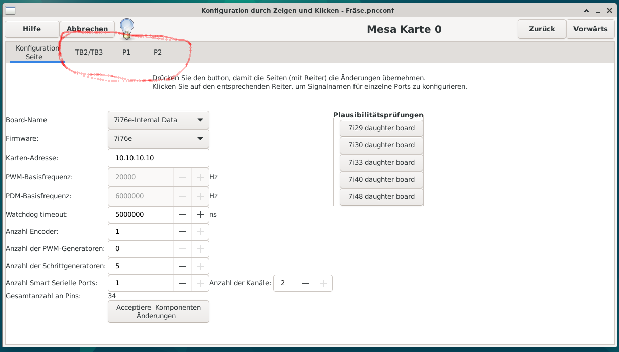

Hello,
iḿ a newbie (from Germany) and i just build a new mill. Now I want to configure my Mesa 7i76e. However, I can't get TB5 and TB6 to activate. Just TB2/TB3, P1 and P2 are visible.
Please help
Please help

I _think_ that the tabs activate once you press "accept changes" at the bottom?

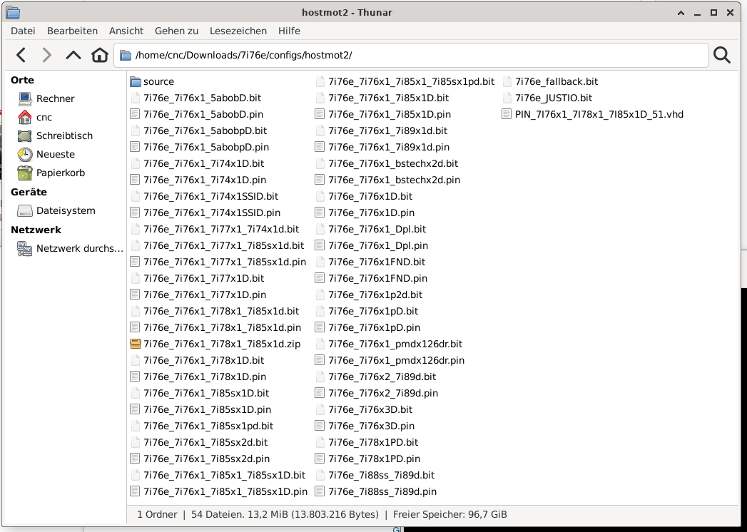

No, maybe the wrong firmware? See attached file

Probably locale setting issues, so set the locale to en_US and UTF-8 and try again.
sudo dpkg-reconfigure localesPlease Log in or Create an account to join the conversation.

Yes, that was the problem. Thanks
