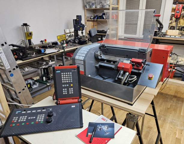

15 Dec 2025 19:53 - 15 Dec 2025 19:59 #340140
by jaro_p
Replied by jaro_p on topic Changes in configuration files generated in pncconfig for 7i76 to 7i78
[/attachment]
I know that there is a configuration 7c81_7i78x2d.bit, but there is the same on P2 as on P1 - 7i78. Another 4 axes. And I don't need that for the lathe. But I would like one MPG encoder for each axis - basically to be able to control the lathe "almost" manually. The rest of P2 controls the tool turret and on P7 there are limit switches and buttons.
So that's the goal.
So that's the goal.
Last edit: 15 Dec 2025 19:59 by jaro_p.

16 Dec 2025 00:32 #340158
Replied by PCW on topic Changes in configuration files generated in pncconfig for 7i76 to 7i78
7C81 configuration for 7I78 on P1, INM on first 12 P2 pins
The inm module supports up to 4 MPG encoders,
it also has built in input filtering/debouncing.
The last 5 P2 pins are left as GPIO so can be inputs/outputs
as needed
as needed
The following user(s) said Thank You: jaro_p
