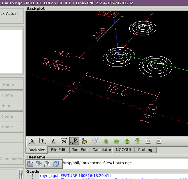

17 Jun 2016 03:59 #76196 by phillc54
Thanks for checking this for me.
In my setup I didn't have a GCMC script as a NGCGUI_SUBFILE in the ini file so after looking at your results I added one and observed the following:
If I add any GCMC script as a NGCGUI_SUBFILE in the ini file it works.
If I don't have a GCMC script as a NGCGUI_SUBFILE in the in file it errors as described previously.
Omitting any or all NGC files as a NGCGUI_SUBFILE in the ini file makes no difference at all.
So all I need to do is leave at least one GCMC script as a NGCGUI_SUBFILE in the ini file. :)
17 Jun 2016 14:59 #76223 by dgarrett
This was a bug, should be fixed for next 2.7 release with this commit:
git.linuxcnc.org/gitweb?p=linuxcnc.git;a...08d624f52e292497b34b
Thanks for the bug report.
Nice work on your custom gui !
