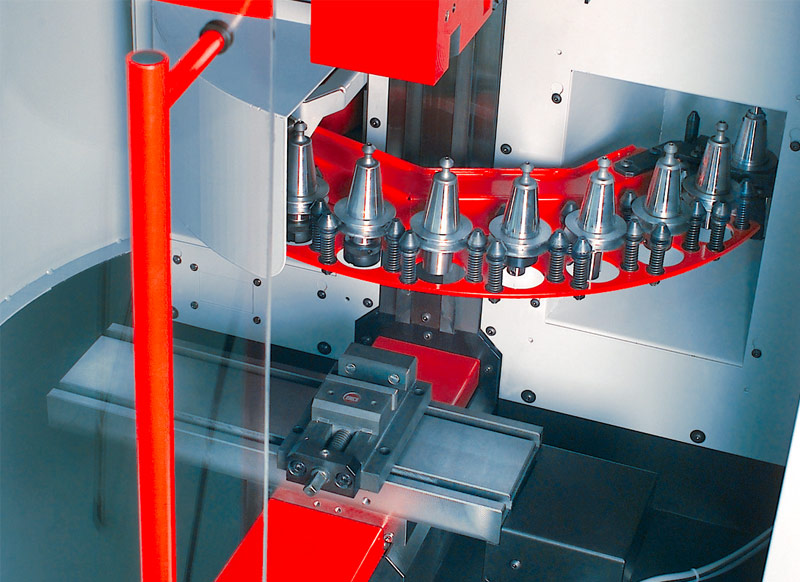

Hello,
Could you please help me with my tool changer, my machine is cnc endmill emco 55 pcmill. I am using Carousel Component with counts mode, since I have a stepper motor on the tool changer.I also have a sensor that connected to sens-0 (index)at this point I can move and home the car, I can also do the tool changes.the last thing that I need to do is move the carousel back home once the tool has been changed. How can I move the car back to home with a subroutine?My tool changer does not have an arm that I can control.

Well, one thing I can tell you is that I never imagined that a toolchanger like that existed when I created the carousel component
It's a neat idea, actually, I quite like the design.
You could maybe set the carousel.0.rev-pulse to some value, but to be honest I don't think that would work properly, as it assumes that the motor is allowed to slip against a hard stop, and that's not going to work in counts mode.
I think that one way to do what you want would be to add a mux2 to switch the velocity command.
Change
Then set up (and tune) the PID to park the changer and hold it there.
A better option might be to modify the carousel.comp to add an extra park state in the state machine. Do you have any familiarity with C code?

Alternatively this might be one case where it makes sense to define the toolchanger as an axis and drive it from pure G-code.

Hi Andy,
I have been working on this ATC over 3 moths now. So far I released the magic smoke of two mesa cards, but the retrofit must continue.
Thank you for creating this component, It has tough me a lot in regards how linuxcnc and a CNC machine works.
It does makes more sense driving the ATC with G-code.
I discarded this idea, because you mention that carousel component was not designed to be used as an axis.
I guess we can scratch that lol
How would you go about it driving the ATC with G-code?
would you have a bunch of if statements?
for example:
if M6T1 then G53 G0 A2 (and the rest of the operations)
if M6T2 then G53 G0 A3 (and the rest of the operations)
Would I have to update the iocontrol with G-code every time the tool changes?

To do it all with G-code you would remove the carousel.comp from the system. It's not really helping if you define the changer as an axis.
(Note that you _could_ define the changer as an "extrajoint" if you really wanted to not have a spurious A axis appear in the GUI, but that's a topic for another day).
Your remapped toolchange routine has access to a set of built-in variables:http://linuxcnc.org/docs/stable/html/gcode/overview.html#gcode:predefined-named-parameters
Your routine could use #<_selected_pocket>
So, your toolchamge.ngc would be something like
There is no tool unload in this routine, so it won't work as-is. But is illustrates the idea. It's a lot like the rack-toolchanger example in the sim configs.

G0 Z0 ; retract spindle
G1 F20 A#<_selected_pocket> ; Potentially mutiplied by a scaling factor
G1 F100 Z -65 ; Or whatever the tool change position is
M62 P0 ; clamp the tool
M66 P1 ; Wait for tool-clamped signal
G1 F100 Z0 ; retract spindle
G1 F20 A0 ; retract tool changerThere is no tool unload in this routine, so it won't work as-is. But is illustrates the idea. It's a lot like the rack-toolchanger example in the sim configs.
