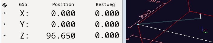

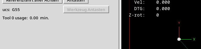

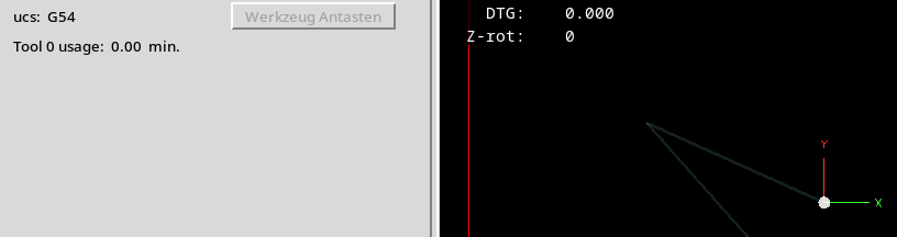

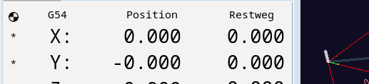

26 Dec 2025 21:51 #340547
by tlightus
Replied by tlightus on topic calling subroutine from G54, G55, G56, but it acts weird
sorry if this is the wrong place to post this but it seemed appropriate.
i think i found a bug with subroutine calls
Conditions:
set up a pyvcp button to call an MDI_COMMAND
Set fixgure offsets for G54, G55
remain in G55 X0 Y0 and issue:
MDI_COMMAND = G0 G90 G54 X0 Y0
and that will work fine
Go back to G55 active offset at X0 Y0 and change the command to call a subroutine
MDI_COMMAND = o<work_zero> call
will fail not executing the subroutine command and sit at G55 zero
i tested this in both axis and flexgui with the exact same results
####### SUBROUTINE #######
o<work_zero> sub
G90 G54 G0 X0 Y0
o<work_zero> endsub
m2
if you are still in G55 at X0 Y0 and issue
G0 G90 G54 X0 Y0 from the mdi command line it will go to G54 X0 Y0 also

26 Dec 2025 23:32 #340557
by MaHa
Replied by MaHa on topic calling subroutine from G54, G55, G56, but it acts weird
- tlightus
- Posts: 21
- Thank you received: 19
26 Dec 2025 23:59 #340559
by tlightus
thank you for testing. i have been getting a very different result but will go back and see if it was something i was doing wrong.
- tlightus
- Posts: 21
27 Dec 2025 16:33 #340586
by tlightus
i did notice you use machine zero as the G54 offset. try setting it off that and run the test.
- MaHa
- Posts: 542
- Thank you received: 241
27 Dec 2025 19:33 #340595
by MaHa
