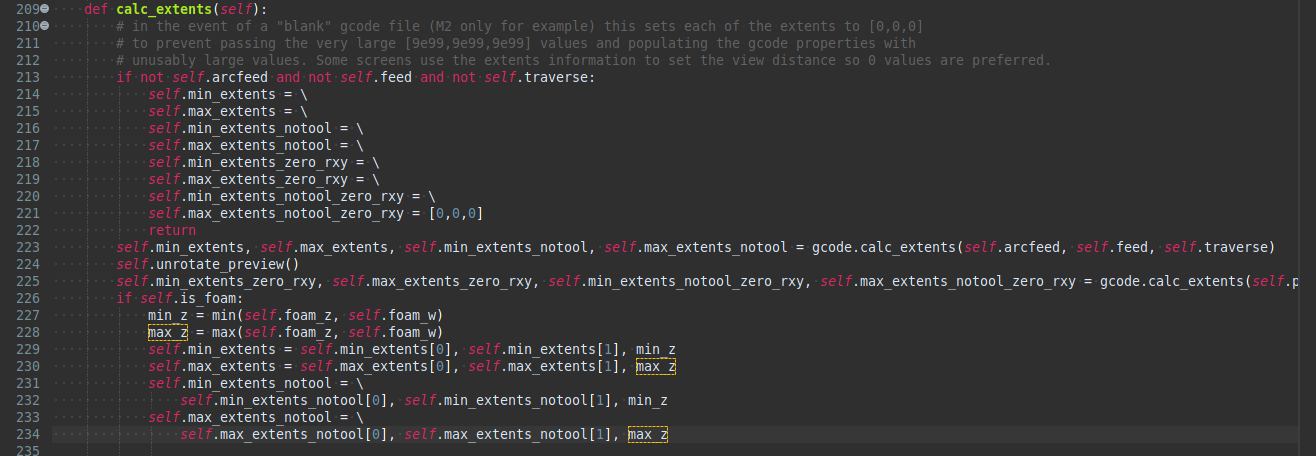

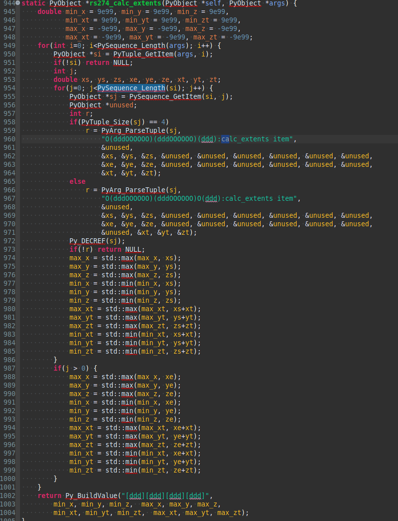

IIRC .parse will run the gcode and create lists of line segments for 'traverse', 'straight_feed' and 'arc_feed' moves while .calc_extents will then find the minimum and maximum coordinates values from those lists.
This is from lib/python/rs274/glcanon.py:
which calls the pyobject in src/emc/rs274ngc/gcodemodule.cc:
