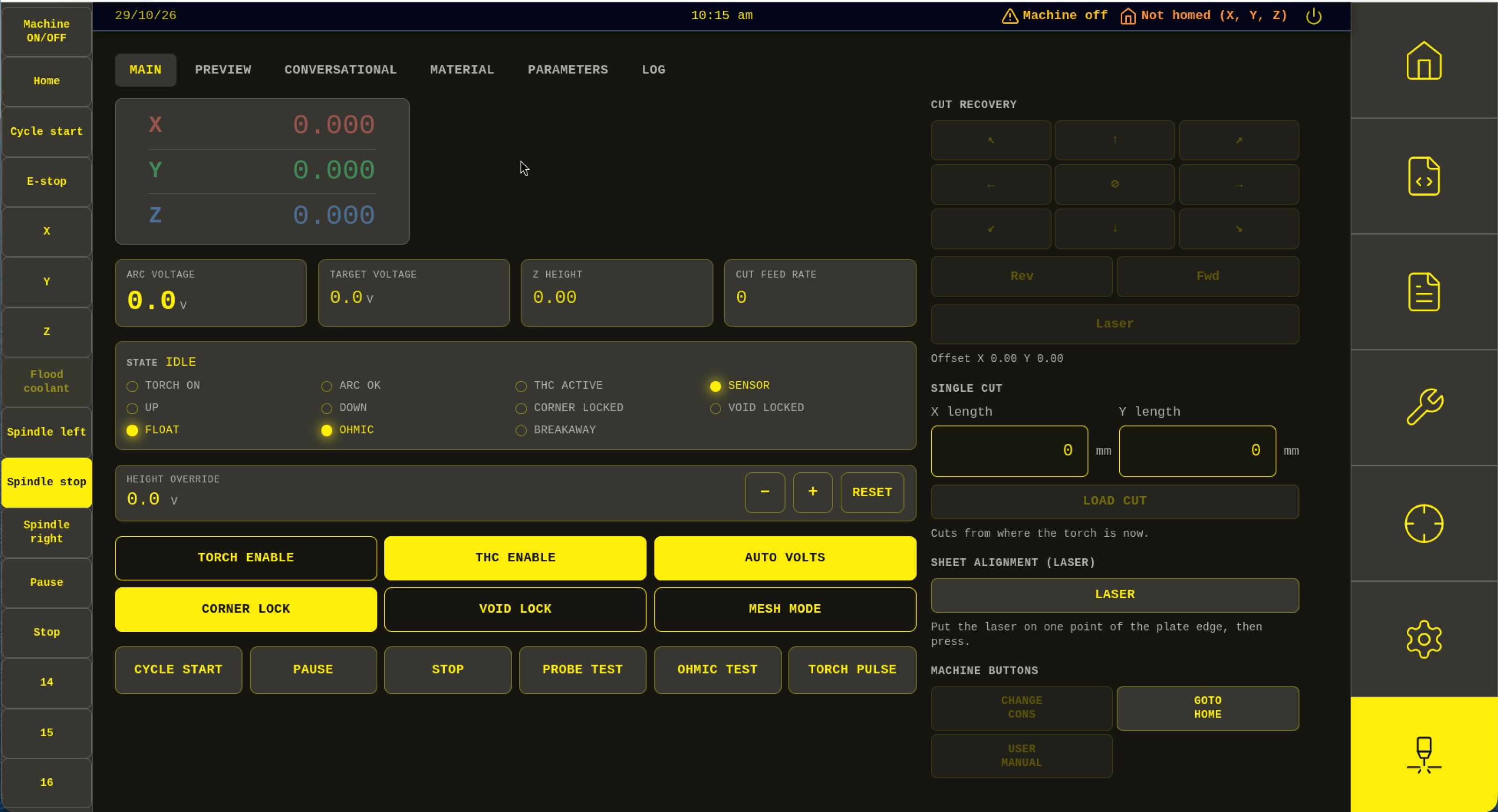

- MAIN — live dashboard: arc voltage, THC state, status LEDs, cut recovery, torch pulse, height override, single cut

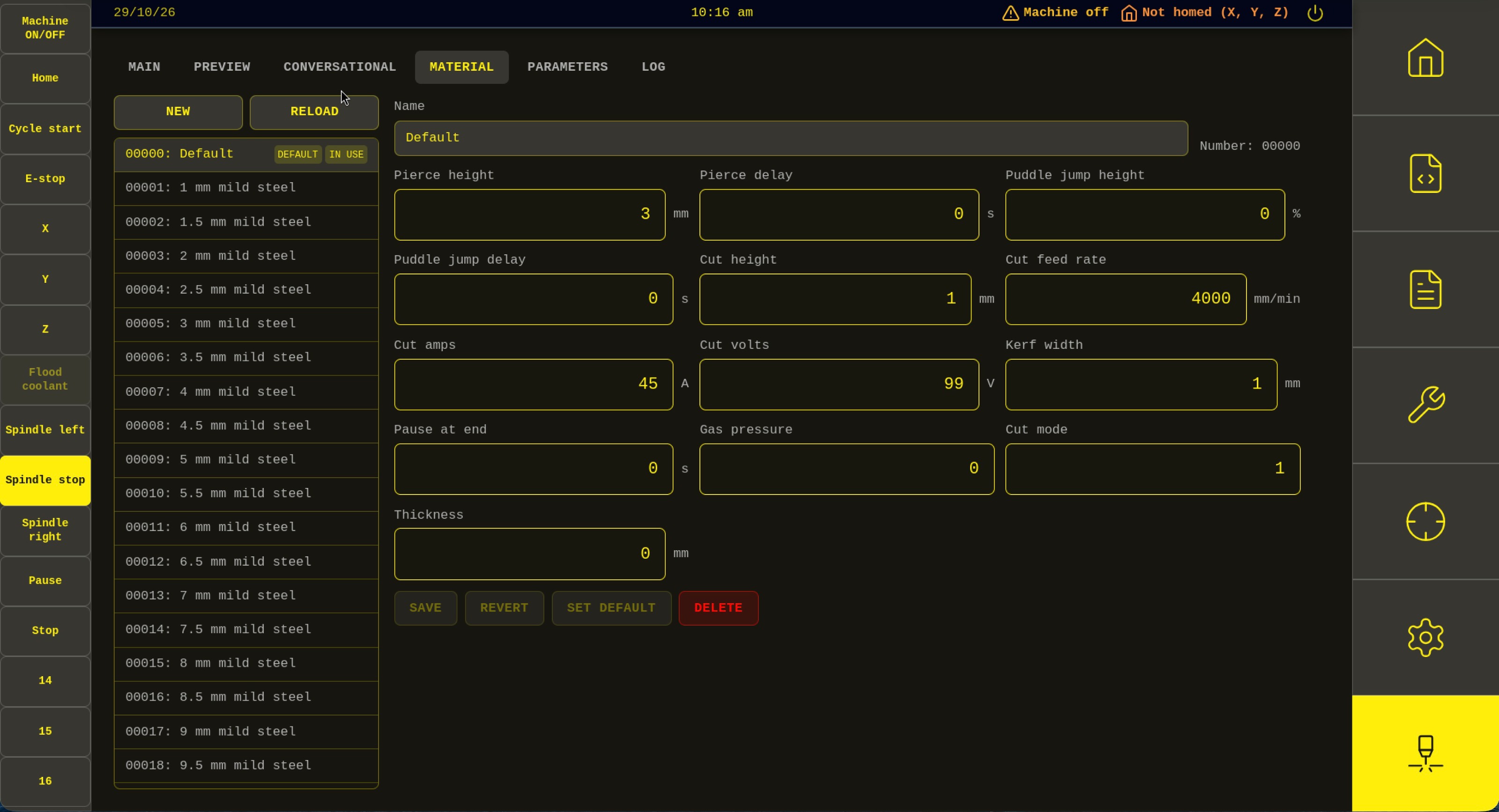

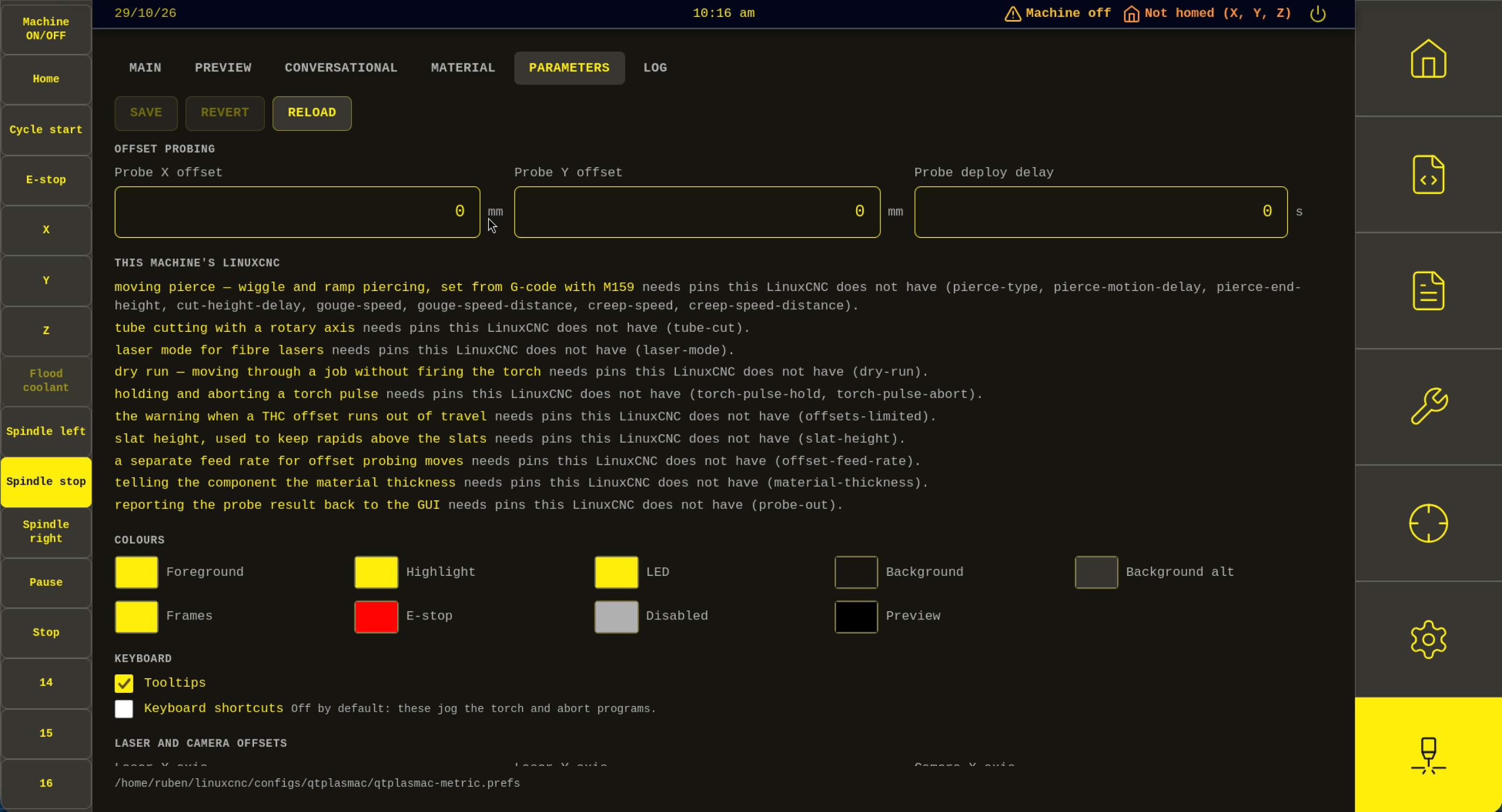

- PARAMETERS — the QtPlasmaC parameters, saved back to your .prefs file, with QtPlasmaC's own tooltips
- MATERIAL — materials from your _material.cfg, including the M190 material-change handshake

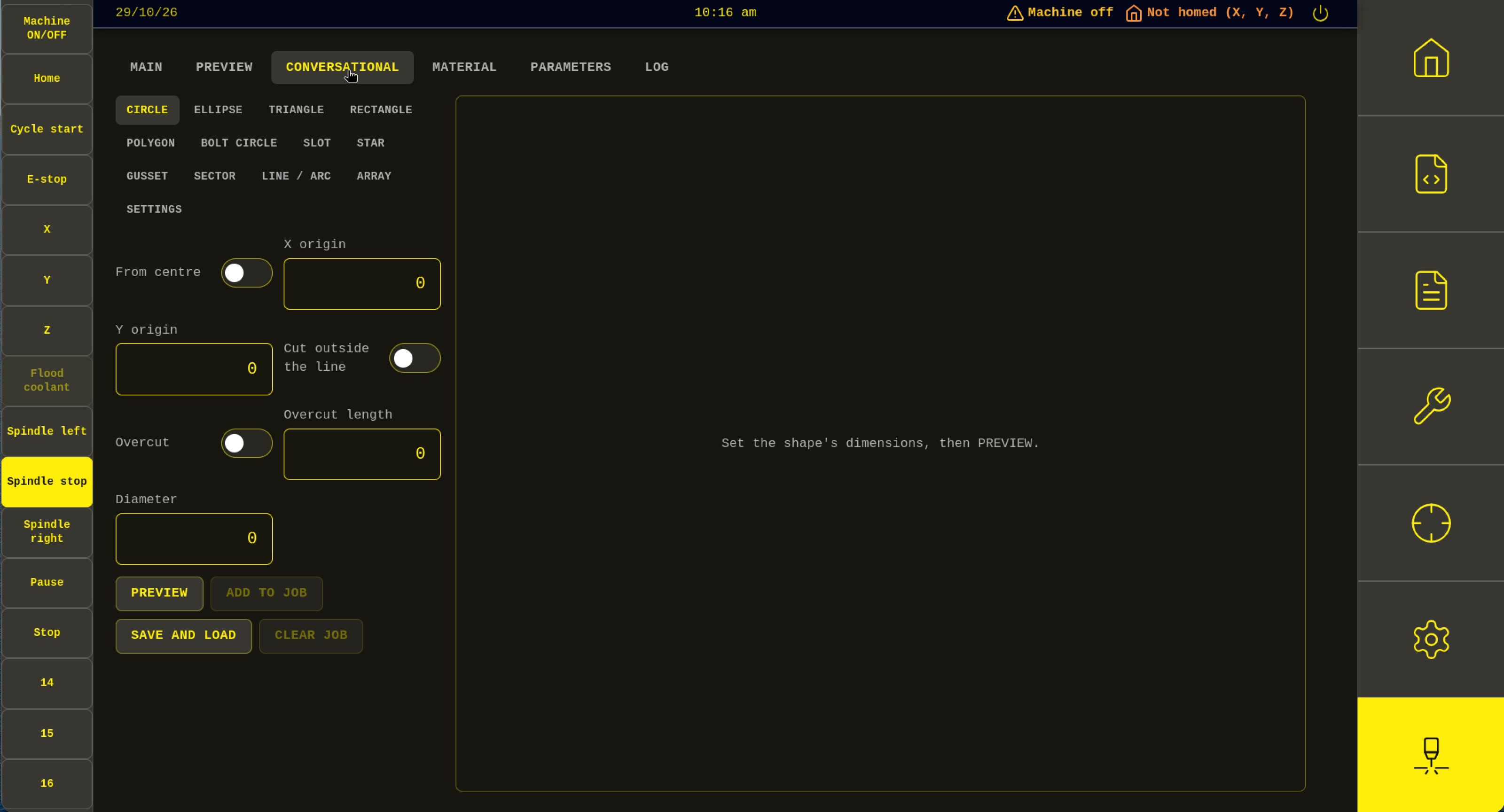

- CONVERSATIONAL — LinuxCNC's own plasmac shape modules, driven from a web form
