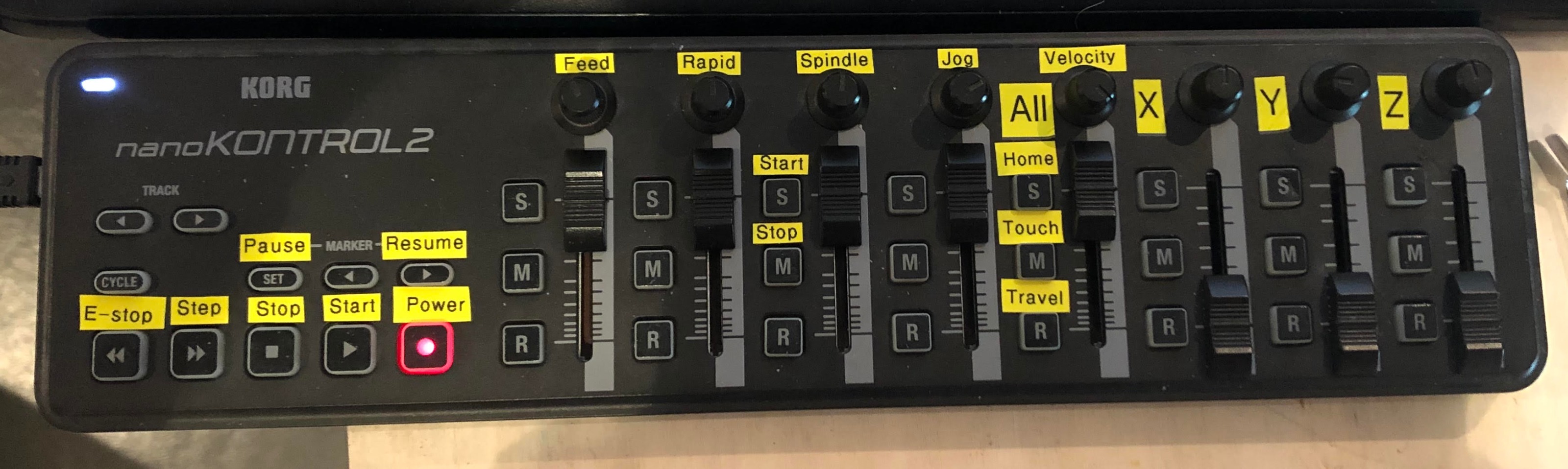

I wanted to share the HAL MIDI module I wrote yesterday, that connects my KORG nanoKONTROL2 MIDI controller with LinuxCNC.
First time I write Python or anything for HAL, so any feedback on that is welcome.
github.com/havard-fjaer/linuxcnc-midi

Dayumn ! That is nice, using music equipment for CNC!
Thank you.
Video ?

Hey that's cool and innovative way to find a control panel!
