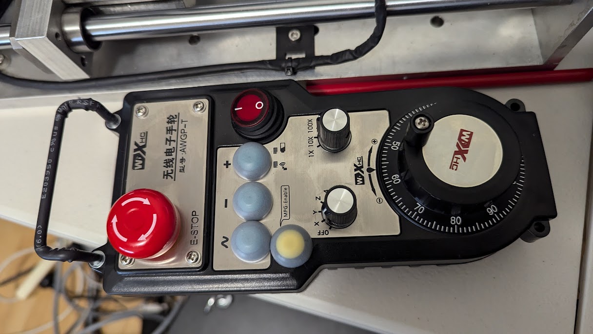

I agree this is complicated. Recently I got this hardwired pendant going.
The MPG, axis select and scale selectors are well described in the docs (requires small mods for a mesa MPG) linuxcnc.org/docs/stable/html/examples/mpg.html
Getting high and low speed button jogging working (selected by holding the ~ button down) proved so complicated, I resorted to writing a custom component
