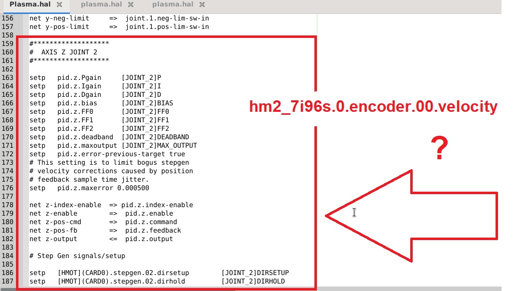

I am retrofitting a machine, where I need to control the precise movement of the Z axis, I am using the feedback from the THCAD2 electronic board to transform the signal from the analog ruler from 0 to 10 v into frequency, the frequency is being read by the 7i96s board, the speed information hm2_7i96s.0.encoder.00.velocity appears. How do I configure the connection in the HAL file to recognize this signal as a Z axis position encoder? Please, if you have any examples, I appreciate it.

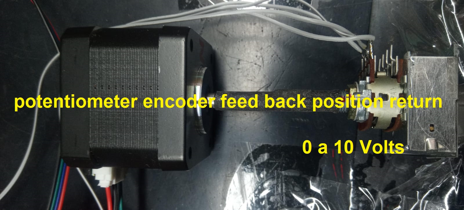

In this image, we have a stepper motor connected to the shaft with a potentiometer that provides a voltage of 0 to 10 volts to simulate what will happen in the machine.

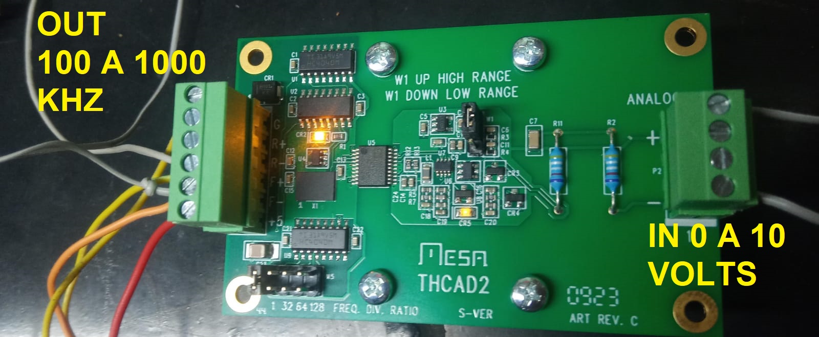

In this image, we have a THCAD2 electronic board that receives 0 to 10v from the potentiometer and converts it into a frequency of 100 to 1000 KHZ

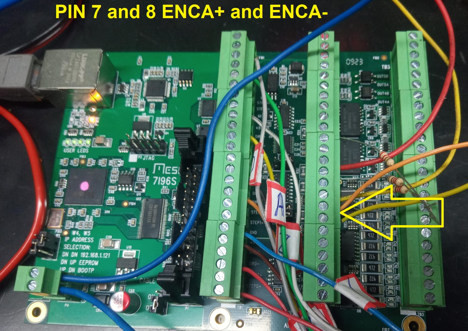

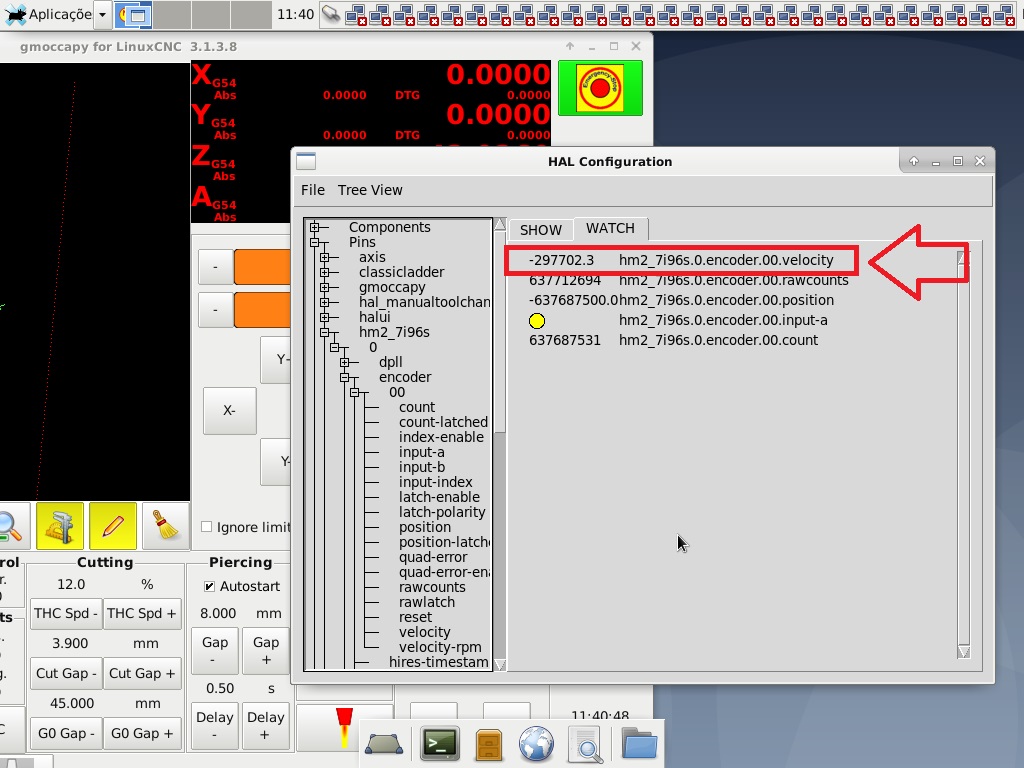

In this image, we have a 7i96s electronic board that receives only one signal A in ENCA+ and ENCA+ from 100 to 1000KHZ
It seems to me that only the hm2_7i96s.0.encoder.00.velocity signal is usable to inform the position. Because the other signs are always counting and adding infinitely regardless of the movements.
I didn't find any example on the internet to apply this hm2_7i96s.0.encoder.00.velocity signal in Z position return position setting, please, can someone help me with example?

You would use the encoder velocity as the joint feedback source for the joint used for the Z Axis
Basically, if you make a configuration (using pncconf or MesaCT) with Z being a
normal step/dir axis, you would replace the feedback coming from the stepgen
with the encoder velocity. What drives the Z axis?
Note that you need to scale the encoder velocity so it reads in machine units.
In addition, you will likely need to offset the reading
(perhaps using the scale or offset components)
The encoder scale will probably be a large negative
number, I can give you the math for this later. just stepping out

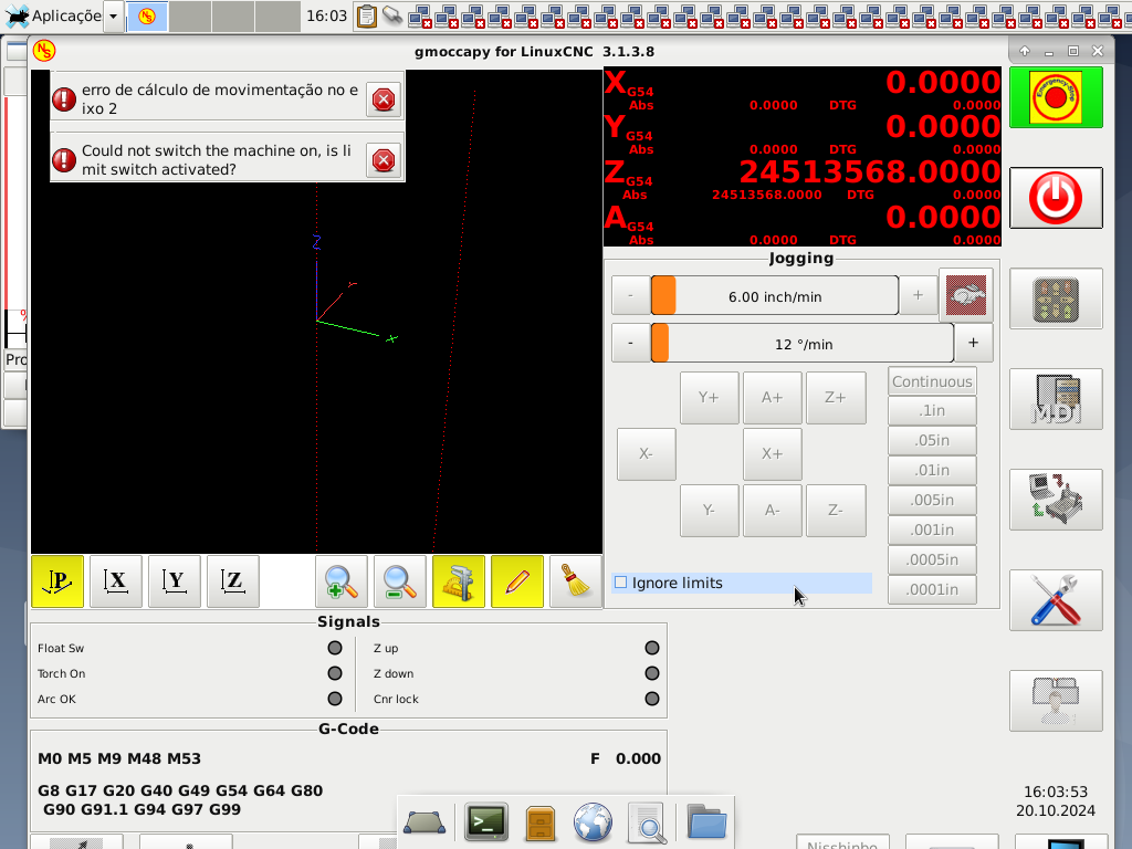

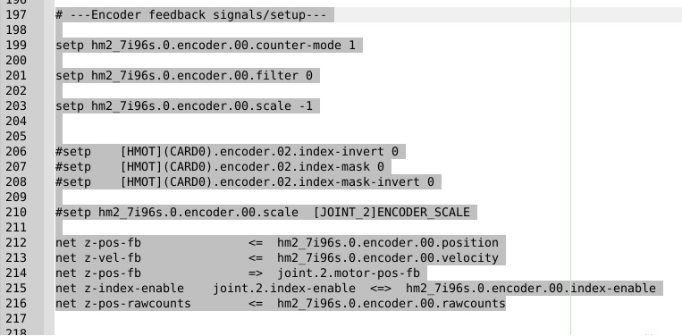

I used (pncconf) to get some sample code to apply to the project. The code looked like this:
The frequency reading is appearing on the panel, but when trying to move it, this Z-axis movement calculation error appears:
Please, how should I proceed? What alternative and configuration for this?

One obvious change is that the Z axis feedback must come from the encoder velocity
(= scaled THCAD2 frequency)
net z-pos-fb hm2_7i96s.0.encoder.velocty

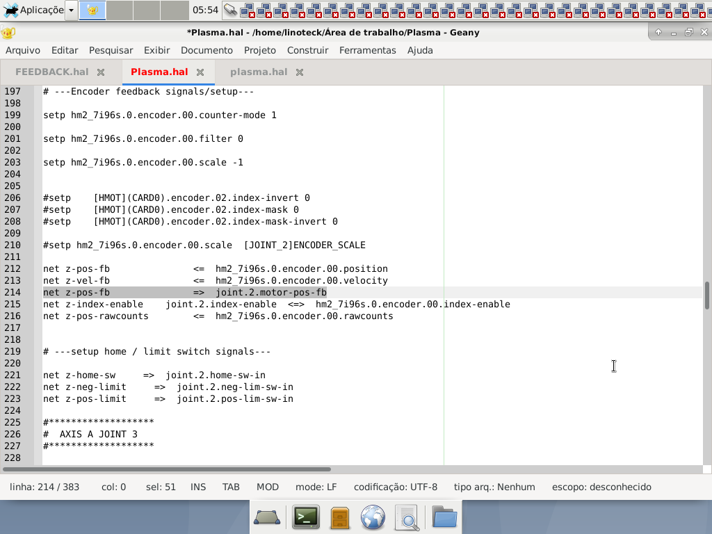

21 Oct 2024 04:06 - 21 Oct 2024 06:29 #312725
by programador
Replied by programador on topic How to configure THCAD2 encoder on Z axis on 7i96s board?
Good morning Master PCW
I made the suggested change and it was not successful, an error appears, can you please help me?

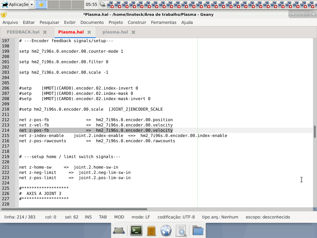

The image below is before changing the line 214
The image below is after changing line 214

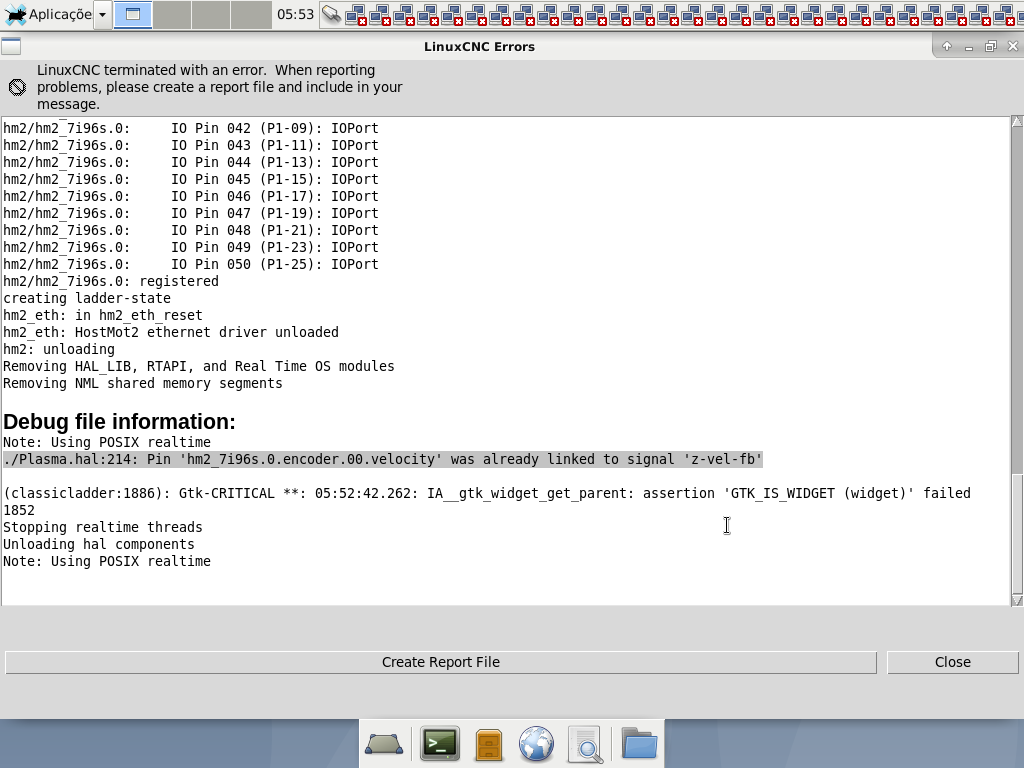

The image below is the error reported after the change
Attached are the error and hal configuration files
Please, can you help me?
