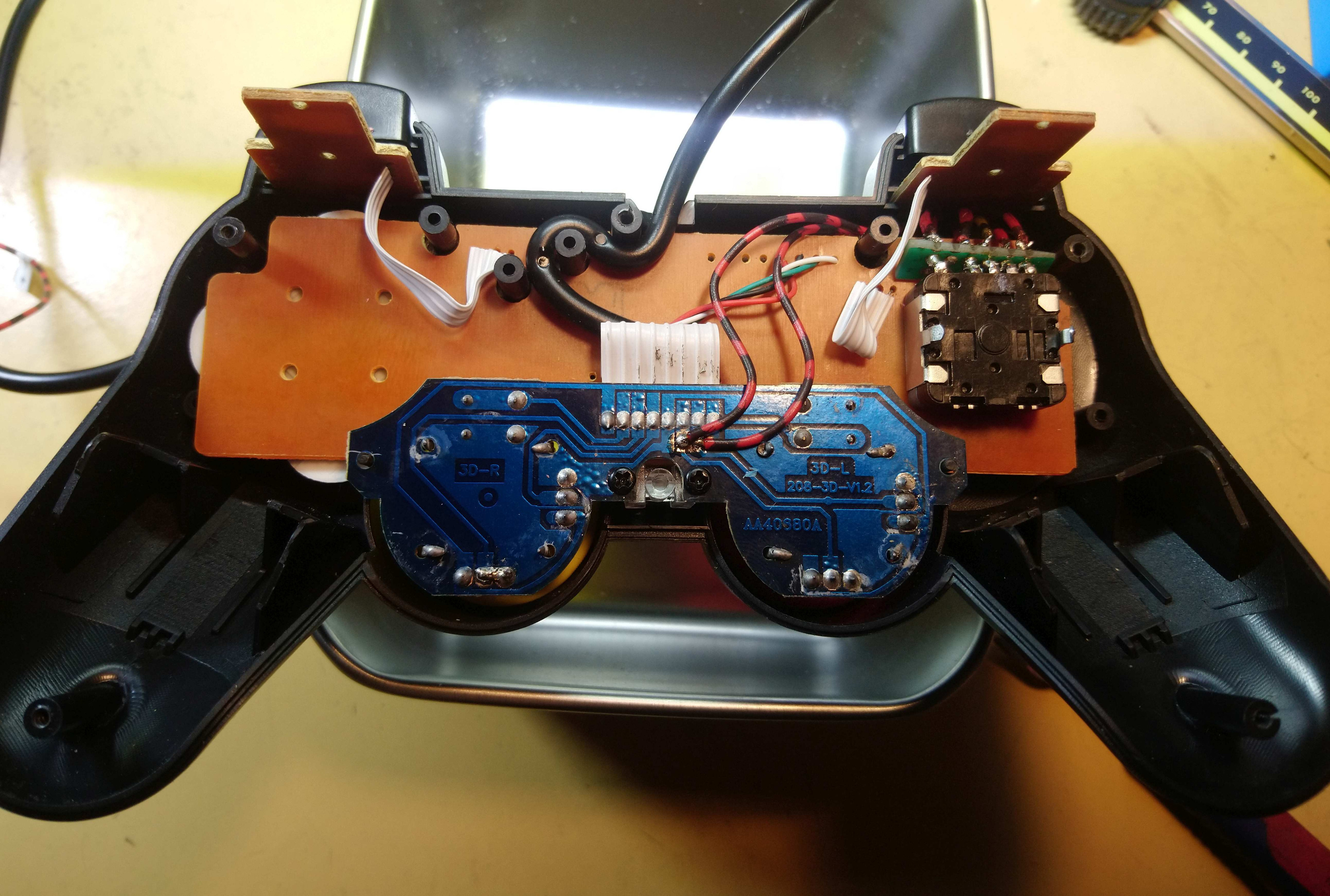

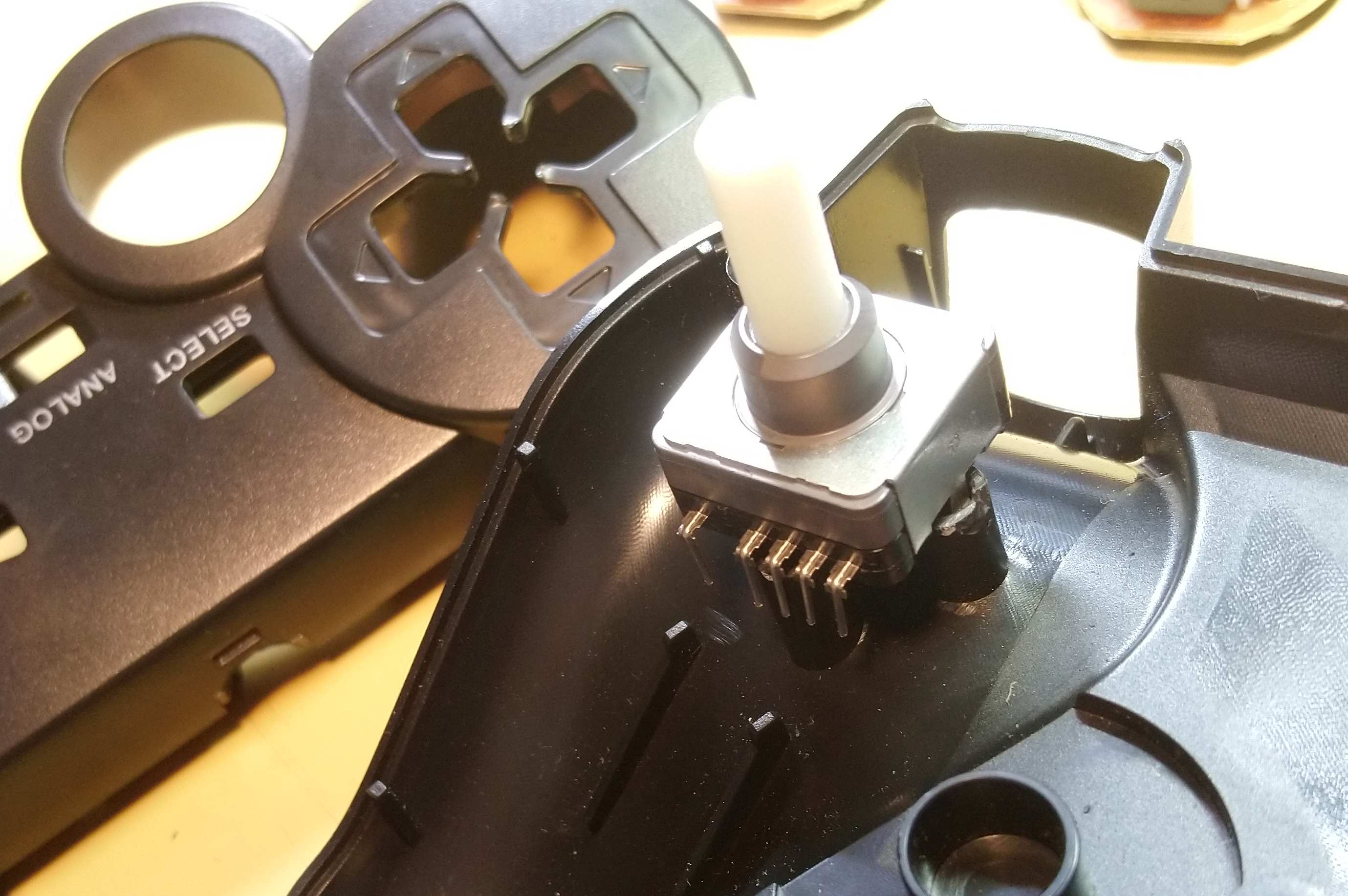

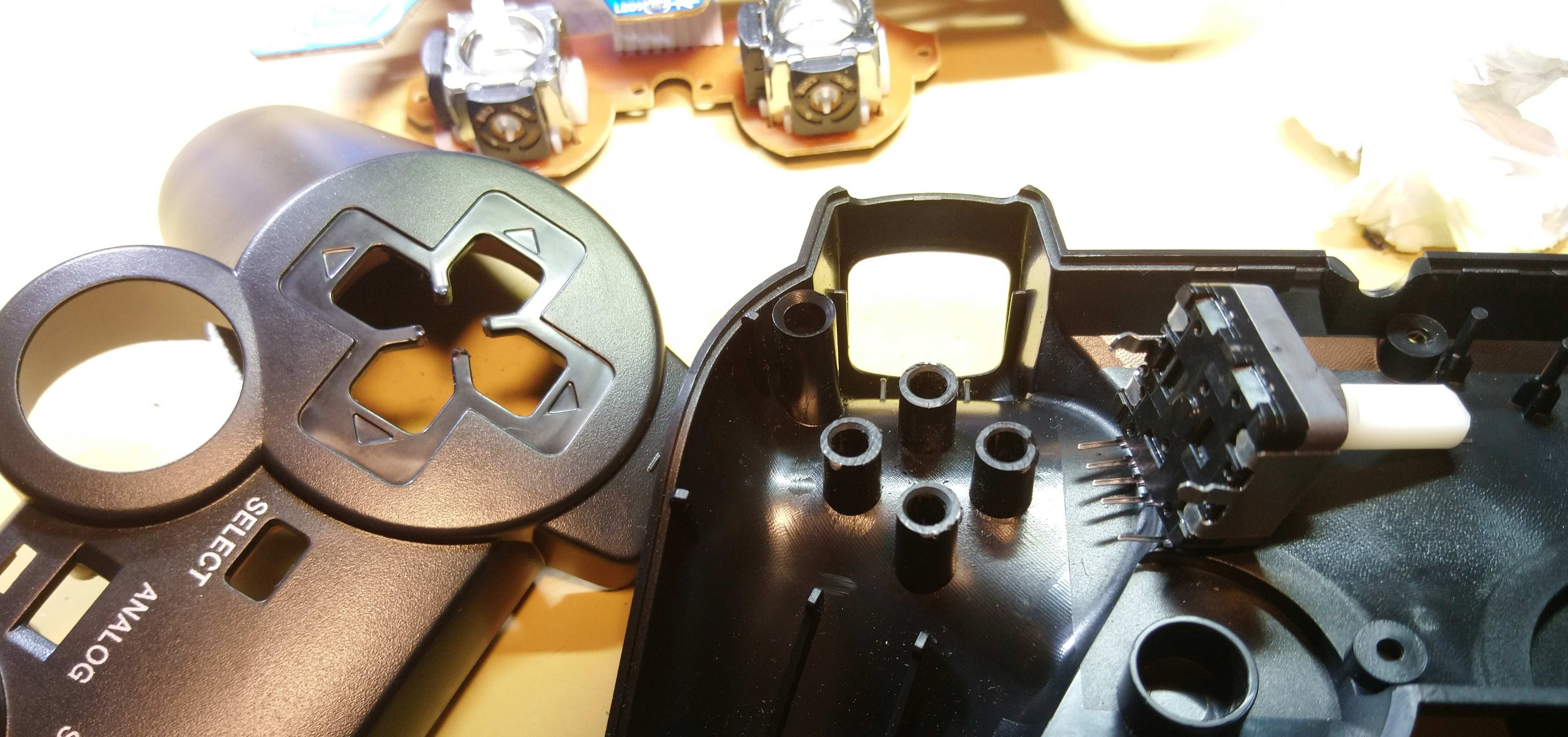

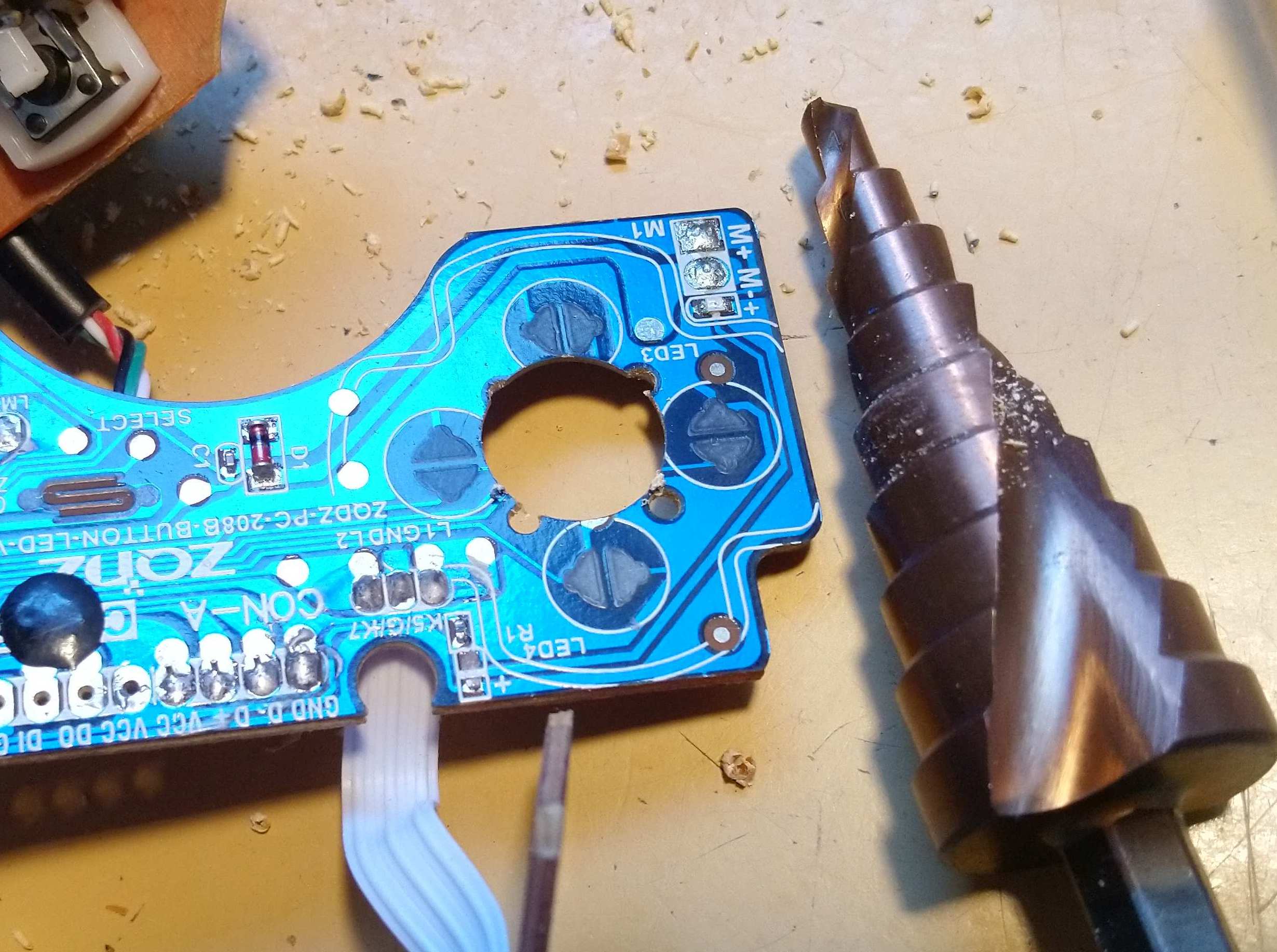

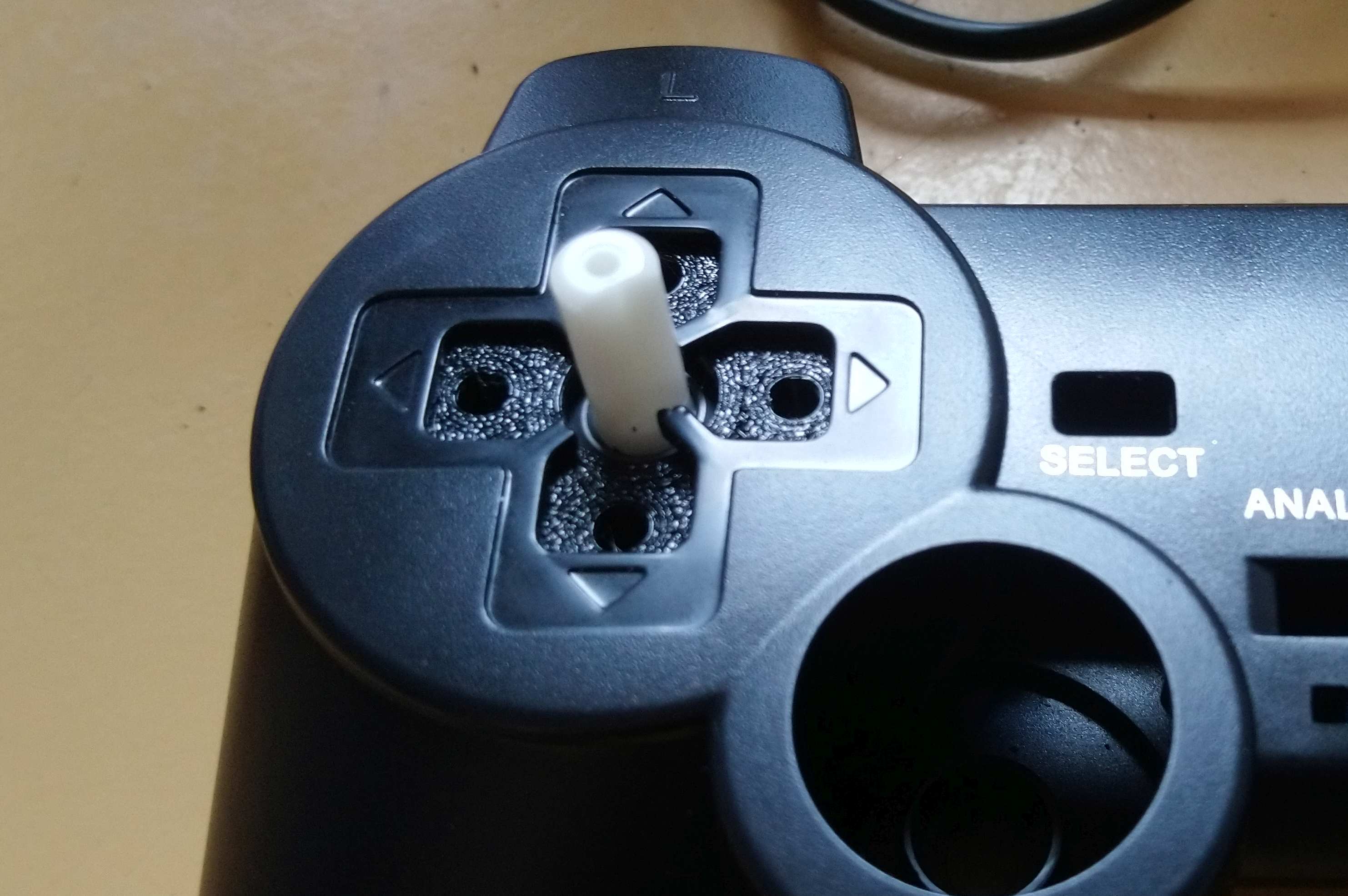

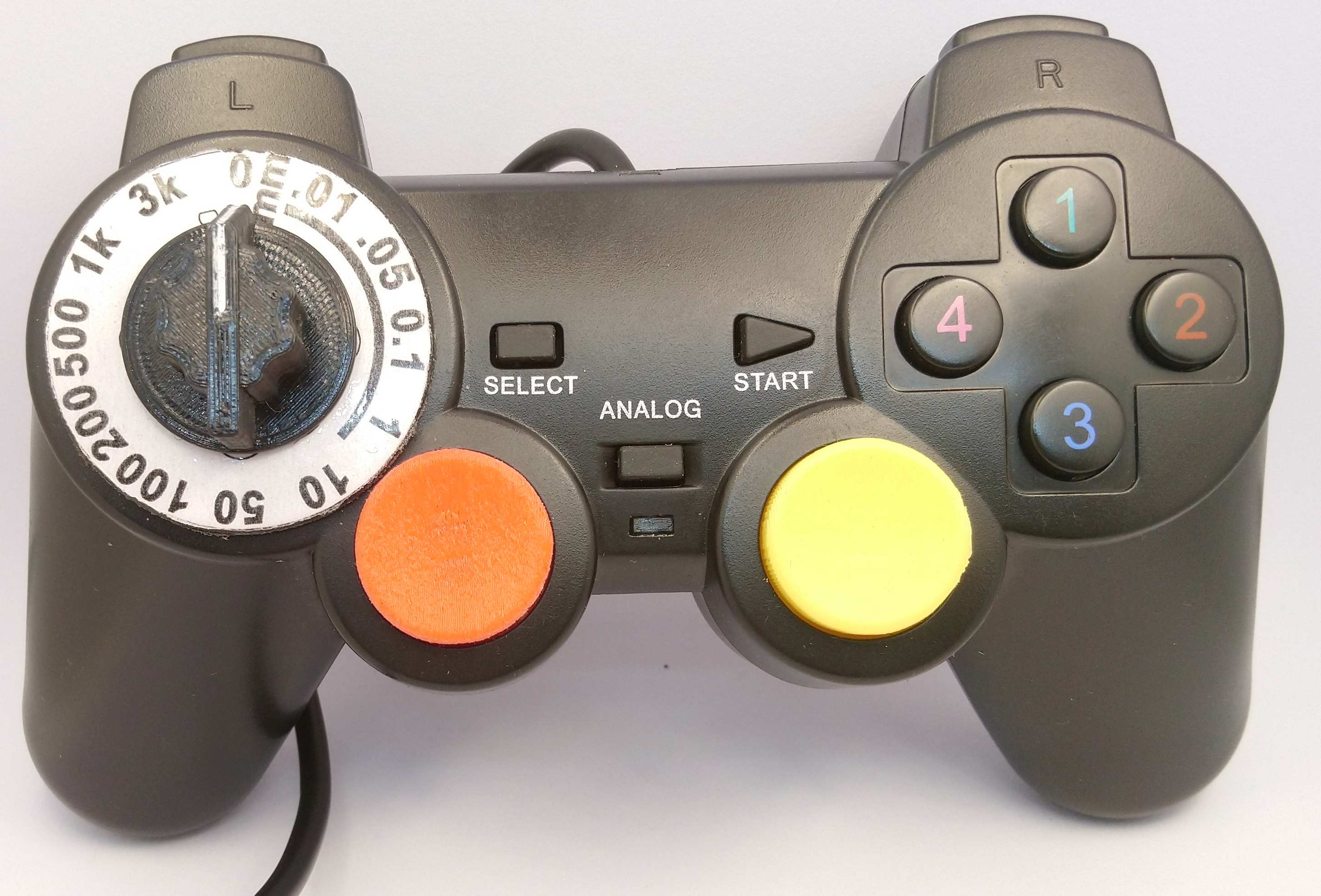

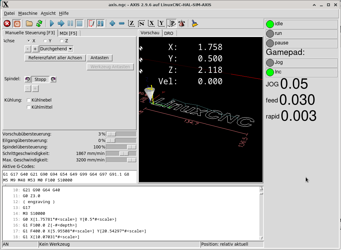

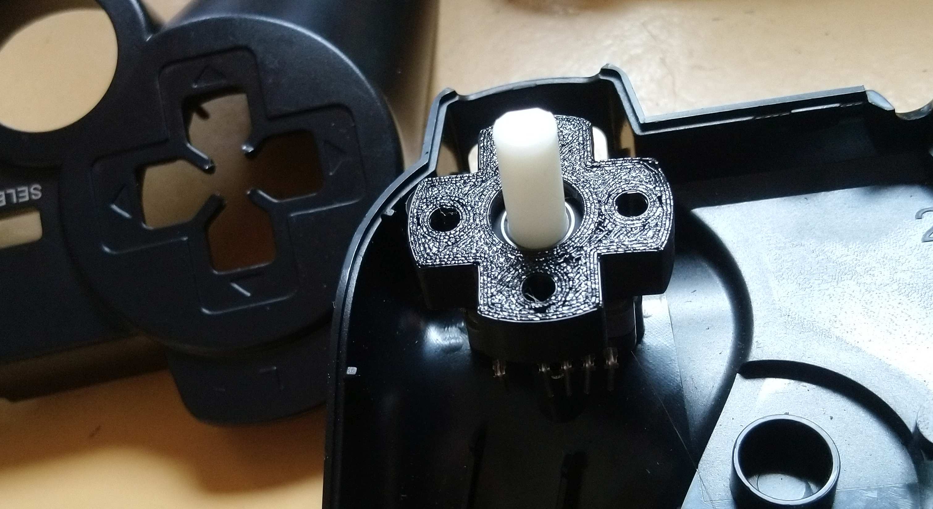

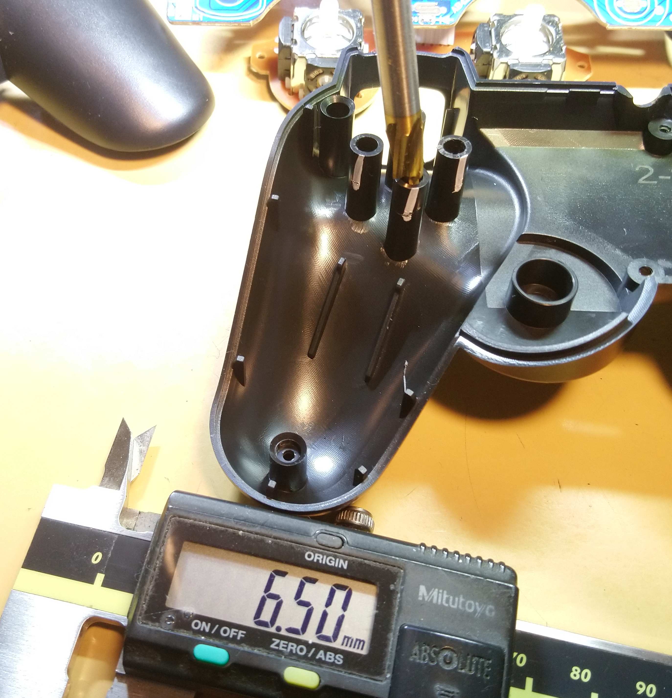

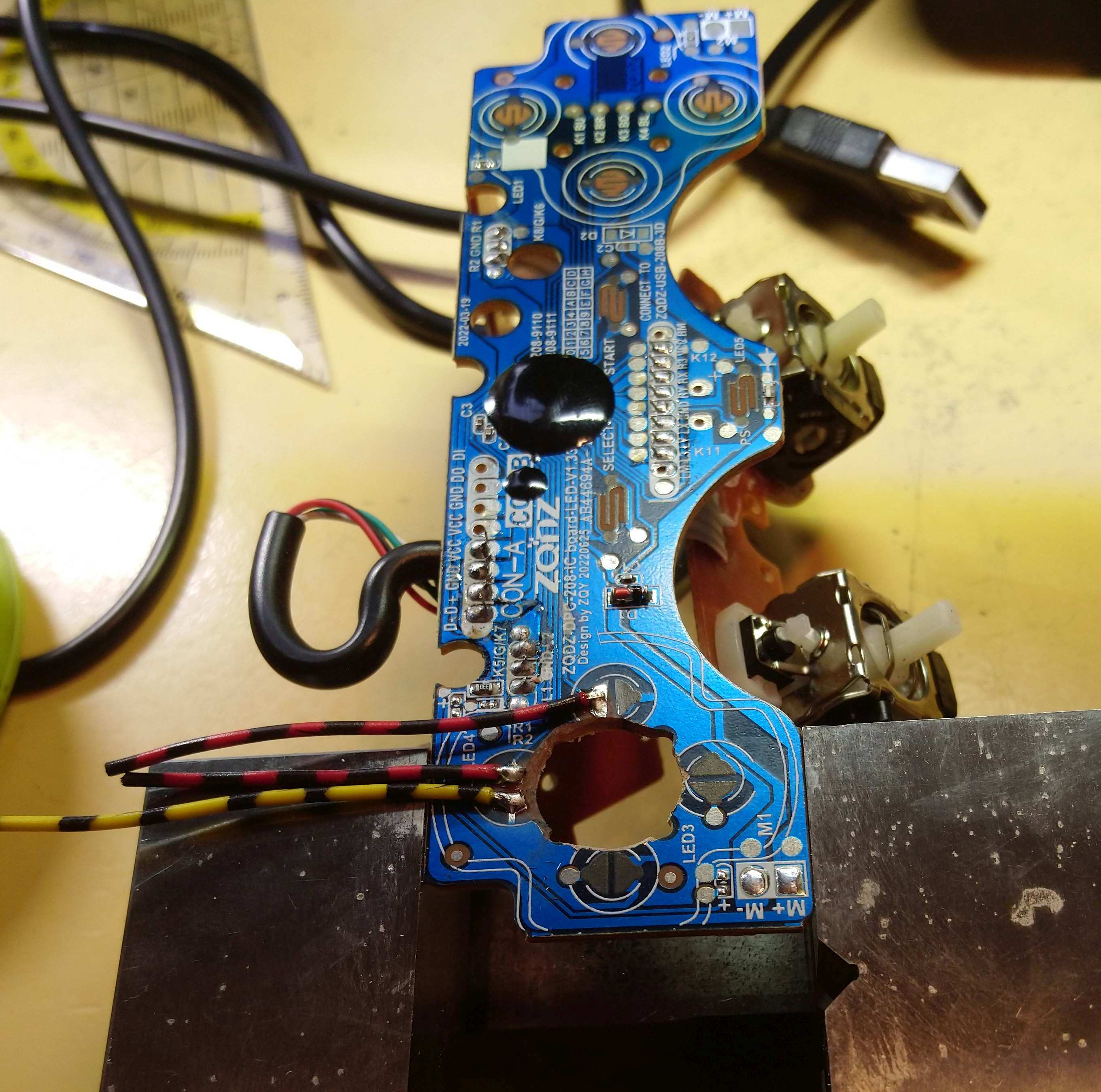

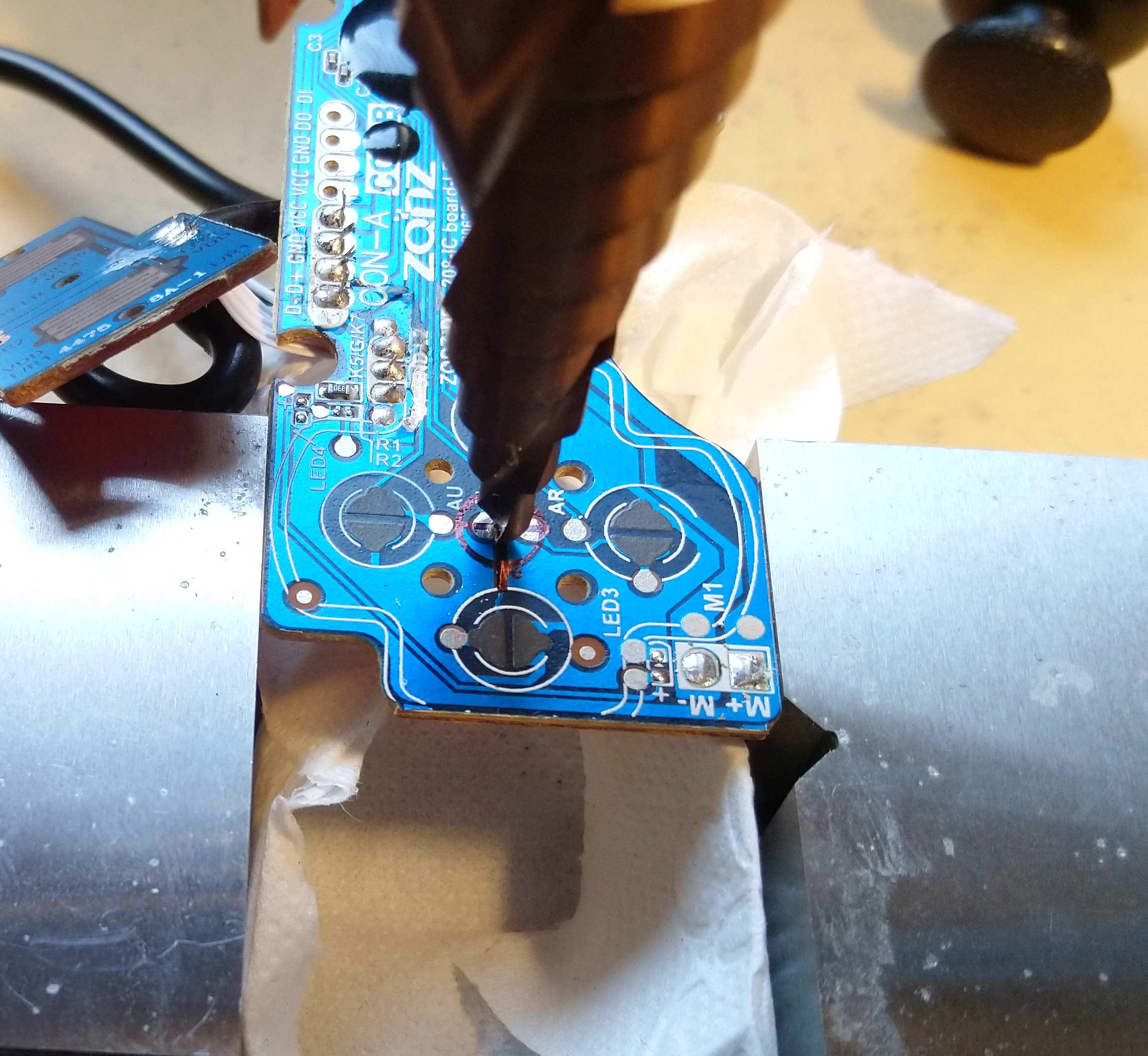

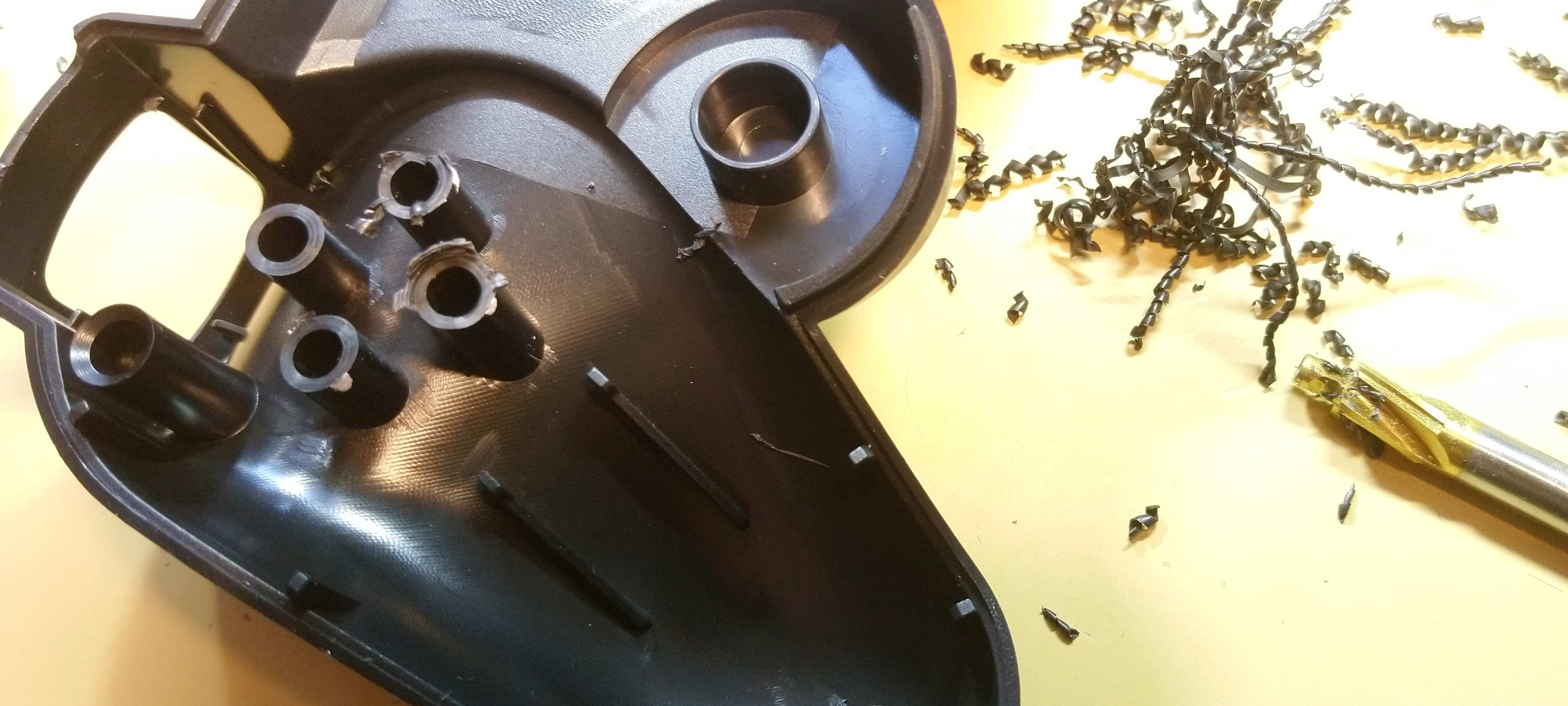

hal file for gamepad pendant with retrofitted 12-position selector switch
17 Oct 2025 11:05 #336607 by juergen-home
hal file for gamepad with retrofitted 12-position selector switch
# use special version of toggle2nist:  www.forum.linuxcnc.org/24-hal-components...ton-at-the-same-time
# ALPS encoder EC18AGA20402
# Simple gamepad as a pendant
# Jogging (axes): Buttons 1–4, 11–12 control X, Y, Z motion (+/−).
# Feed Controls: Buttons 9, 10 adjust program feed override +1 / -1.
# Feed Controls: Encoder: inputs (6, 8) (17, 19) adjust program feed override in predefined steps
# Program Control: Buttons 13–16 manage stop, pause, start, and mist-coolant.
# Mode Selection: Encoder: inputs (6, 8) (17, 19) set jog/increment steps via `mux16` and `lut5` for maual jog.
# ttm_a for linuxcnc 2.9.6 AXIS GUI 2025-10-17 encoder 16
# use special version of toggle2nist: forum.linuxcnc post 05 Oct 2025 18:50 #335873 special  toggle2nist.comp with "pulse-length" mode from Aciera
# https://www.forum.linuxcnc.org/24-hal-components/57307-toggle2nist-hangs-when-pressing-an-other-button-at-the-same-time
# https://www.forum.linuxcnc.org/media/kunena/attachments/25994/toggle2nist.comp
# sudo halcompile --install toggle2nist.comp

loadusr -W hal_input -KRAL USB Gamepad

# Gamepad USB:
# 01 input.0.btn-trigger        1                        y+ direction
# 02 input.0.btn-thumb            2                        x+ direction
# 03 input.0.btn-thumb2            3                        y- direction
# 04 input.0.btn-top            4                        x- direction
# 05 input.0.abs-hat0y-is-pos    left-cross top                                not usable (only 2 out of 4 at the same time)
# 06 input.0.abs-hat0x-is-pos    left-cross right        incr1 mux16/lut5
# 07 input.0.abs-hat0x-is-neg    left-cross left                                not usable (only 2 out of 4 at the same time)
# 08 input.0.abs-hat0y-is-neg    left-cross bottom        incr3 mux16/lut5
# 09 input.0.btn-base            left2                    feed 1% -
# 10 input.0.btn-top2            left1                    feed 1% +
# 11 input.0.btn-base2            right2                    z- direction
# 12 input.0.btn-pinkie            right1                    z+ direction
# 13 input.0.btn-base5            button left (3d-print)    E-Stop
# 14 input.0.btn-base6            button right (3d-print)    pause
# 15 input.0.btn-base3            select                    toggle coolant-mist
# 16 input.0.btn-base4            start                    start/home all
# 17 input.0.abs-x-is-neg        joystick left hand        incr0    mux16/lut5
# 18 input.0.abs-x-is-pos        joystick left hand                            not usable (poti swich to +)
# 19 input.0.abs-y-is-neg        joystick left hand        incr2    mux16/lut5
# 20 input.0.abs-y-is-pos        joystick left hand                            not usable (poti swich to +)
# 21 input.0.abs-rz-is-neg        joystick right hand        analog-on
# 22 input.0.abs-rz-is-pos        joystick right hand                            not usable (poti swich to +)
# 23 input.0.abs-z-is-neg        joystick right hand        free
# 24 input.0.abs-z-is-pos        joystick right hand                            not usable (poti swich to +)

# selection of incremental / jog  values with (mux16)
# we use a 4 bit 12 position encoder here
loadrt mux16 names=mux_encoder # for 16 different incremental steps
addf mux_encoder servo-thread     # add to the servo-thread so it can be used
#mux16.N.use-graycode bit in
#This signifies the input will use Gray code instead of binary. Gray code is a good choice when using physical switches because for each increment only one select input changes at a time.
#not used yet
# Define the gamepad inputs for selection of incremental / jog  values
# alps    gamepad                        net
# 2        input.0.abs-hat0x-is-pos    incr1
# 4        input.0.abs-hat0y-is-neg    incr3
# 5        COM
# 3        input.0.abs-y-is-neg        incr2
# 1        input.0.abs-x-is-neg        incr0
# buttons for the encoder
net incr0 input.0.abs-x-is-neg
net incr1 input.0.abs-hat0x-is-pos
net incr2 input.0.abs-y-is-neg
net incr3 input.0.abs-hat0y-is-neg
# connect the buttons with the multiplexer
net incr0 mux_encoder.sel0
net incr1 mux_encoder.sel1
net incr2 mux_encoder.sel2
net incr3 mux_encoder.sel3
# Set the 12 incremental step and jog values for the mux16 component
setp mux_encoder.in00 0            # off            0
setp mux_encoder.in01 0.01        # Increment        1
setp mux_encoder.in03 0.05        # Increment        2
setp mux_encoder.in02 0.1        # Increment     3
setp mux_encoder.in06 1            # Increment        4
setp mux_encoder.in07 10        # Jog            5
setp mux_encoder.in05 50        # Jog             6
setp mux_encoder.in04 100        # Jog             7
setp mux_encoder.in12 200        # Jog            8
setp mux_encoder.in13 500        # Jog            9
setp mux_encoder.in09 1000        # Jog            10
setp mux_encoder.in08 3000        # Jog            11
setp mux_encoder.in11 0            # Jog            # not used
setp mux_encoder.in10 0            # Jog            # not used
setp mux_encoder.in14 0            # Jog            # not used
setp mux_encoder.in15 0            # Jog            # not used
#---- if you want to use mux16grey code instead use this example:
# Set the 12 incremental step and jog values for the mux16 component use grey code
#setp mux_encoder.use-graycode 1
#setp mux_encoder.in00 0        # off            0
#setp mux_encoder.in01 0.01        # Increment        1
#setp mux_encoder.in02 0.05        # Increment        2
#setp mux_encoder.in03 0.1        # Increment     3
#setp mux_encoder.in04 1        # Increment        4
#setp mux_encoder.in05 10        # Jog            5
#setp mux_encoder.in06 50        # Jog             6
#setp mux_encoder.in07 100        # Jog             7
#setp mux_encoder.in08 200        # Jog            8
#setp mux_encoder.in09 500        # Jog            9
#setp mux_encoder.in10 0        # Jog            # not used
#setp mux_encoder.in11 0        # Jog            # not used
#setp mux_encoder.in12 0        # Jog            # not used
#setp mux_encoder.in13 0        # Jog            # not used
#setp mux_encoder.in14 1000        # Jog            10
#setp mux_encoder.in15 3000        # Jog            11
# 4-Bit-
# Gray-Code
# 4321    16pos    Switch position ALPS
# 0000    1        1
# 0001    2        2
# 0011    3        3
# 0010    4        4
# 0110    5        5
# 0111    6        6
# 0101    7        7
# 0100    8        8
# 1100    9        9
# 1101    10        10
# 1111    11
# 1110    12
# 1010    13
# 1011    14
# 1001    15        11
# 1000    16        12
net net-mux-encoder-out mux_encoder.out-f            # the actual increment value
net net-mux-encoder-out => halui.axis.x.increment     # the actual increment value to the axis
net net-mux-encoder-out => halui.axis.y.increment  # the actual increment value to the axis
net net-mux-encoder-out => halui.axis.z.increment  # the actual increment value to the axis
# alps    gamepad                        net
# 5        COM
# this is already done in the mux_encoder section
#net incr0 input.0.abs-x-is-neg
#net incr1 input.0.abs-hat0x-is-pos
#net incr2 input.0.abs-y-is-neg
#net incr3 input.0.abs-hat0y-is-neg
net incr0 mux16_rapid-override.sel0
net incr1 mux16_rapid-override.sel1
net incr2 mux16_rapid-override.sel2
net incr3 mux16_rapid-override.sel3
# Set the values for the mux16 component rapid-override
# this values are smaller in the low percentage range to reduce the high rapid moves to a save level
setp mux16_rapid-override.in00 0            #    0        0%
setp mux16_rapid-override.in01 1            #    1        1%
setp mux16_rapid-override.in03 3            #    2        3%
setp mux16_rapid-override.in02 10            #      3        10%
setp mux16_rapid-override.in06 50            #    4        50%
setp mux16_rapid-override.in07 1000            #    5        100%
setp mux16_rapid-override.in05 0            #    6        0%
setp mux16_rapid-override.in04 0            #    7
setp mux16_rapid-override.in12 0            #    8
setp mux16_rapid-override.in13 0            #    9
setp mux16_rapid-override.in09 0            #    10
setp mux16_rapid-override.in08 0            #    11
setp mux16_rapid-override.in11 0            #    # not used
setp mux16_rapid-override.in10 0            #    # not used
setp mux16_rapid-override.in14 0            #    # not used
setp mux16_rapid-override.in15 0            #    # not used
# Override with max-velocity example
#setp halui.max-velocity.scale 0.01666666666 # divider for m/min values
#setp halui.max-velocity.direct-value 1 # use absolute velocity values
#net net-max-vel vel_encoder.out-s => halui.max-velocity.counts # use selected mux16 value
# we override with Feed Override + Rapid Override / 2 different mux16 for 2 different value selection
#halui.feed-override.direct-value bit in
setp halui.feed-override.direct-value 1        # uses the direct value, not a percentage
# halui.feed-override.scale float in
setp halui.feed-override.scale 0.01
#halui.feed-override.counts s32 in
net net-feed-override mux16_feed-override.out-s => halui.feed-override.counts # use selected mux16 value
#halui.feed-override.value float out
net net-feed-override.value <= halui.feed-override.value
# halui.rapid-override.direct-value bit in
setp halui.rapid-override.direct-value 1
# halui.rapid-override.scale float in
setp halui.rapid-override.scale 0.001        # scale 0.001 for finer granulation
# halui.rapid-override.counts s32 in
net net-rapid-override mux16_rapid-override.out-s => halui.rapid-override.counts # use selected mux16 value
#halui.rapid-override.value float out
net net-rapid-override.value <= halui.rapid-override.value
#--feed control end ---------------------------------
# --- detect if program is running or paused to prevent error messages when incidentally press buttons for jogging
# so jogging/ incremental-jogging is only commanded when no program is running or paused
# halui.program.is-running
# halui.program.is-paused
loadrt or2 names=or2-programm-is-on
addf or2-programm-is-on servo-thread
loadrt not names=not_on   # Load N components for logical NOT operations
addf not_on servo-thread
net net-program.is-running or2-programm-is-on.in0 <= halui.program.is-running    # program is running
net net-halui-program-is-paused or2-programm-is-on.in1                    # program is paused
net net-programm-is-on or2-programm-is-on.out                            # program is running or paused
net net-programm-is-on not_on.in                                        # program is running or paused
net net-programm-is-on-not <= not_on.out                                # program is not running or paused
#net net-programm-is-on-not <= halui.program.is-idle
loadrt and2 names=and_prog-0,and_prog-2,and_prog-4,and_prog-6,and_prog-8,and_prog-10 #Load AND components for logical AND operations
addf and_prog-0 servo-thread     #(for x+)
addf and_prog-2 servo-thread
addf and_prog-4 servo-thread
addf and_prog-6 servo-thread
addf and_prog-8 servo-thread
addf and_prog-10 servo-thread    #(for z-)
net net-programm-is-on-not and_prog-0.in0    # program is running or paused    (for x+)
net net-programm-is-on-not and_prog-2.in0    # program is running or paused
net net-programm-is-on-not and_prog-4.in0    # program is running or paused
net net-programm-is-on-not and_prog-6.in0    # program is running or paused
net net-programm-is-on-not and_prog-8.in0    # program is running or paused
net net-programm-is-on-not and_prog-10.in0    # program is running or paused    (for z-)
# jog/jog-incremental the axis
loadrt and2 names=and_incr_0,and_incr_1,and_incr_2,and_incr_3,and_incr_4,and_incr_5,and_incr_6,and_incr_7,and_incr_8,and_incr_9,and_incr_10,and_incr_11  # Load AND components for logical AND operations
addf and_incr_0 servo-thread
addf and_incr_1 servo-thread
addf and_incr_2 servo-thread
addf and_incr_3 servo-thread
addf and_incr_4 servo-thread
addf and_incr_5 servo-thread
addf and_incr_6 servo-thread
addf and_incr_7 servo-thread
addf and_incr_8 servo-thread
addf and_incr_9 servo-thread
addf and_incr_10 servo-thread
addf and_incr_11 servo-thread
#++++ program is on
#       halui.program.is-running----|OR
#                                      |OR─----net-programm-is-on ---|NOT---net-programm-is-on-not
#    net-halui-program-is-paused----|OR
#      net-programm-is-on-not──|AND
#                             |AND──input-0-btn-thumb
#      input.0.btn-thumb───    |AND
#++++ X plus jog
#      input-0-btn-thumb─|AND
#                     |AND──halui.axis.x.plus
#      net-jog-true───|AND
#++++ X plus incremental
# input.0.btn-thumb───|AND
#                     |AND──halui.axis.x.increment-plus
#     net-incr-true───|AND
# old version
#++++ X plus jog
#net net-x-plus-jog input.0.btn-thumb                         # button pressed input
#net net-x-plus-jog and_incr_0.in0                            # if button is pressed
#net net-jog-true and_incr_0.in1                                # and lut5_jog is true
#net net-x-plus-jog-out halui.axis.x.plus <= and_incr_0.out     # then jog axis
#net net-x-plus-jog and_incr_1.in0                                            # if button is pressed
#net net-incr-true and_incr_1.in1                                            # and lut5_incr is true
#net net-x-plus-incr-jog-out halui.axis.x.increment-plus <= and_incr_1.out     # then jog-incremental axis
#++++ X plus jog
net net-programm-is-on-not1 and_prog-0.in1 input.0.btn-thumb     # program is running or paused and button is pressed
net net-x-plus-jog and_prog-0.out                                 #
#++++ X minus jog
net net-programm-is-on-not2 and_prog-2.in1 input.0.btn-top
net net-x-minus-jog  and_prog-2.out                            # button pressed input
net net-x-minus-jog and_incr_2.in0                                # if button is pressed
net net-jog-true and_incr_2.in1                                    # and lut5_jog is true
net net-x-minus-jog-out halui.axis.x.minus <= and_incr_2.out     # then jog axis
#++++ X minus incremental
net net-x-minus-jog and_incr_3.in0                                            # if button is pressed
net net-incr-true and_incr_3.in1                                            # and lut5_incr is true
net net-x-minus-incr-jog-out halui.axis.x.increment-minus <= and_incr_3.out # then jog-incremental axis
#++++ Y plus jog
net net-programm-is-on-not4 and_prog-4.in1 input.0.btn-trigger
net net-y-plus-jog  and_prog-4.out                        # button pressed input
net net-y-plus-jog and_incr_4.in0                            # if button is pressed
net net-jog-true and_incr_4.in1                                # and lut5_jog is true
net net-y-plus-jog-out halui.axis.y.plus <= and_incr_4.out     # then jog axis
#++++ Y plus incremental
net net-y-plus-jog and_incr_5.in0                                            # if button is pressed
net net-incr-true and_incr_5.in1                                            # and lut5_incr is true
net net-y-plus-incr-jog-out halui.axis.y.increment-plus <= and_incr_5.out     # then jog-incremental axis
#++++ Y minus jog
net net-programm-is-on-not6 and_prog-6.in1 input.0.btn-thumb2
net net-y-minus-jog  and_prog-6.out                            # button pressed input
net net-y-minus-jog and_incr_6.in0                                # if button is pressed
net net-jog-true and_incr_6.in1                                    # and lut5_jog is true
net net-y-minus-jog-out halui.axis.y.minus <= and_incr_6.out     # then jog axis
#++++ Y minus incremental
net net-y-minus-jog and_incr_7.in0                                            # if button is pressed
net net-incr-true and_incr_7.in1                                            # and lut5_incr is true
net net-y-minus-incr-jog-out halui.axis.y.increment-minus <= and_incr_7.out # then jog-incremental axis
#++++ Z plus jog
net net-programm-is-on-not8 and_prog-8.in1 input.0.btn-pinkie
net net-z-plus-jog     and_prog-8.out                    # button pressed input
net net-z-plus-jog and_incr_8.in0                            # if button is pressed
net net-jog-true and_incr_8.in1                                # and lut5_jog is true
net net-z-plus-jog-out halui.axis.z.plus <= and_incr_8.out     # then jog axis
#++++ Z plus incremental
net net-z-plus-jog and_incr_9.in0                                            # if button is pressed
net net-incr-true and_incr_9.in1                                            # and lut5_incr is true
net net-z-plus-incr-jog-out halui.axis.z.increment-plus <= and_incr_9.out     # then jog-incremental axis
#++++ Z minus jog
net net-programm-is-on-not10 and_prog-10.in1 input.0.btn-base2
net net-z-minus-jog and_prog-10.out                        # button pressed input
net net-z-minus-jog and_incr_10.in0                                # if button is pressed
net net-jog-true and_incr_10.in1                                # and lut5_jog is true
net net-z-minus-jog-out halui.axis.z.minus <= and_incr_10.out     # then jog axis
#++++ Z minus incremental
net net-z-minus-jog and_incr_11.in0                                            # if button is pressed
net net-incr-true and_incr_11.in1                                            # and lut5_incr is true
net net-z-minus-incr-jog-out halui.axis.z.increment-minus <= and_incr_11.out# then jog-incremental axis
