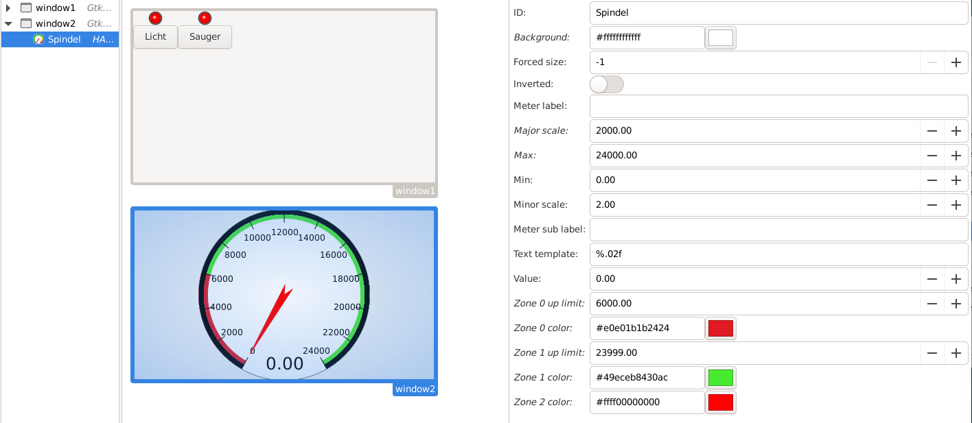

iḿ still a beginner with glade and today i wanted to add a Hal Meter in Glade that shows the spindle speed.
Things i did so far:
- I found out that i minimum require a float signal (maybe that on the picture attached?)
- i created a Hal Meter in Glade -> see attached file

net Spindelrpm => gladevcp.Spindel <= spindle.0.speed-out
Error --> custom_postgui.hal:9: Pin 'spindle.0.speed-out' was already linked to signal 'spindle-vel-cmd-rpm'
Yesterday i learned that if a signal is linked i can´t use it.... but from here i don´t know further
Please help

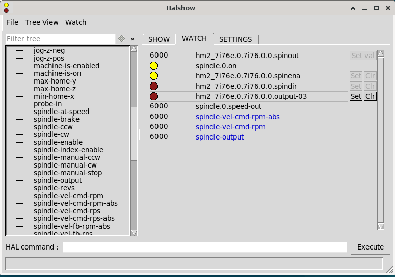

Unfortunately, I'm still stuck, even with the additional link.
My thoughts:
Where can I get the spindle speed (float)? Would that be the value “spindle.0.speed-out,” for example, which can be seen in the attachment?
How do I transfer the float value to gladevcp.Spindel?
My favorite code doesn't work.
Error "custom_postgui.hal:9: Pin 'spindle.0.speed-out' was already linked to signal 'spindle.0.speed-out'"

1 year 2 weeks ago #336495
Replied by cmorley on topic Glade Hal Meter Spindle Speed -> postgui
An output pin can only be connected to one signal, but a signal can be connected to many input pins.
You didn;t post your postgui file so can't see the actual problem to comment more.

1 year 2 weeks ago #336497
by JT
Replied by JT on topic Glade Hal Meter Spindle Speed -> postgui
In your hal file you have
So the signal spindle-vel-cmd-rpm can be connected to your rpm meter or you can comment out the line that pncconf made.
JT
Code:
net spindle-vel-cmd-rpm <= spindle.0.speed-out

1 year 2 weeks ago #336498
Replied by Aciera on topic Glade Hal Meter Spindle Speed -> postgui
Difficult without seeing all your hal files so we really don't know what halpins is connected to what signal name but this:
tells you that you have a line somewhere like this:
this will create a SIGNAL named 'spindle.0.speed-out ' to which you have connected the HALPIN named 'spindle.0.speed-out'
So you would need to change this:
to this
Note though that using halpin names for signal names is likely to create confusion.
nked -> Error "custom_postgui.hal:9: Pin 'spindle.0.speed-out' was already linked to signal 'spindle.0.speed-out'"
Code:
net spindle.0.speed-out .... spindle.0.speed-out ...
Code:
Code:
net spindle.0.speed-out => gladevcp.Spindel

1 year 2 weeks ago - 1 year 2 weeks ago #336544
by DerKlotz
Replied by DerKlotz on topic Glade Hal Meter Spindle Speed -> postgui
Thatś it. Thanks
My custum_postgui.hat is now correct
#[Spindel]
net spindle-vel-cmd-rpm => gladevcp.Spindel1
I guess i really have some problems with reading signals in the machine.hal. I thought in my case "spindle.0.speed-out" give me directly my float value. Have to write a small manual for me.
