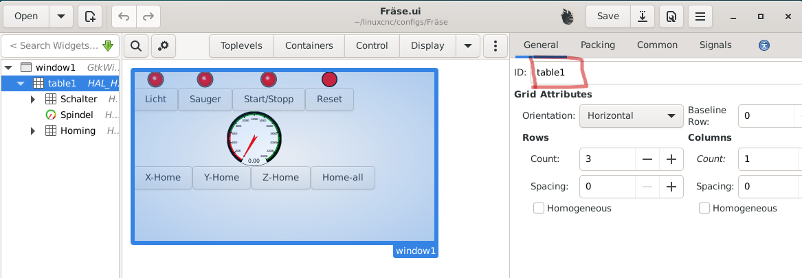

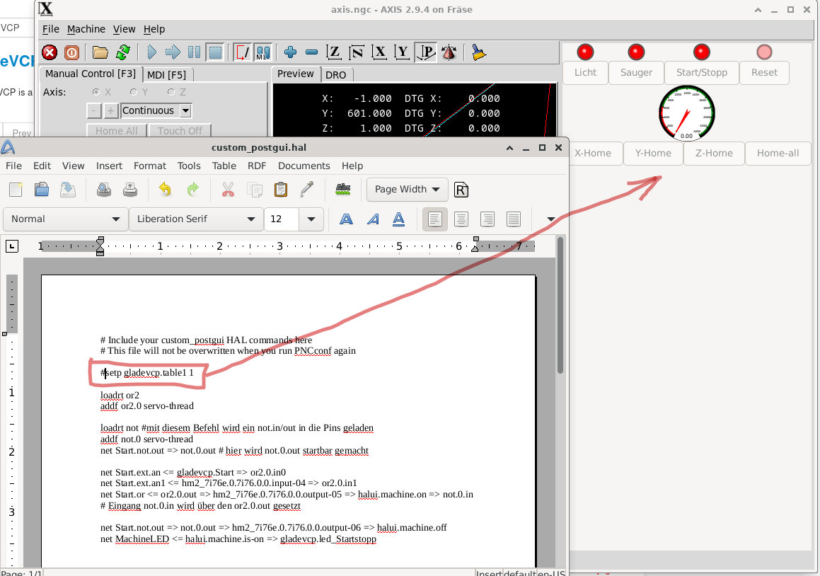

i try to activate some glade functions. Therefore i use "gladevcp.table1 1" in my custom_postgui.hal.
In the attached file i deactivated "gladevcp.table1 1". Then you can see the light grey button/leds but you can´t use them. If activated you just see a blank site.

1. usually a good idea to post the files
2. start your config from a terminal ($ linuxcnc) and check output for clues
3. I would recommend using a simple texteditor to edit the files not a word processor like the one in your screen shot.

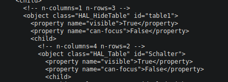

Looking at your .ui file it seems that you have a 'HAL_Table' inside a 'HAL_HideTable' object:
Which would explain why this would make your panel disappear (because it is actually controlling the 'HAL_HideTable' object):
And also why commenting it out,
Shows an inactive panel because 'HAL_Table' (with id=schalter)) is not set True by any signal.
Code:
setp gladevcp.table1 1
Code:
#setp gladevcp.table1 1
