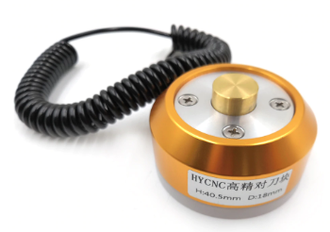

Ondrej wrote:
> When I run the Z- code ( which is for down.ngc code ) I get and error - Probe tripped during non-probe move.
I have one of these poorly designed "plunger" type height setters.[1] I have taken it apart multiple times alternately to add "dielectric grease" to improve the electrical connectivity between the plunger and the spring and the walls and to remove excess grease slowing the return of the button to the rest position.
Others who have purchased this have reported modifying it to drill and tap holes to secure a copper wire between the bottom of the brass plunger and the aluminum base.
After cleaning, mine will function for a time, but I have found it to be erratic: sometimes it won't trigger on contact, and other times it triggers (from vibration I think) when jogging or running G-code. I've taken the electrical connector apart and re-wet the solder joints, and to avoid having to unscrew the connector between uses, I went ahead and installed a rocker switch in one of the conductor lines to ensure it cannot false-trigger. It can however still fail to trigger when in-use, thanks to the poor design.
I am in the market for a good MECHANICAL height setter--with a dial, not digital display.
[1] In fact, the Chinese appear to have stopped making this format because it took an extensive search to find it even on a Chinese site. None found on ebay or amazon where they used to be rife.
