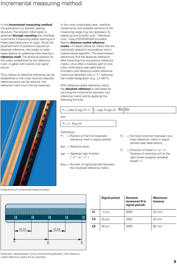

Hi!
Is it possible to home a machine only using the scales and no other limit switches? Have found a bunch of posts regarding this, but none gave me enough clarity. In one i think Andypugh did some testing/developing to get this to work?
/Hampus
/Hampus

17 May 2025 20:27 #328655
Replied by PCW on topic Index homing Heidenhain ls 403/exe602
It should be possible if there is only one index
rather than periodic index marks
If you scale has periodic index marks you need to coarsely position
the axis before the final home to index (this is usually done with a home switch
but could be done by jogging to a mark and then homing to index)
Raw counts will be set to 0 when LinuxCNC starts so its still
just a relative count number.
What is the spacing between index marks on your scale?

22 May 2025 05:32 - 22 May 2025 05:37 #328892
by H-S-W
Replied by H-S-W on topic Index homing Heidenhain LS 403 C /exe602
Last edit: 22 May 2025 05:37 by H-S-W.
