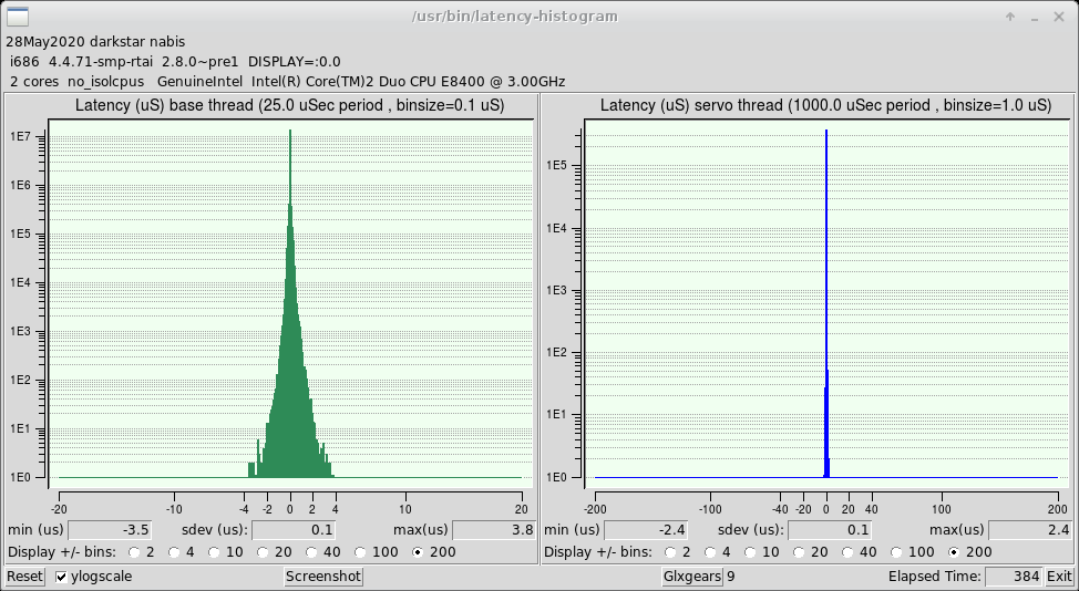

OK, got it. But how do I download it? sources.debian.org/src/blt/

Have you tried the build scripts from SlackBuilds.org ? The latest version they have use is 2.5.3
Usuaully Alien Bob has some good scripts as well.
Or you can open a deb package as an archive with midnight commander and extract the binaries, but then you'll need to run ldd on the binaires & libs to see what is missing. Or you can look for deb2tgz on SlackBuilds, to create a slackware package from a deb.

I managed to compile blt-2.5 (with 21 patches!). Somehow @PATCHLEVEL@ didn't get replaced with "2.5.3" in /usr/lib/blt2.5/pkgIndex.tcl, so fixed that, as well as Tcl not finding "Linuxcnc" package - fixed by linking /usr/lib/tcltk/linuxcnc to /usr/lib/tcllib1.18/linuxcnc. So the latency-histogram is up.
Still "unknown symbols" in modules when loading linuxcnc. Modules aren't related to Tcl/Tk, so I was expecting that.
Well, that's about how much fun I can afford myself for the moment. I might give it one more shot in the future. Maybe with some patched versions of RTAI (github.com/SebKuzminsky/rtai). But I need Slackware 14.0-14.1, and not -current for that.
Thank you for your patience.
