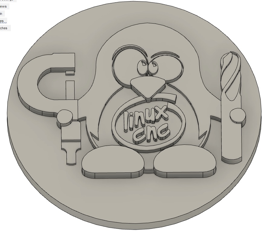

You can always use a 1/8 V bit for that type of work, not the same thing but the end result is close enough.

+1 vbit
it will provide a better finish , the features will be supported and you won't have thin walls
26 Feb 2021 01:20 #200164
I rarely go below 2.5mm, but I have a 1000rpm spindle.
Try a feeds and speeds calculator and see what looks reasonable for your spindle speed.
I imagine that a sloppy machine might break very small bits, But otherwise there is no reason to worry.
This chap thread-mills m2 holes on a full-size industrial mill: www.f1-2000.co.uk/index.php?f=conrods
I suspect the real limit is how long you are prepared to wait to nibble away the material.

I'm relatively new at CNC so I'm always nervous about breaking bits. For MDF or pine how small a bit would you recommended running?
