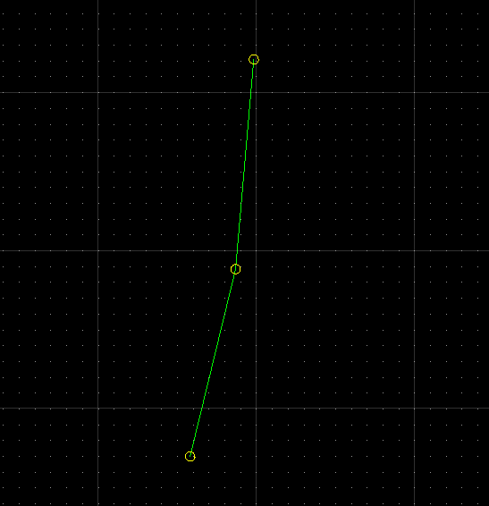

- jtc
- Posts: 147
- Thank you received: 12
24 Feb 2022 18:42 - 24 Feb 2022 18:44 #235736
by jtc
Replied by jtc on topic Creating DXF's from probing points
Some years ago I create a simple program that import a log file and create a dxf file where the log points are circles connected by lines.
It turned to be very useful various times.
MDI comands, by order:
python program:
João
(LOGOPEN,filename.txt)
(log,#<_x> ,#<_y> )
(logclose)python program:
import csv
import sys
import ezdxf
f = open('filename.txt', 'rt')
try:
teste= list(csv.reader(f))
drawing = ezdxf.new(dxfversion='AC1024')
modelspace = drawing.modelspace()
drawing.layers.new('circle', dxfattribs={'color': 2})
drawing.layers.new('line', dxfattribs={'color': 3})
# print (teste[0],teste[1])
i=0
for point in range(0,len(teste)-1):
modelspace.add_line(teste[i],teste[i+1],dxfattribs={ 'layer': 'line'})
i=i+1
for point in range(0,len(teste)):
modelspace.add_circle(teste[point],3,dxfattribs={ 'layer': 'circle'})
finally:
f.close()
drawing.saveas('log2dxf.dxf')João
Last edit: 24 Feb 2022 18:44 by jtc.
The following user(s) said Thank You: robertspark
