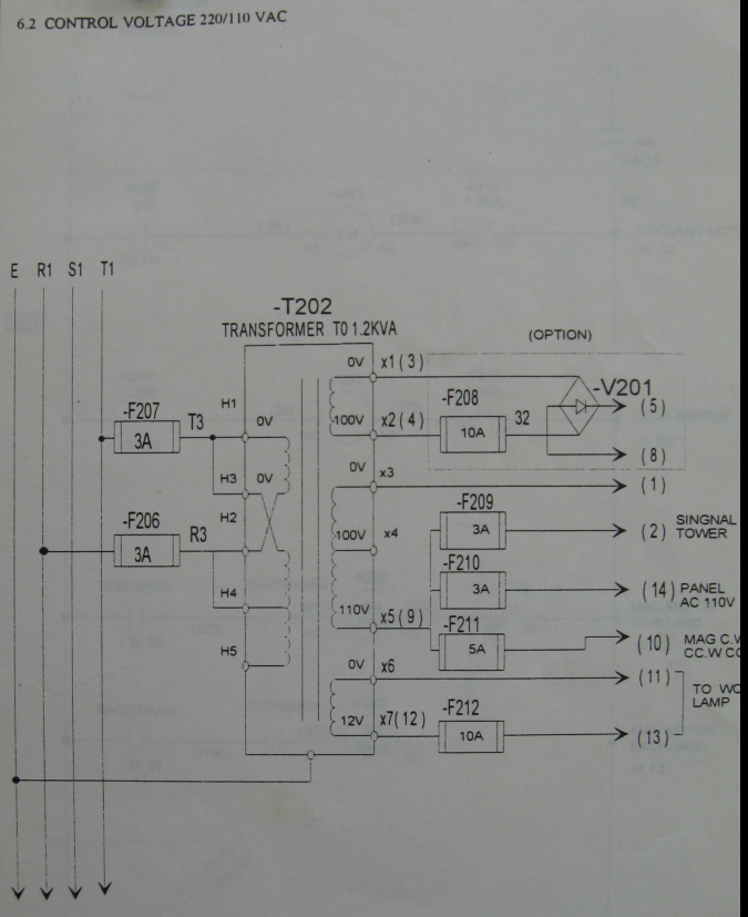

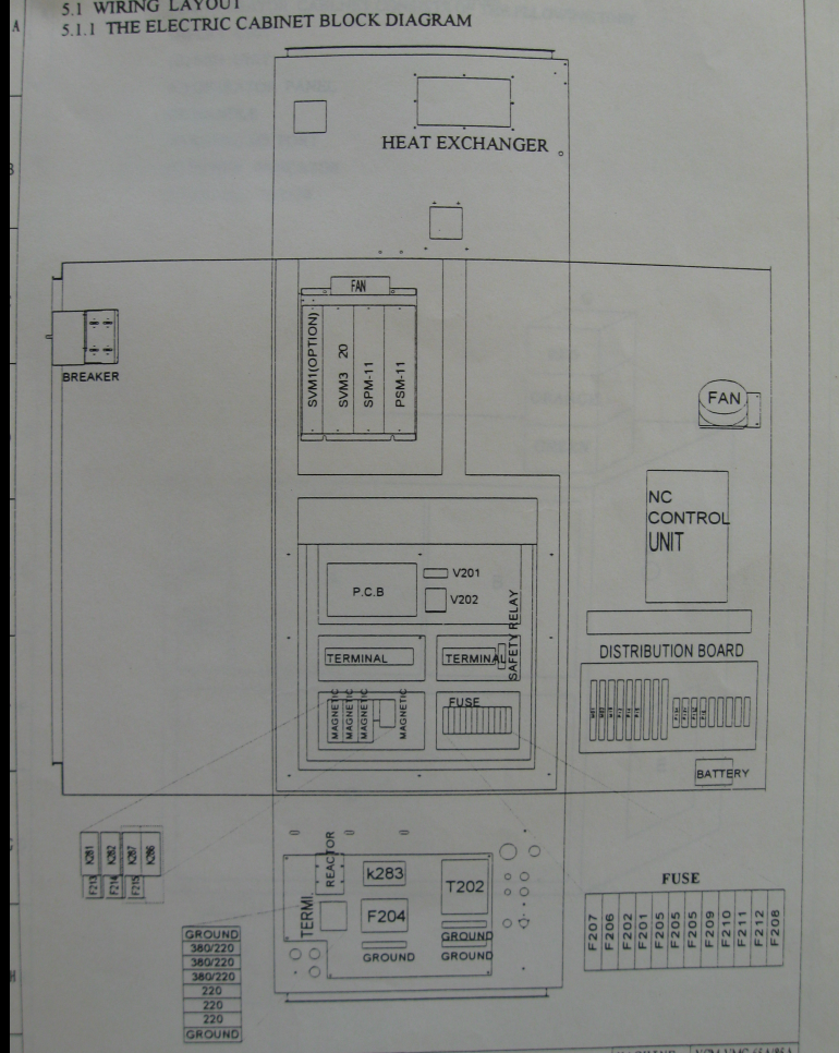

Todd, Many thanks for your thoughts. The electrical manual shows the "control voltage diagram" 110/220 VAC and where it is connected. Attached are 3 diagrams showing the T202 transformer, and where it's located.
Can I just find the wires to the spindle motor and disconnect them?
What or how would you approach this?
All suggestions warmly welcomed. Many thanks

Probably find out what w2,4,5, and 8 are, and then you might need to fool some alarms on either w12 or w3, but go inside the box and see what the part numbers are on the drives/amps, as it will shed more light on if you can/cant.
Looking at page 6.2 CONTROL VOLTAGE, at T202, I dont know what all the symbols mean, but is the transformer even hooked up to 3 phases? Looks like its only connected at T1 R1 and E, which would just be 220v single?

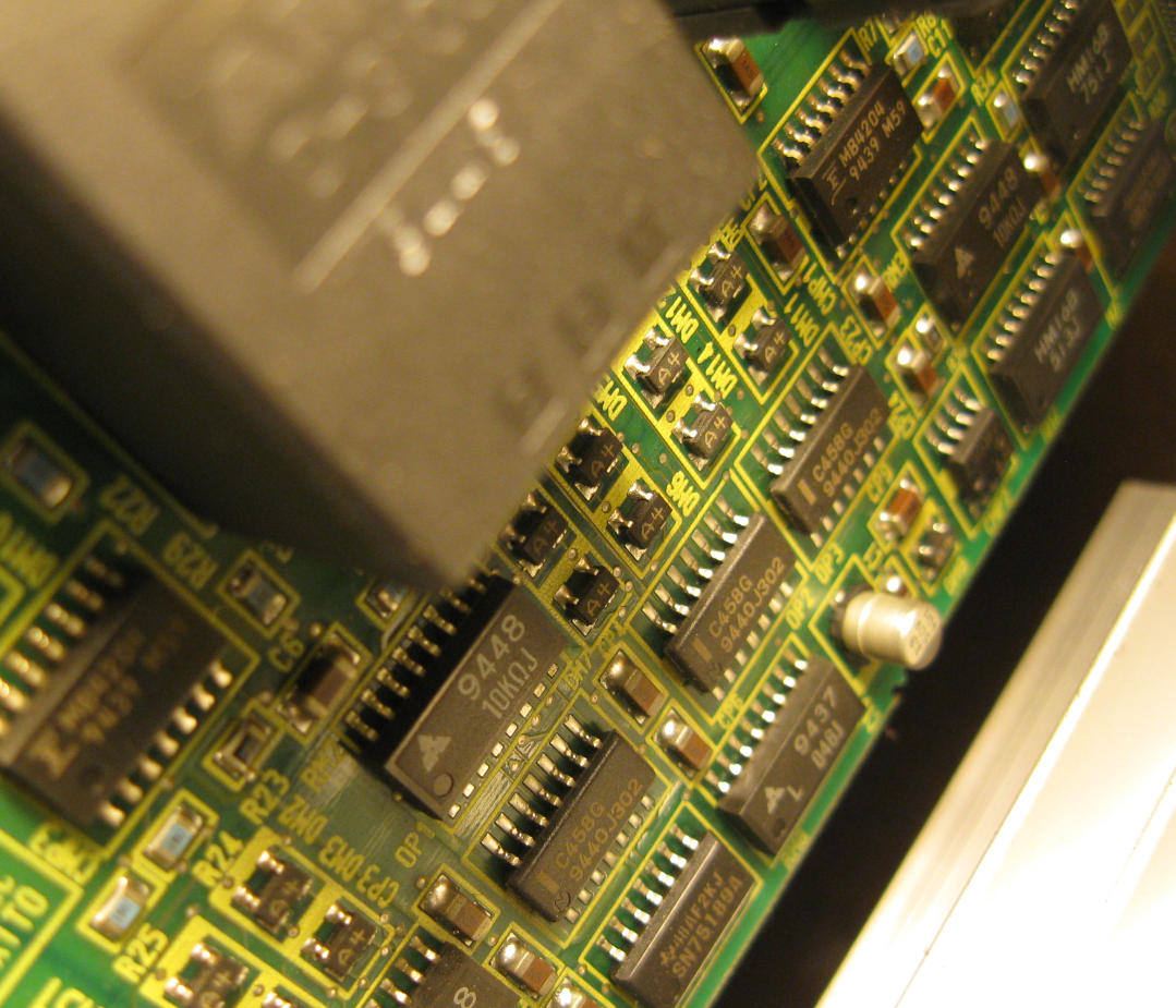

cakeslob, thank you for your suggestions!! I have (not shore, I am correct) the power supply module apart looking for "part numbers are on the drives/amps" or am I to have the servo amplifier apart looking for the "part numbers are on the drives/amps"? This pic is of the power supply, you see the components to the left & right side of the JX1B socket.
The transformer has 2 wires on the 220 volt location in the electrical cabinet.
Many thanks for your help, all suggestions are warmly welcomed.

cakeslob, thank you! These are pics from the servo amplifier module. Both of the modules are built like a sandwich, there are PCB (printed circuit board) on both sides all the components are in the middle, so on the outside are all the solder connections can't see much. This is the best pic, describe what components you need to know more about and I will get a number or better pic.Many, many thanks!!

Cordwood Construction, it's rather old-school.cakeslob, thank you! These are pics from the servo amplifier module. Both of the modules are built like a sandwich, there are PCB (printed circuit board) on both sides all the components are in the middle
