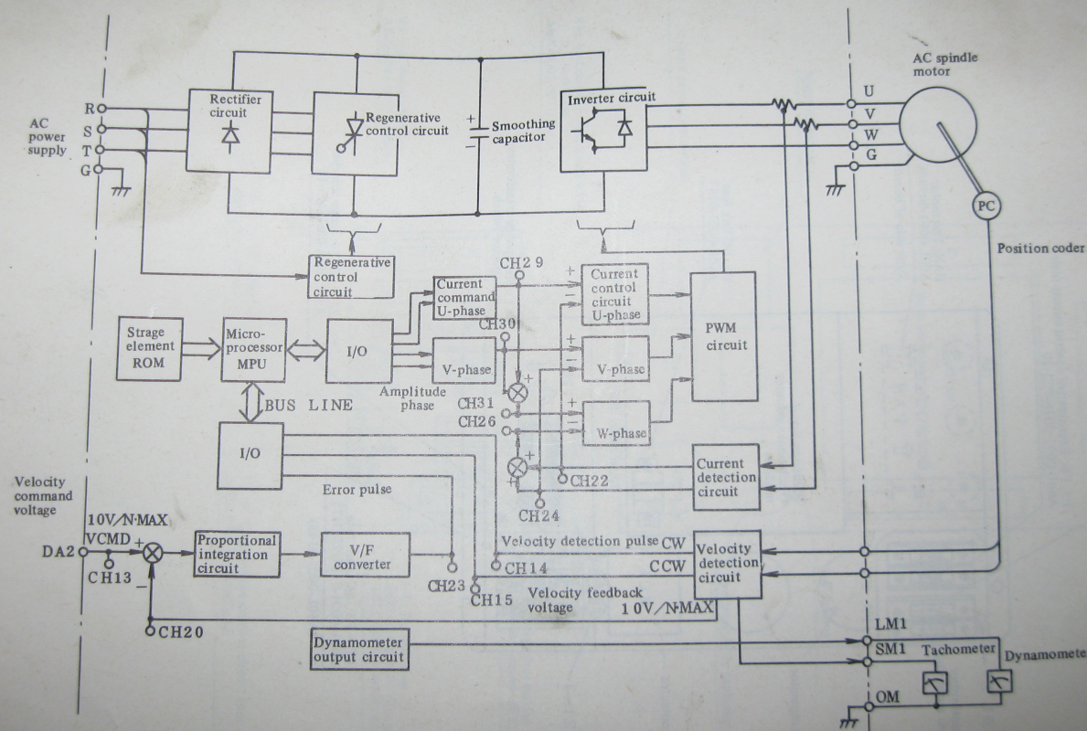

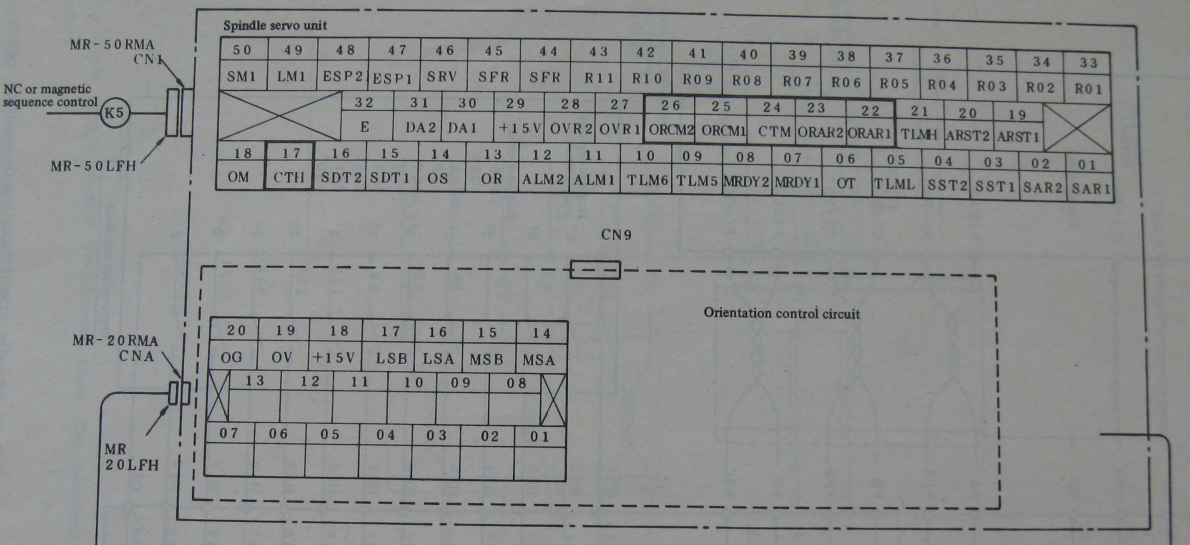

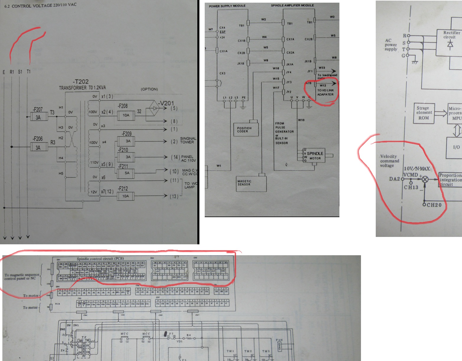

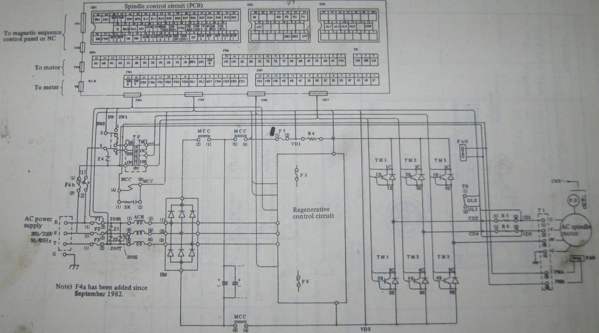

cakeslob, thank you! The diagrams in post #259641 are as detailed as they get, there is a section in the manual with "ladder logic diagram" (I think that is close to the proper name) nothing else. What I have are the 5 manuals that are factory (in yellow covers) Supermax mfg by: YCM-VMC-65N and came with the mill when new, talk about start-up & maintenance. After reviewing, I see a manual for Fanuc AC spindle servo unit (maintenance manual). It has 2 diagrams, I will try to attach them. The spindle module I have not taken any inside pic of it, all pics are of the other modules. Thank you!

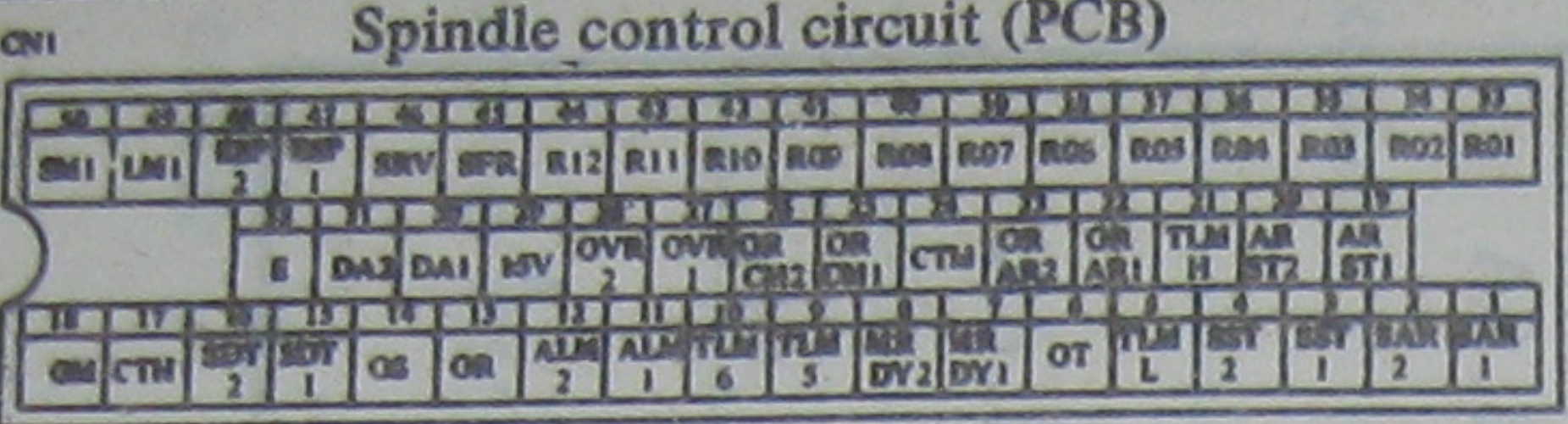

can you post a better picture of the part that says "to magnetic sequence control panel or nc"
if thats the connector pinout for the spindle drive, the alarm related pins are there. It looks like it has error feedback from the block diagram
are you gonna re-route your controller to the new highspeed spindle controller?

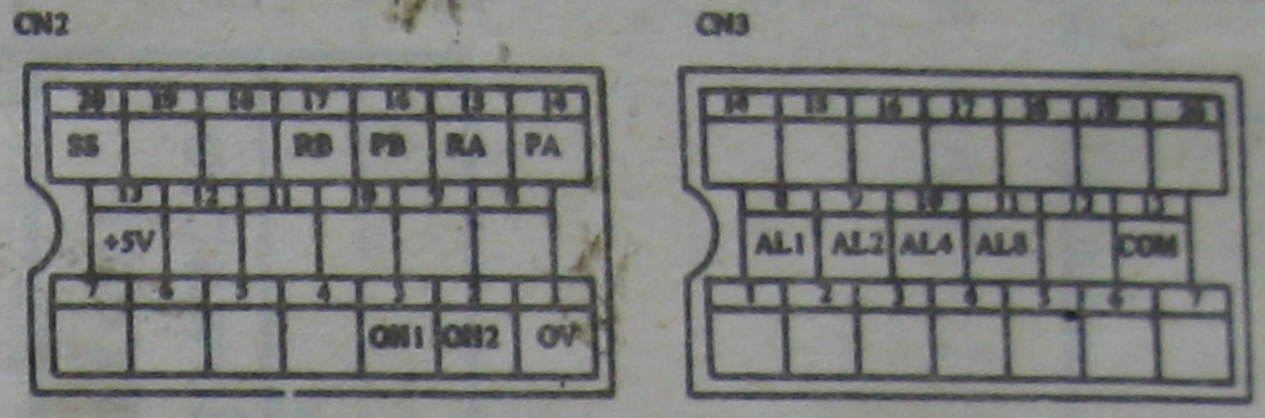

cakeslob, thanks!!
No, I do not plan to "re-route your controller to the new highspeed spindle controller".
Attached is a close up (CN1, CN2 & CN3) of the section (you see not real great original, I will give handwritten response you can't read) you asked about. Also, a pic to where that circuit goes.
