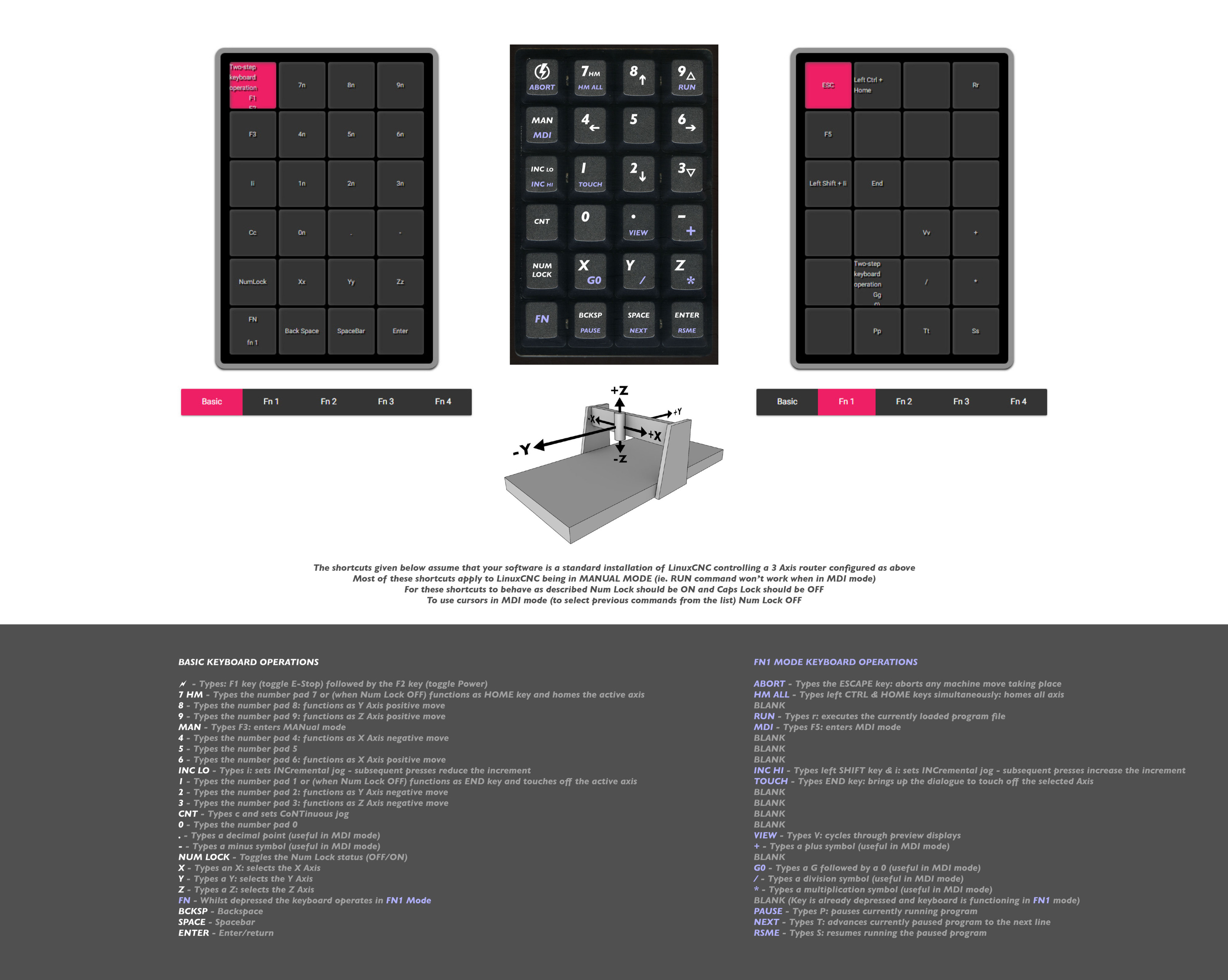

Hello all, just thought I'd share my new toy. I'll eventually get around to building my own 28 key compact keyboard, but thought I'd try out this AliExpress programmable (via a web portal) mechanical keyboard in the meantime.
www.aliexpress.com/item/1005004556641317.html
I've got it set up in the following way:
image missing http://waldemar.x10host.com/misc/KB_01.jpeg
...and when the FN1 key is depressed (bottom left) it functions like so:
image missing http://waldemar.x10host.com/misc/KB_02.jpeg
So it's a little cumbersome to begin with, but once key positions have been memorised (or keycaps uv printed onto) it's just fine - and a million times better than a pendant..!!
There's also a 24 key version available, but the way I use LinuxCNC I kinda need 28 keys to cover all I do when setting work up at the machine, which is why I'll persevere on my 28 key non-layered self-build.
Wal.

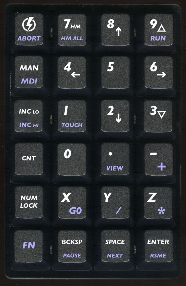

Had a play around with a 24 key version of the programmable keyboard and I think I've got it working as completely as I need it to when setting work up on the router bed:
I'll get this UV printed onto the keycaps once my local print guy comes back off his vacation. Also attached is a hi-res jpeg with details of what each key does. It's pretty straightforward, but I'm including it here for the sake of completeness.
I've intentionally left the keys around the RUN command empty to avoid any sausage fingered execution of the program BUT if I were to put an extra couple of keys in under the FN1 mode then they would be:
